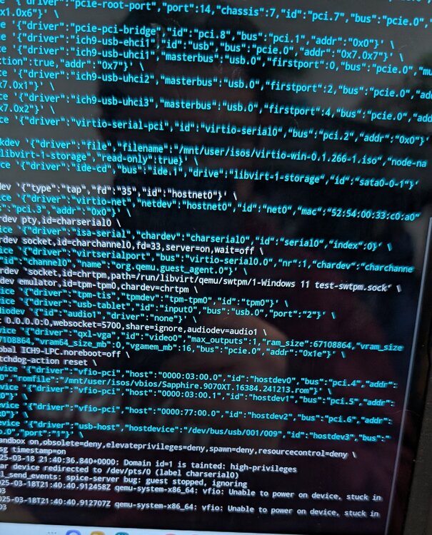

I've done this and still not working ๐ Please see attached ๐ Thank you for your help! diagnostics-20250324-0926.zip

Please see diagnostics attached Thank you for your help ๐ server-diagnostics-20250319-1315.zip

Hey everyone, Iโm trying to pass through my 9070 XT to a Windows 11 VM on UnRAID 7, but Iโm running into a ton of issues. The VM fails to start, and I get the following errors in the logs: Iโve tried a few things so far: vBIOS: Downloaded a clean vBIOS from TechPowerUp and set it in UnRAID, but the issue persists. IOMMU Groups: The GPU is in its own group, so I donโt think itโs an isolation issue. PCIe ACS Override: Enabled in "Both" mode, but still no luck. BIOS Settings: Above 4G Decoding is enabled, and I made sure another GPU is the primary display. Different PCIe Slots: Moved the GPU around, but the problem persists. Iโm wondering if this is an issue with how UnRAID is handling power states? As others have stated that they have those exact issue as well... Any suggestions would be greatly appreciated! I'm hoping it's an easy fix that either I can implement or LimeTech/Unraid or a plugin expert can implement ASAP ๐ Thanks in advance!
