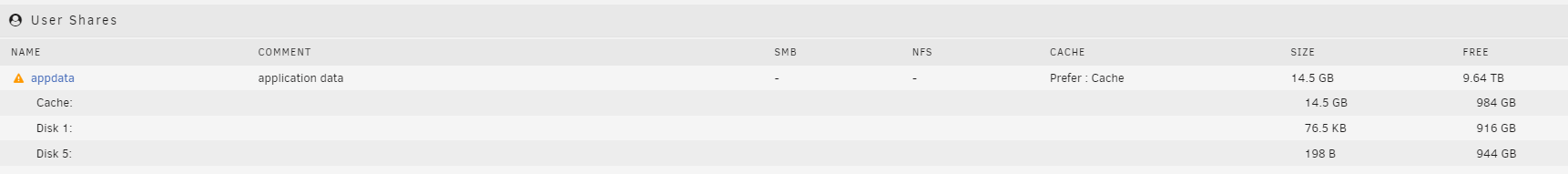

  1. I've moved all the files not on cache manually. I rebooted then turned docker back on and Boom, all my containers were back and working. Thanks for all your help JorgeB
  2. Looks like appdata have alot of symlinks including some of the files that are not moving. I couldnt find a command to list all files with hardlinks within a directory

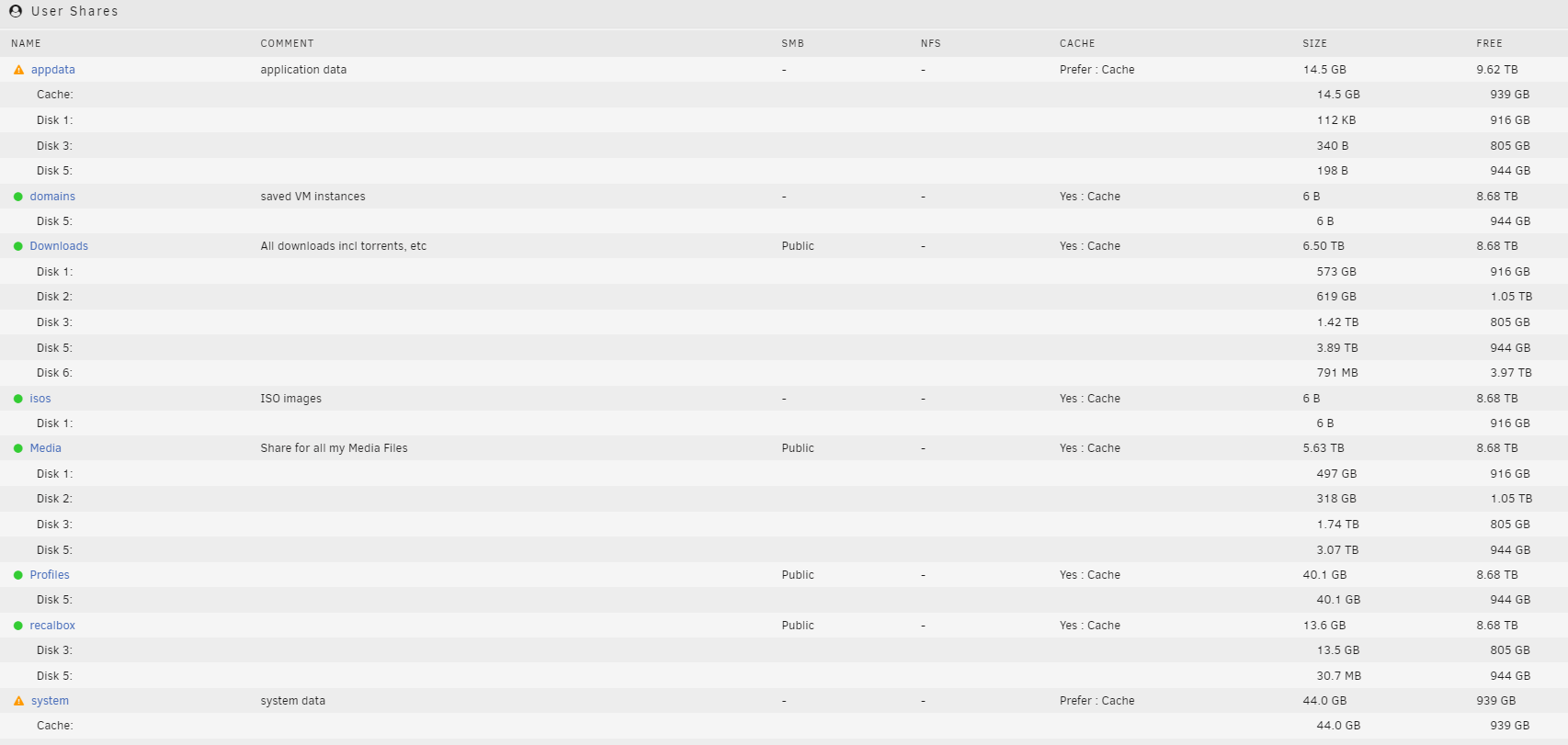

  5. I've rerun Mover with logging now enabled. New diagnostics attached The share is still showing some appdata content on array disks. but only a few bytes on 1 drive and a few KB on the other. There are a few SVG files deep in the Krusader directory, a cookie file in the QdirStat dir and a mongodb-27117.sock file under unifi controller. Could I manually move these files over manually? TBH, other than maybe the unifi controller file, the rest are not important and I can redeploy those later if needed. media-diagnostics-20221116-2020.zip

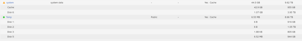

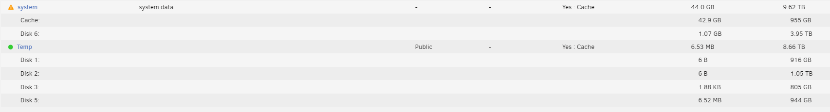

  6. I've done the same as last time, and set appdata and system shares to Cache = yes and run Mover. I've rebooted and grabbed latest diag. and here is the current shares Is an option to replace the Docker image with the one from the old Cache drive as I do still have the old smaller drive? media-diagnostics-20221115-1734.zip

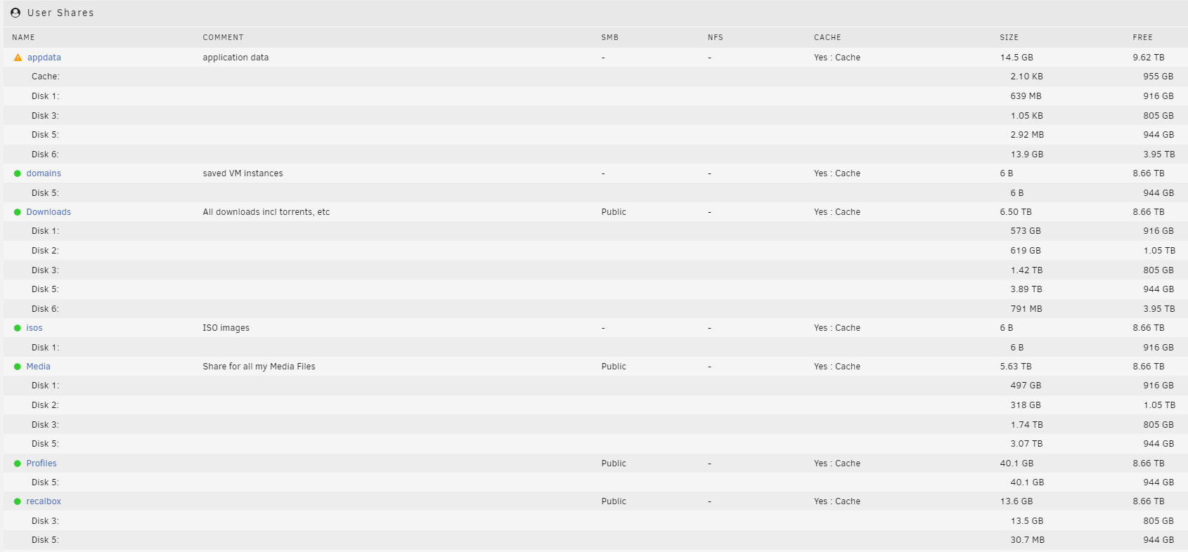

  7. Hi @JorgeB, Thanks for the continued help on this. I did change the shares to Cache Yes and Ran mover. So the logs and screenshots are after doing that change. New logs attached and screenshot as requested. media-diagnostics-20221115-0039.zip

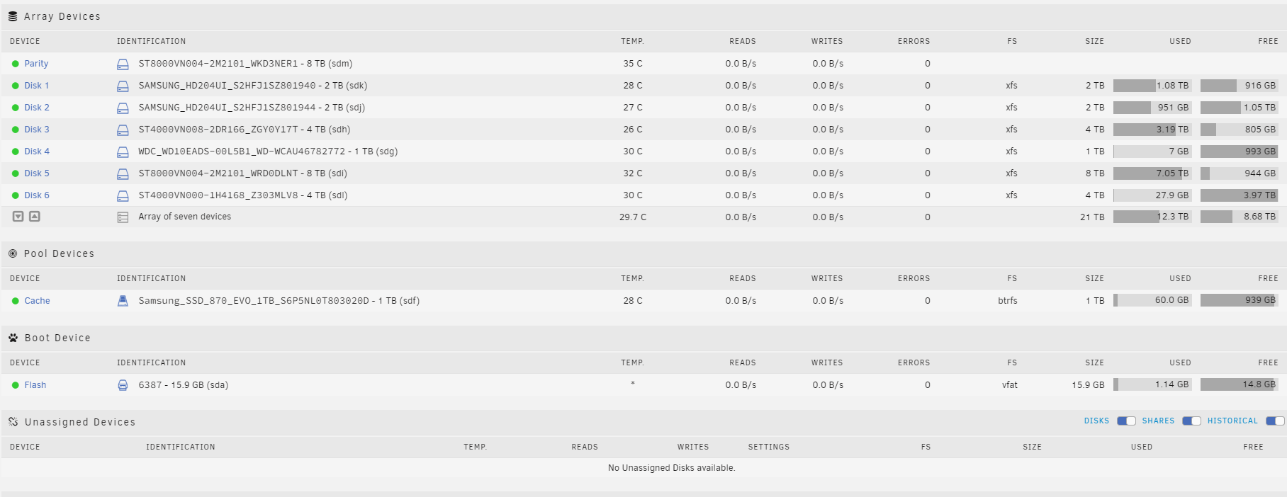

  10. Thanks for confirming. Syslog attached. Also here is my drive config as you may not see what you need from syslog syslog
