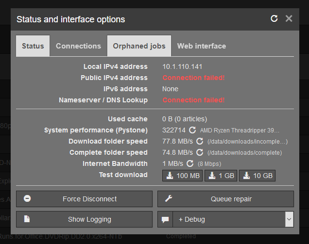

  13. Well, I thought this was fixed, but it seems to keep happening over and over. Any ideas would be great! VVVVVVVVVVVVVVVVVVVVVVVVVVVVVVVV Hello binhex!, I don't believe in free free tech support, so I sent you a donation for a few coffees. Here's my problem. binhex-sabnzbdvpn version: 3.2.0 [7be9281] I previously installed you sabvpn docker a few days ago and everything went fine and my PIA vpn was staying connected. While fiddling with privoxy (unsuccessfully), I reinstalled the docker a few times, following the normal procedure (remove docker> delete template> delete binhex-sabnzbdvpn folder in appdata). The problem now is that the "Public IPv4 address" and "Nameserver / DNS Lookup" (in the status view) are randomly giving me "Connection failed!". They do this independently and together at times when refreshing the status. My download speed goes from 32MB/s down to almost zero then back up. Any help would be appreciated! I can add my logs. Just not sure which ones to add Here's the only thing that stuck out at me, but this might be normal. Thanks 2021-03-02 22:11:59,062 DEBG 'start-script' stdout output: [info] Application does not require external IP address, skipping external IP address detection 2021-03-02 22:11:59,063 DEBG 'start-script' stdout output: [info] Application does not require port forwarding or VPN provider is != pia, skipping incoming port assignment 2021-03-02 22:11:59,062 DEBG 'start-script' stdout output: [info] Application does not require external IP address, skipping external IP address detection 2021-03-02 22:11:59,063 DEBG 'start-script' stdout output: [info] Application does not require port forwarding or VPN provider is != pia, skipping incoming port assignment
  14. Hello binhex!, I don't believe in free free tech support, so I sent you a donation for a few coffees. Here's my problem. binhex-sabnzbdvpn version: 3.2.0 [7be9281] I previously installed your sabvpn docker a few days ago and everything went fine and my PIA vpn was staying connected. While fiddling with privoxy (unsuccessfully), I reinstalled the docker a few times, following the normal procedure (remove docker> delete template> delete binhex-sabnzbdvpn folder in appdata). The problem now is that the "Public IPv4 address" and "Nameserver / DNS Lookup" (in the status view) are randomly giving me "Connection failed!". They do this independently and together at times when refreshing the status. My download speed goes from 32MB/s down to almost zero then back up. Any help would be appreciated! I can add my logs. Just not sure which ones to add Here's the only thing that stuck out at me, but this might be normal. Thanks UPDATE: The issue seems to have resolved itself. Status has been stable for around 5 hours. I'm assuming it was either a finicky DNS or an issue with PIA. 2021-03-02 22:11:59,062 DEBG 'start-script' stdout output: [info] Application does not require external IP address, skipping external IP address detection 2021-03-02 22:11:59,063 DEBG 'start-script' stdout output: [info] Application does not require port forwarding or VPN provider is != pia, skipping incoming port assignment 2021-03-02 22:11:59,062 DEBG 'start-script' stdout output: [info] Application does not require external IP address, skipping external IP address detection 2021-03-02 22:11:59,063 DEBG 'start-script' stdout output: [info] Application does not require port forwarding or VPN provider is != pia, skipping incoming port assignment
