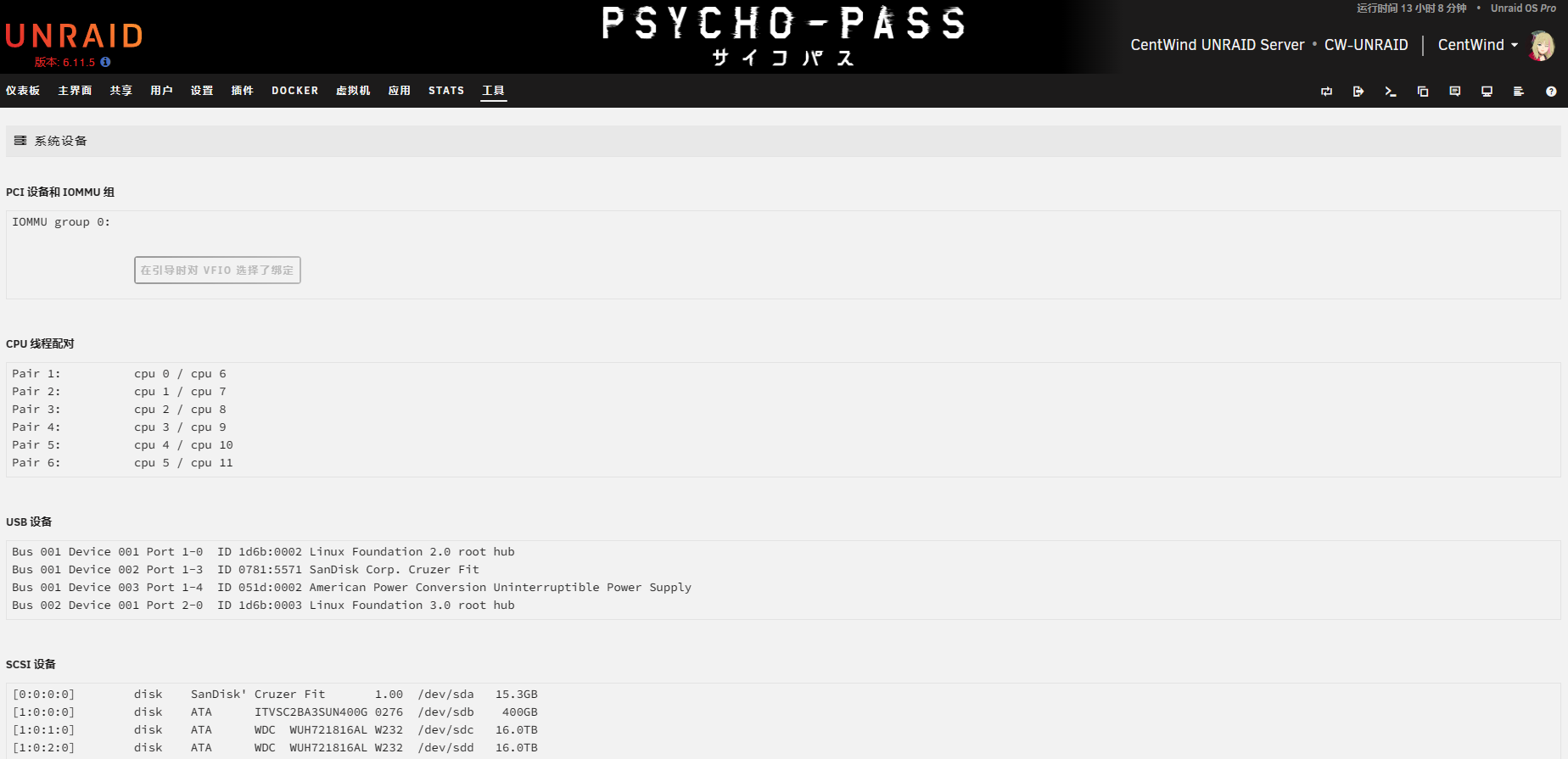

  4. I found that "System Devices" interface "PCI Devices and IOMMU Groups" does not display any devices. how to solve it?
  5. 有什么解决办法么,我记得之前都是有东西的,以前我还直通过nvme硬盘给黑群。
