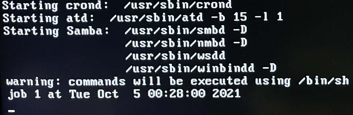

  18. To make things simpler I deleted my VM and unbound everything from it and removed the 2nd video card from PCI-3 slot so now I just have the one video card in PCI-1. I have tried each card in PCI-1. Both will boot natively into unraid without the driver, but not with the driver installed. Once boot is complete the monitor shuts off. I boot in Legacy mode.

  21. I got disable_xconfig=true. After reboot & startup sequence, I now get a horizontal blinking cursor instead of the monitor shutting down. One other change I noticed after installing the driver is my startup's last line is: Warning: commands will be executed using /bin/sh and it sits on that for about 60 seconds before boot finishes. If I delete the driver and restart it doesn't do that anymore.
