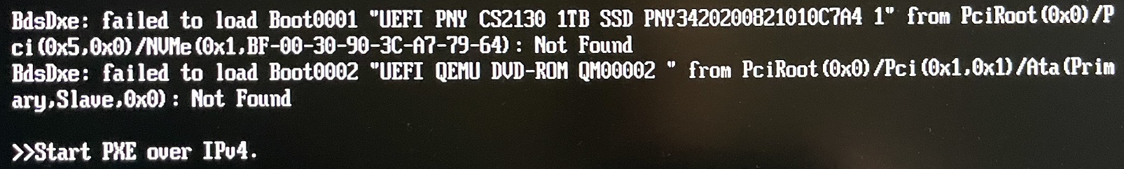

  4. My second day of forum surfing, and I found this: https://learn.microsoft.com/en-us/windows/deployment/mbr-to-gpt That fixed my problem, all booted and ready to go. Don't know why my windows install media that I DLd the other day didn't format that way in the first place....
  5. Before I started this process I cloned my VMs NVME ssd to a SATA ssd. If I change the VM settings to the bound SATA ports, I can actually boot into that, so I know my VM settings work, I just don't know why they aren't working for NVME??? Any ideas anyone? PLEASE HELP, I've got a lot of work piling up. PS I thought maybe something went wrong when I loaded windows on the NVME, so I re-re-loaded windows on it and it still won't boot
