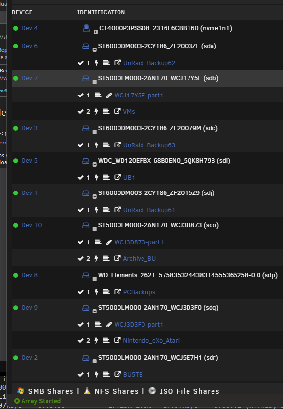

  9. Thanks for the quick response. By device do you mean like /dev/sda?. I see screenshots where peoples drive are set by "Dev 1, Dev 2 Dev3, etc..." but not mine. Which was way I was thinking that there's a way to sort by that. I'll look at the Device Settings of course. Thanks again for the quick response.
  10. Is there any way to sort the external drives that are connected to the server? Say by Device # or partition name?
