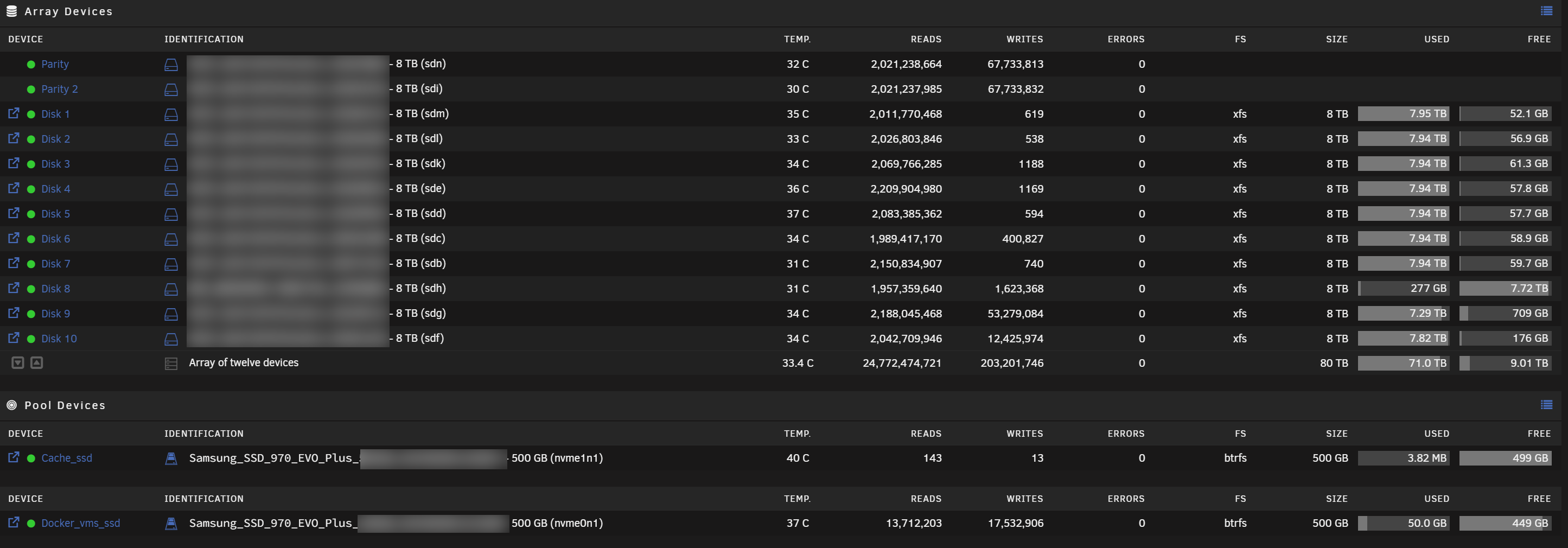

  7. Hi all, First of all, just want to say that everything works perfectly on my Unraid but I'm just looking to confirm whether my setup is the best possible way or if there are better options available. Simple and short: 1. I run two dockers that need a 'downloads' share: binhex-qbittorrentvpn and JDownloader2 2. My goal is to prevent the Array from constantly writing to both parity disks, in order to prevent unnecessary wear and tear My setup: 1. created a Share 'Downloads' with a single drive assigned to it, namely disk 8 (8TB disk) 2. created a pool called 'Downloader' with a single drive assigned to it, also a 8TB disk. This disk is not part of the Array, only assigned to the pool 3. set my 'Downloads' share to 'Use Cache Pool Only' and set the 'Downloader' pool as the cache. If I understand correctly, this means that everything that is downloaded will stay on the 'Downloader' pool and will not be constantly moved to the Array and written to the parity disks 4. Once a download is done and can definitively be moved, I move the file to the correct location (Share) on the Array with Krusader 5. Only then do I launch the MOVER so the files are moved from the 'Downloader' pool to the Array, in the correct share, in one go Is my setup correct for what I'm aiming to do? Or is there a better way? Any feedback would be very appreciated, thanks a lot!

  9. I have a problem with my shares not behaving as intended and I think it's because I've missed something or didn't configure it well. Here's the general setup: SHARES: MOVIES : disks 1-4 TV SERIES : disks 5-7 DOWNLOADS : disk 8 The only share using a cache pool, is disk 8. The others are not using cache pool Now, I have set up Binhex Qbittorrent, which downloads to the cache pool, and when the mover runs, it transfers the finished downloads from the CACHE to DISK 8 (DOWNLOADS Share). So far, so good. However, when I then use Krusader to move those files into the MOVIES and TV SERIES shares, instead Unraid creates those same folders into disk 8, instead of moving the files. I think the reason is because Unraid will not move files around that are on the array, but will instead creates subdirs on the disk they already reside on. Now, I can fix this by using unBALANCE, but that's just additional hassle. Is there any way to set things up so after downloads are completed in the CACHE, I can move them onto the disks I want them to go, namely: disks 1-4 for MOVIES and disks 5-7 for TV SERIES? Any insight would be greatly appreciated!
