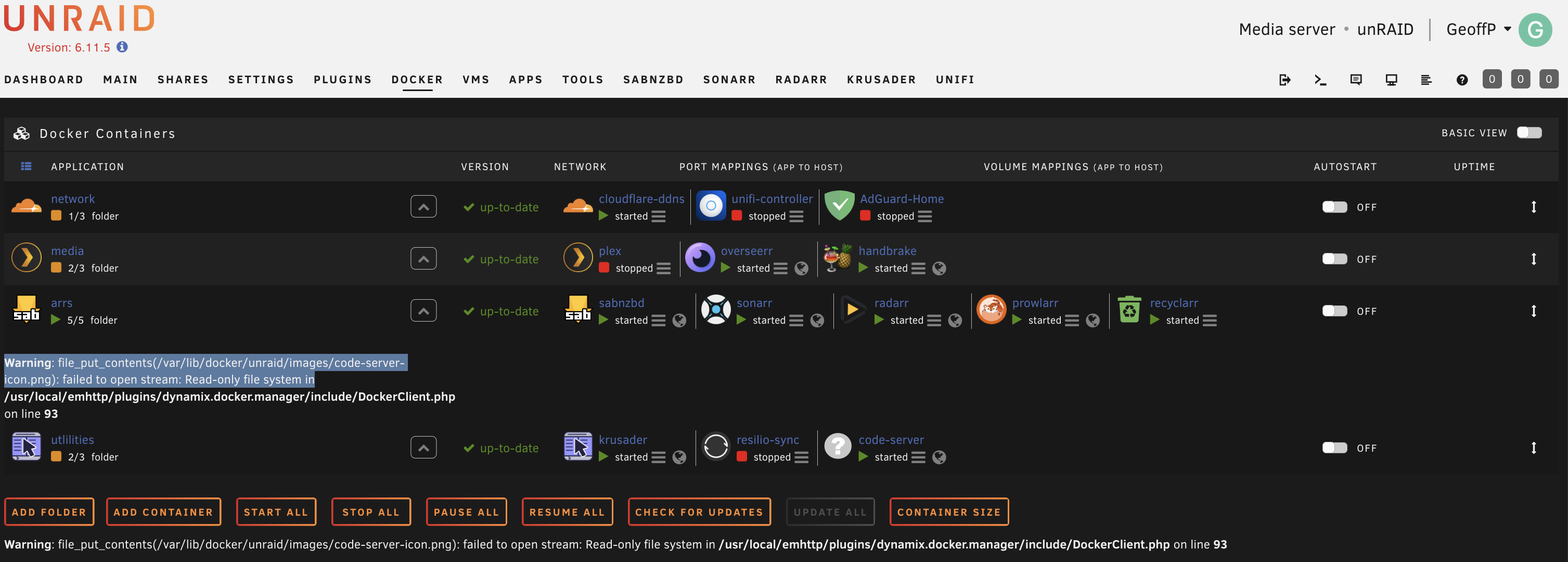

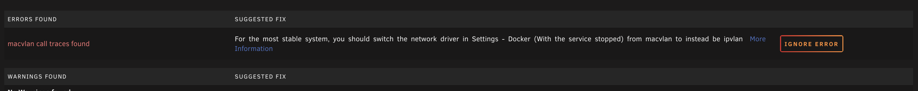

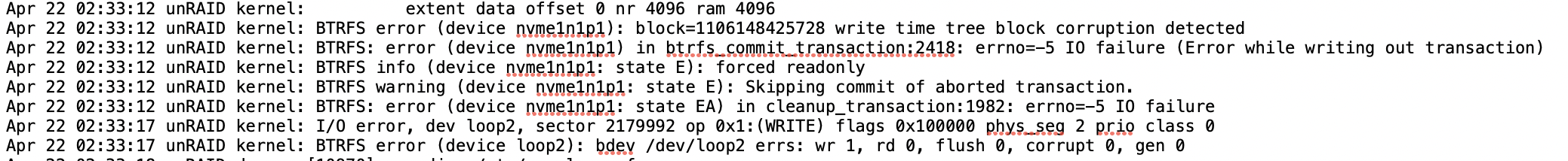

Hi Jorge Thank you so much for replying so promptly: I will enable ipvlan and also sort out the memory issue. When I configured the new MoBo I enabled XMP for the memory. Little did I know that this was overclocking the RAM..I learned this from Linus Tech Tips..a little knowledge can be dangerous 😜 Thank you for your support!

Hi Guys, I have run three unRAID servers for almost 3 years with relatively few issues: the ones that I have had have been solved from within this fabulous community and also watching SpaceInvader One and Ibracorp videos. Very solid work!! Anyway, I upgraded my father's unRAID system (he is 80 and loves it!!) with a new MoBo and CPU last weekend. It has been stable for a week or so and then in the last two days I have seen various docker crashes. This message shown is very similar to the other two crashes I experienced the day before. I am undecided which way to jump: i. I have a custom dockernet using macvlan...should I change this to ipvlan as this is mentioned in Fix Common problems ii. Is it a memory error as I have seen BTRFS errors in the logs and I have seen a similar post where I have seen (the sublime) Squid mention that BTRFS failures could be a result of failing memory. iii. Is this a corrupt docker.img?? possibly because of the BTRFS errors above?? Or, am I just lucky and it is all of the above? Would anyone be so kind as to point me in the right direction? I have attached the diagnostics file and also set up remote syslog to capture any further events. Thanks in advance!! unraid-diagnostics-20230422-0916 anonymised.zip

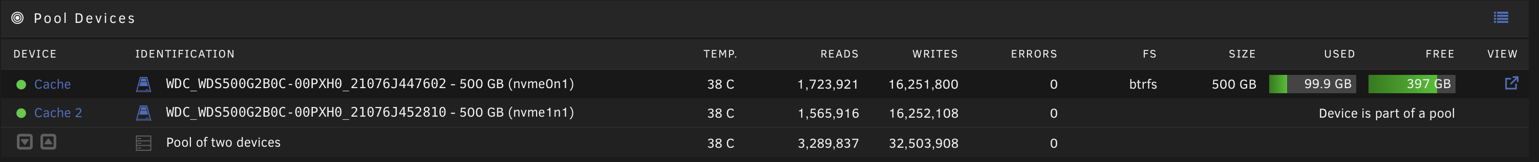

Sorry: some emails arrived slowly then. I'm running 6.10-rc2 so that I can use the TPM in Windows 11 VM. I was aware that I can have multiple multidisk pools but do not have the need for them. I have 8x3tb drives. One is a parity. I plan on upgrading the parity to a larger drive so I can start increasing the size of some of the others too. The reason I ended up with 2x500Gb is there was an extra one in the box when it arrived . I did not want to 'waste' it. I first set mine up with single NVMe cache drive but then realised VMs and AppData stored on there which is basically all the configs for the Dockers and the Plex Library so thought it would be nice to have a RAID redundancy so that if one failed it should not cause too much hassle. The parity obviously does not backup the cache.

Hi there, I have the 2x NVMe drive now installed as a Cache in a RAID btrfs configuration. Regarding the atomic moves I have a media share with three subdirectories (downloads/movies/tvshows). Downloads has two subdirectories (complete/incomplete). Movies contains directories of individual movies. TVShows contains directories of individual series. I had not got my head around this at first with the atomic moves but it all works setup as it is now. I hope this information helps.
