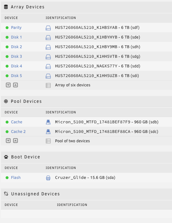

  6. I'm using a Dell T710 for Unraid 6.11.5. This has 8 internal slots for drives and I'm currently using two of those for the Cache drives. What are my options to move the Cache drives? I'd like to use all 8 slots for the array to expand my overall storage. I am using a Dell H310 HBA card in IT Mode - with both channels used for the drive cages. I also have an unused eSata card installed. Use the eSata card for an external enclosure to house the SSD drives (create a new pool, or use Unassigned Drives)? Current Config: Dell T710 II - Two x5690 Xeon CPU’s (12 cores, 3.47 Ghz) 96GB DDR3 Mulit-bit ECC Ram Dual 1100 watt PS Nvidia Quadro P2000 video card for transcoding (love the T710 for this easy install as opposed to the R710) Dell H310 HBA card – IT Mode (6) Hitachi HUS726060AL5210 6TB SAS Drives (30TB Array) (2) Micron 5100 MTFD - Enterprise 980GB SSD Drives (Cache) Dell / Intel XYT17 / X520-DA2 10GB FH Network Adapter (2 ports) running as bonded, active-backup Thoughts and advice much appreciated.

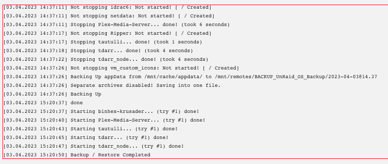

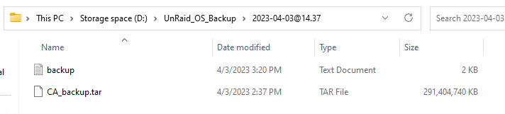

  7. That did it! I'd thought of the spaces in the Windows directory earlier, but assumed since the OS (UnRaid & Krusader) saw it and worked to browse it was ok. Probably a best practice to follow anyway (no spaces) when mixing OS's. Thank you!

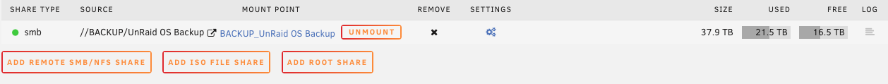

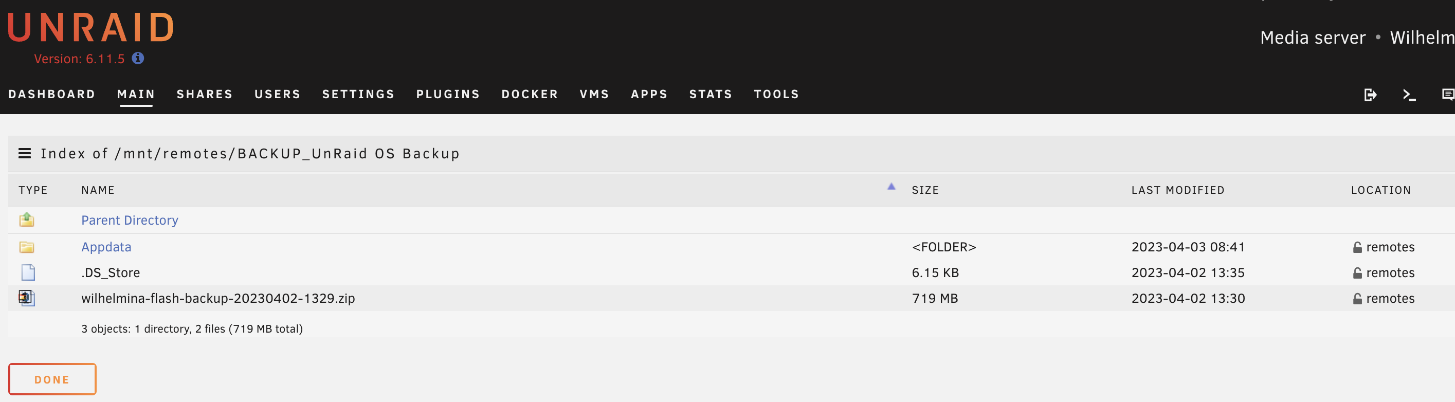

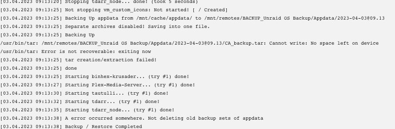

  9. Target directory from UnRaid below. I tried target configs with both: /mnt/remotes/BACKUP_UnRaid OS Backup/ and /mnt/remotes/BACKUP_UnRaid OS Backup/Appdata/ Aside from my flashbackup file and the .DS_Store file (from my Mac touching the directory), there are no other files in the target directory.
  10. Trying to use CA Appdata 2.5 using /mnt/remotes for destination. I am getting the error: CA_backup.tar: Cannot write: No space left on device. My remote target is an SMB share properly set up and working (I can browse and write from Plex) and with 16tb free. Any thoughts?
