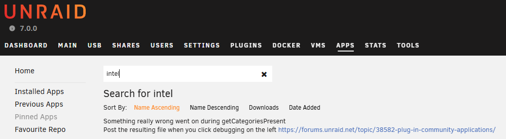

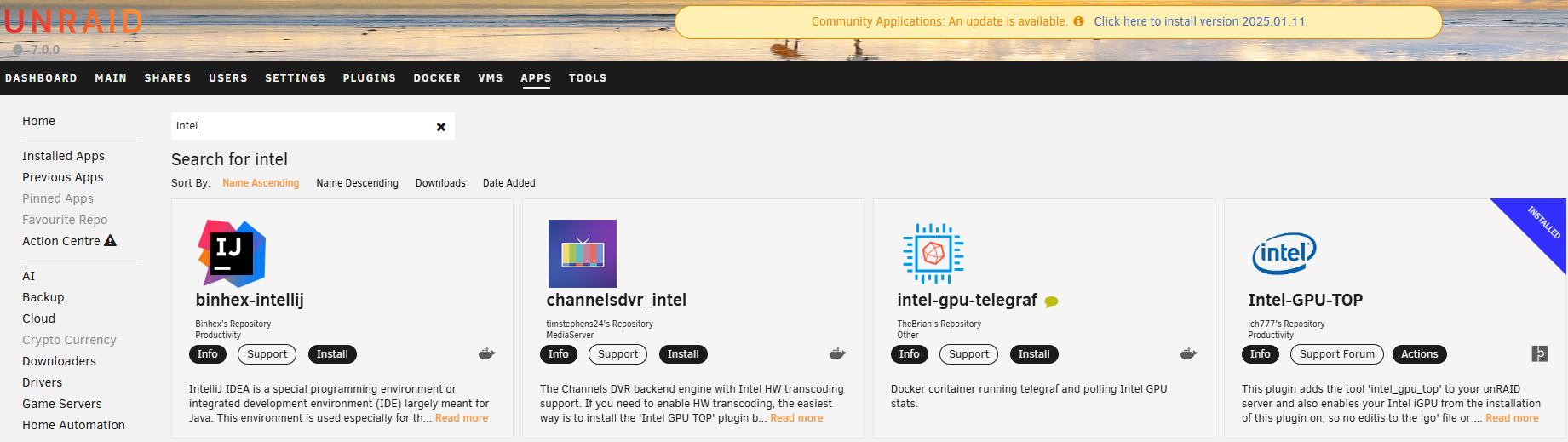

  1. It appears the 2025.01.11 update to the CA plugin is the issue, it is NOT an Unraid V7 issue. I have 2 servers on V7.0.0 and only one has updated the CA plugin and that server has the issue. It appears there is now a 2025.01.11a update which has resolved the issue for me, nice work @Squid
