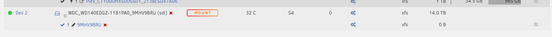

Well that was easy. I can't believe I missed that. It is now running the preclear process. Thanks for the help and the fast response.

Running Unraid 6.10.2 and Preclear plugin version.22.6.10 Adding a 10th drive to my system. A shucked Easystore 14tb. All my other dives are the same. Put shucked drive in bay and I see it in unassigned Devices, but there is no Preclear option. In preclear under tools the drive does not show up. Any thought as how to get this thing precleared so I can add it to my array. All the other easystore drives precleared(earlier version of Unraid) just by putting them in a drive bay (24 bay super micro server) and going to preclear plugin. Screenshot of unassigned drives. Thanks in advance. astro-server-diagnostics-20220610-2011.zip
