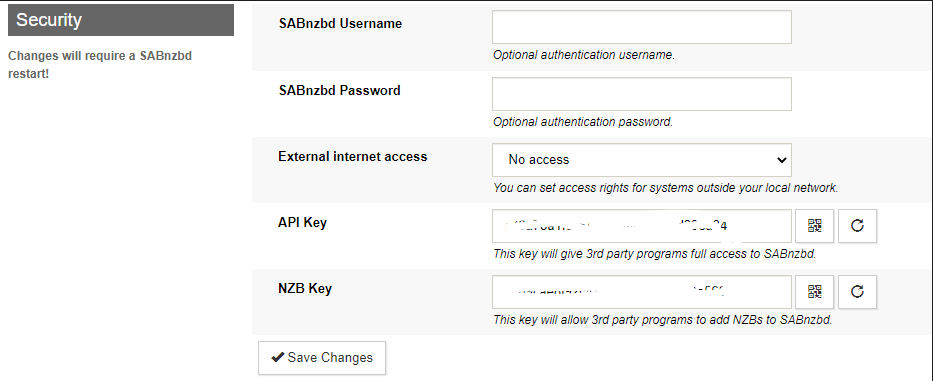

  17. The work around, mentioned in a link above, I don't think helps me. I'm not allowing any external access to need a cert for, from what I can tell...? I've rolled back to 3.7.0-1-01 for the time being.
