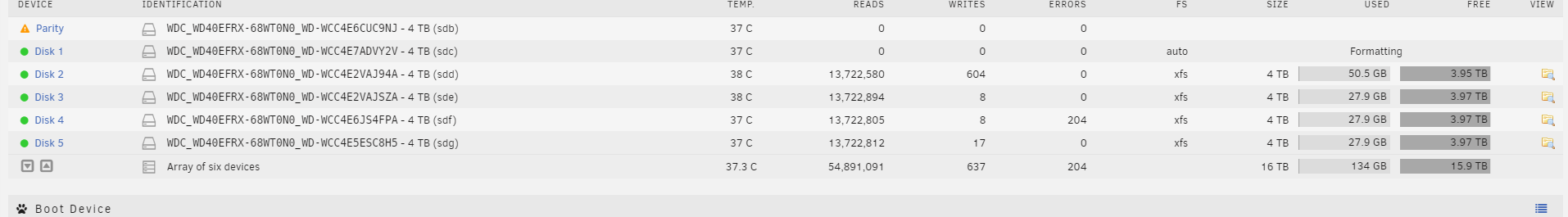

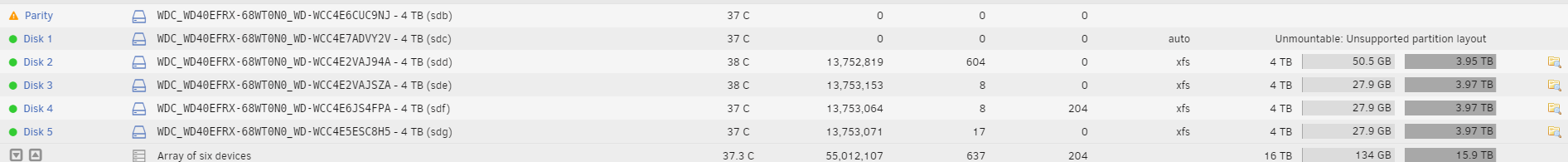

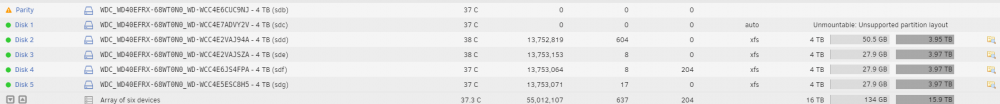

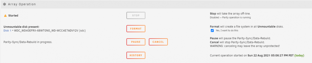

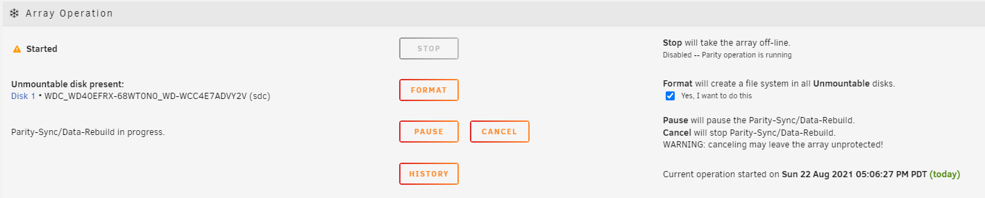

I apologize. I thought I was being very specific with my original post, but I left out the most important part. Every time I click Format, it runs the format for a few moments, maybe 30sec, and then goes back to telling me it is unmounted. Doesn't matter what Drive i put into the disk 1 slot, the OS tells me it is unmountable and running format will not change that status. All six drives have been slotted into the disk 1 slot with the same result. I even Verified that it is not a hardware issue by changing the SATA cables and SATA ports (altho I have not ruled out hardware 100%, maybe a driver or device compatibility issue?). The only time I have been able to get disk 1 (which ever physical disk it happens to be) mounted is when I configure the array with 2 parity drives. I have used the "New Config" tool several times to make these changes, and even changed the version of Unraid to the latest stable version. Nothing I have searched of online describes this issue perfectly, but I have read that Rebooting the server and then formatting can help, or starting the array in Maintenance mode would do the trick. These still failed to work. I format It looks like this Then back to this.
