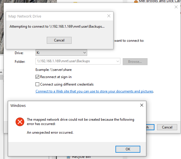

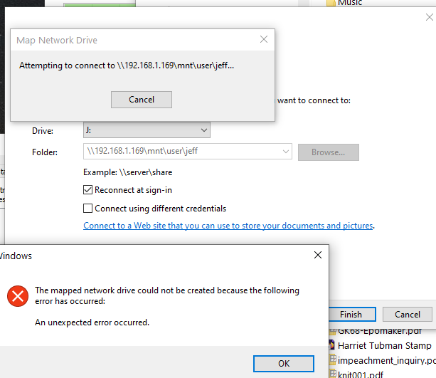

I made the mistake of patching and rebooting. No access to shares as usual. Same error. NFS running, SMB running. Tried creating a new user and share but no access. Attempt connect to an existing share returns: "The mapped network drive could not be created because the following error has occurred: An unexpected error occurred." And yes, I've tried every thing in this thread multiple times. tower-diagnostics-20240507-0518.zip

Just because I like grasping as straws, I tried this...again...and it worked as well as it has all other times. Which is not at all. First network path not found then no permission, even though I can 'access' via nfs/tcpip. and it is a share set to public in SMB/CIFS and NFS
