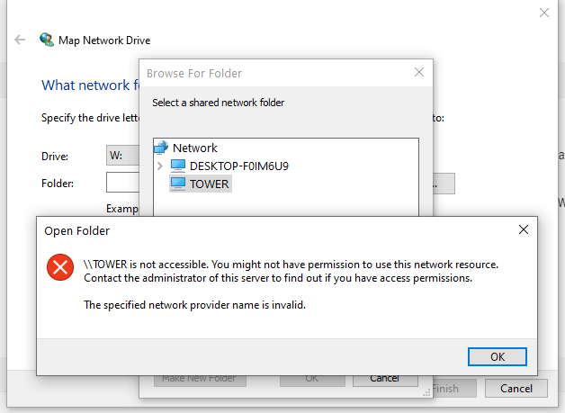

Raid has SMB enabled. Was functioning until about (mumble) months ago - I can search for my first post on the failure if necessary. ping, NFS, console, terminal, etc (I.E. _ALL_ other access to server functional. Failure sequence (text. screen caps if needed) explorer | this pc | map network drive selection box: chose drive letter click browse browse for folder box appears click on "tower" get error: "\\TOWER is not accessible. You might not have permission to use this network resource. Contact the administrator of this server to find out if you have access permissions. The specified network provider name is invalid." I have verified SMB1 off, 2/3 on. I have run through adding a credential. I have gone through the multi-page pdf from elsethread.

Win 10 workstation fully patched connecting to unraid 6.11.5 Since at least one unraid update ago I have not been able to connect with SMB. I _can_ connect with NFS All SMB shares are public. When I have the windows 'Map Network Drive' 'browse for folder' box open I will see the server _name_ disappear and reappear when I make any changes to a SMB share as a test (to private for instance). Which makes me think that Windows sees some SMB but not all of it. The error when I try to Browse by server name is '\\TOWER is not accessible...The specified network provider name is invalid." connecting by ip in the Map Network Drive folder selection does work for NFS. I have gone through the How To on Advance Network Settings to no avail. Yes, I can continue with NFS, but SMB allows better control and use of the wonderful recycle bin plugin.

After the my server plugin issue this morning I can not access any mounts on my unraid server. I can ping from unraid terminal to windows ip I can ping from cygwin terminal to unraid ip When I try to connect i get: M:\ is unavaiable. When I go to Map network drive then click browse and select the server "TOWER" it returns: \\TOWER is not accessible. You might not have permission to use this network resource...." This qualifies as a really odd failure - to me at least. tower-diagnostics-20221024-2034.zip
