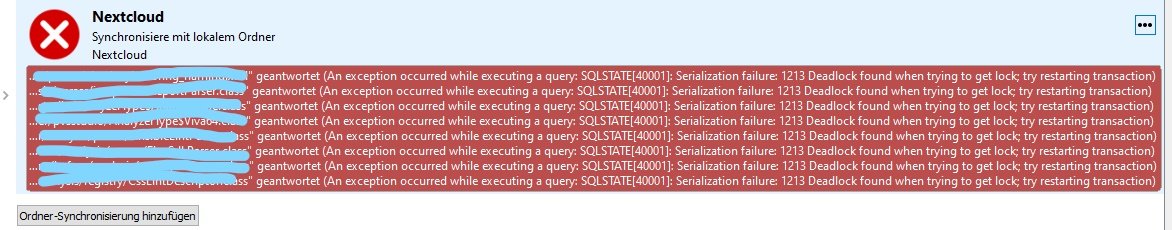

[Support] MariaDB Official
When I sync my data from Nextcloud (data is mounted as external storage in Nextcloud) on my PC I recently get: (An exception occurred while executing a query: SQLSTATE[40001]: Serialization failure: 1213 Deadlock found when trying to get lock; try restarting transaction) This is what it looks like in the Nextcloud client: After the Nextcloud client resynchronized itself twice more, the error was gone. Does anyone know why this error occurred or how I can fix it? According to the error message, it should be my database or? Edit: I'm setting up the MariaDB and Nextcloud Docker all over again. Edit: That' s a pity, unfortunately it didn't help.
