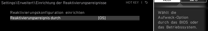

  3. I have now selected "Wake Up Event By BIOS" in the BIOS and set an alarm there. Then started Unraid and shut down via the surface. I have adapted the alarm to the shifted BIOS time and set it to 5 minutes. The PC then booted after 5 minutes. The problem is only that I have so twice a year in the BIOS to adjust the RTC alarm to the time change. But the NAS should actually be right next to the router. But there I have no monitor, etc. Do you have any idea why "Wake Up Event By BIOS" works and "by OS" does not? In the sleep settings, I added the following script under "Custom commands before sleep:": # ##################################### # ######### Settings ################## # ##################################### times=( 03:00 ) # ##################################### # ######### Script #################### # ##################################### # sort times readarray -t times < <(for a in "${times[@]}"; do echo "$a"; done | sort) # delete wakealarm echo 0 > /sys/class/rtc/rtc0/wakealarm # loop through times for time in "${times[@]}"; do now=$(date +%s) fut=$(date -d $time +%s) if [[ now -ge fut ]]; then fut='' continue fi # set wakealarm echo $fut > /sys/class/rtc/rtc0/wakealarm logger -t wakealarm "set wakealarm to "$(date -d "@$fut") done # set wakealarm for the next day if [[ -z $fut ]]; then fut=$(date -d "tomorrow ${times[0]}" +%s) echo $fut > /sys/class/rtc/rtc0/wakealarm logger -t wakealarm "set wakealarm to "$(date -d "@$fut") fi (https://forums.unraid.net/topic/47160-how-to-automatically-wake-from-sleep/?do=findComment&comment=1030273)
  4. Sometimes it can be that simple. There is no LED on, so it seems that the ethernet port is off after shutdown. I can't find any other lit LED either. Other settings like on the pictures above I can't find regarding the LAN. In any case, after the shutdown overnight, the time has not shifted. Before I started Unraid, I first went into the BIOS and there the time is still shifted back by exactly two hours.

  6. I would have to test whether the time shifts during the switch-off. Yesterday I had set in the sleep settings that the computer should start at 04:00. I had then expected that if for the BIOS is 04:00 clock, that the actual time is then just 06:00 clock. But unfortunately it did not work. The computer remained off. Then I leave the settings for tomorrow and if the computer does not start again, I go first to the BIOS and check the time. After that I start Unraid.
  7. The problem is that where the PC is supposed to go, I don't have a monitor, mouse and keyboard. Therefore I can not take the RTC alarm by BIOS.
  8. The maintenance mode does not change anything. Started that, went into BIOS, changed the time, started Unraid and then the time in BIOS is turned back 2 hours. In the BIOS I set the RTC alarm by OS because I would like the computer to turn off overnight and turn on in the morning. To save power. So I installed the Dynamix S3 Sleep plugin and set it there to shut down at night and use a script in the "Custom commands before sleep:" field to start the computer back up. Most of all I would like Unraid to set the time in the BIOS exactly as it is displayed in Unraid. Then I wouldn't have to worry about the time change. Although, by the way, I haven't managed to get the PC to restart automatically in the morning either. In the evening, however, the computer at least shuts down reliably. Maybe I must not select "Shutdown" in the plugin, but must take "Sleep". Do you know if I can set Unraid to pass the time zone set in Unraid to the BIOS and not UTC+0?

  13. Unraid Version: 6.9.2 Hello all, every time I start Unraid and then go into the BIOS, the time in the BIOS is turned back exactly two hours. However, the date, minutes and seconds are correct to the point. (Currently the time zone difference UTC in Germany is +2 hours). In Unraid itself, I set the date and time to Berlin (UTC +01:00) under Settings -> Date and Time. There is also the completely correct time displayed. I suspect that Unraid passes the wrong time to the BIOS, i.e. without time zone. But I don't know what to change. If I set the time correctly in the BIOS and immediately go back to the BIOS when rebooting, the time remains set correctly. Only as soon as I open Unraid and then go into the BIOS, the time is turned back by exactly two hours. Would be very happy if you can help me.

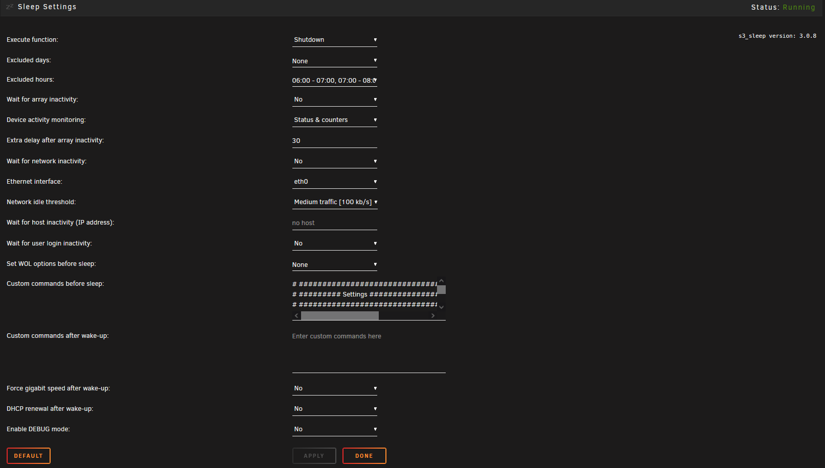

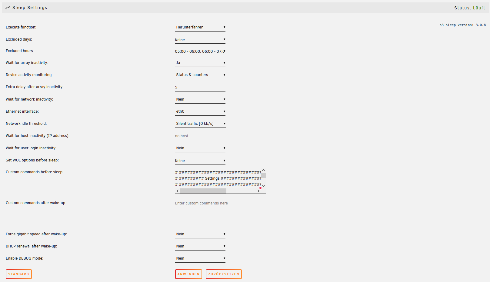

    Habs neuste BIOS installiert, das Problem besteht aber leider weiterhin. Habe mal den MSI Support angeschrieben, vielleicht haben die eine Idee. Ich habe jetzt noch weiter versucht das Dynamix S3 Sleep Plugin zum Laufen zu bekommen. Das automatische Herunterfahren klappt mit diesen Einstellungen so weit: Aber der PC wird nicht automatisch hochgefahren. Im BIOS ist RTC-Alarm by OS aktiviert. Die Zeit habe ich im Skript zum Anpassen minus zwei gerechnet. So sieht das Skript jetzt bei mir aus: # ##################################### # ######### Settings ################## # ##################################### times=( 03:00 ) # ##################################### # ######### Script #################### # ##################################### # sort times readarray -t times < <(for a in "${times[@]}"; do echo "$a"; done | sort) # delete wakealarm echo 0 > /sys/class/rtc/rtc0/wakealarm # loop through times for time in "${times[@]}"; do now=$(date +%s) fut=$(date -d $time +%s) if [[ now -ge fut ]]; then fut='' continue fi # set wakealarm echo $fut > /sys/class/rtc/rtc0/wakealarm logger -t wakealarm "set wakealarm to "$(date -d "@$fut") done # set wakealarm for the next day if [[ -z $fut ]]; then fut=$(date -d "tomorrow ${times[0]}" +%s) echo $fut > /sys/class/rtc/rtc0/wakealarm logger -t wakealarm "set wakealarm to "$(date -d "@$fut") fi (https://forums.unraid.net/topic/47160-how-to-automatically-wake-from-sleep/?do=findComment&comment=1030273) Eingefügt habe ich das Skript unter "Custom commands before sleep:". Aber irgendwie funktioniert das nicht. Wisst ihr, was ich falsch mache?

    Stimmt, daran hatte ich gar nicht gedacht. Muss ich mal überprüfen. Irgendwie scheint bei mir das Dynamix S3 Sleep Plugin nicht richtig zu funktionieren. Hatte jetzt mal testweise eingestellt, dass sich das NAS zwischen 17:00 und 18:00 Uhr ausschalten soll und dann um 18:10 Uhr wieder automatisch ein. Aber das NAS hat sich gar nicht erst ausgeschalten. Ich war mit keinem Gerät zu Unraid verbunden. Könntet ihr eventuell mal drüberschauen, ob ich da etwas anders einstellen muss? Am Ende soll sich Unraid um 0:00 Uhr ausschalten und um 05:00 Uhr wieder ein. Sobald das funktioniert, kann ich den Computer an den endgültigen Platz neben den Router stellen (Hab da aber keinen Monitor usw. drum kann ich dann nicht mehr ins BIOS gehen). Als "Custom commands before sleep:" habe ich das Skript von @mgutt eingefügt von https://forums.unraid.net/topic/47160-how-to-automatically-wake-from-sleep/?do=findComment&comment=1030273. Unter Times habe ich nur 05:00 reingeschrieben. Was ich nicht verstehe, jedes mal, wenn ich ins BIOS gehe, ist dort die Uhrzeit um 2 Stunden zurückgedreht. Wenn ich die Uhrzeit im BIOS verbesser und später wieder reinschaue, ist diese wieder falsch. In Unraid habe ich bei der Zeitzone Berlin ausgewählt: Das tritt auch auf, wenn das NAS die ganze Zeit mit dem Strom verbunden ist. Die neuste BIOS Version habe ich gestern installiert.

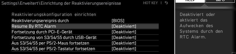

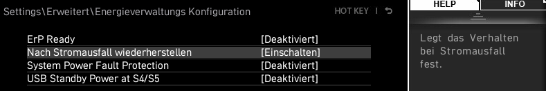

    Das setzt voraus, dass dein Mainboard auf die Timer-Befehle reagiert oder das im BIOS einstellbar ist. Muss man ausprobieren. Ich habe mir mal das BIOS meines Mainboards genauer angeschaut und ich glaube, dass das unterstützt wird. 😊 Zum einen kann ich einstellen, dass nach einem Stromausfall der PC wieder hochgefahren wird. Dadurch startet das NAS, sobald ich die Steckdosenleiste einschalte. Dann habe ich aber noch den Punkt "Einrichtung der Reaktivierungsereignisse" gefunden. Das hört sich meiner Meinung nach besser an, um nicht von einer Zeitschaltuhr abhängig zu sein. Dort kann ich wählen zwischen Reaktivierungsereignis durch BIOS oder OS. Wenn ich das auf OS stelle, könnte ich dann in Unraid einstellen, wann sich der Computer automatisch einschalten soll?

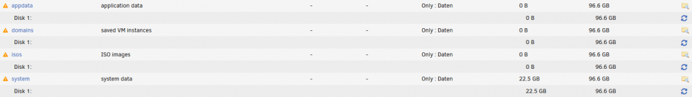

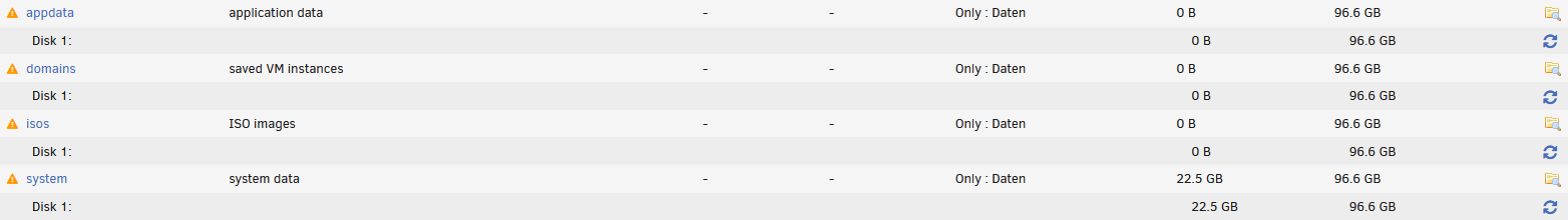

    Vielen Dank für die ausführliche Erklärung. Habe das auch schon umgesetzt (den Pool habe ich Daten genannt): Da im Ordner system Dateien drin sind, habe ich unter Main auf Move gedrückt. Aber die Dateien werden nicht in den Pool geschoben. Falls die 120 GB SSD kaputtgehen würde, würde doch so Unraid nicht mehr gehen, oder? Drum hätte ich dort am liebsten gar keine Daten darauf. Bei der Disk 1 ist das Dateisystem xfs und im Pool btrfs. Das wurde automatisch so eingestellt. Kann ich das so lassen? Was ich aber nicht verstehe, ist, dass wenn ich das NAS neu starte oder ausschalte und dann über den Power-Knopf wieder anschalte Unraid nicht wieder startet. Auch nicht, wenn ich Monitor, Tastatur und Maus angehängt habe. Auf dem Monitor sehe ich dann nach dem MSI Logo nur schwarz. Wenn ich aber dann das NAS wieder ausschalte, den USB-Stick rausziehe und dann den Computer wieder einschalte komme ich ins BIOS. Dort stecke ich den USB-Stick wieder rein und klicke auf Neustart. Auf einmal startet dann Unraid. Dort kann ich dann den Headless Modus auswählen. Eigentlich habe ich den USB-Stick als oberste Priorität ausgewählt. Der Stick ist auch direkt am Mainboard angeschlossen. Beim Erstellen des USB-Sticks habe ich im Tool auch den Haken bei "Allow UEFI Boot" gesetzt. Hab's geschafft ☺️. Unraid startet jetzt von selber. Habe im BIOS ein paar Einstellungen vorgenommen. Vermutlich liegt es aber daran, dass ich Fast Boot deaktiviert habe.
