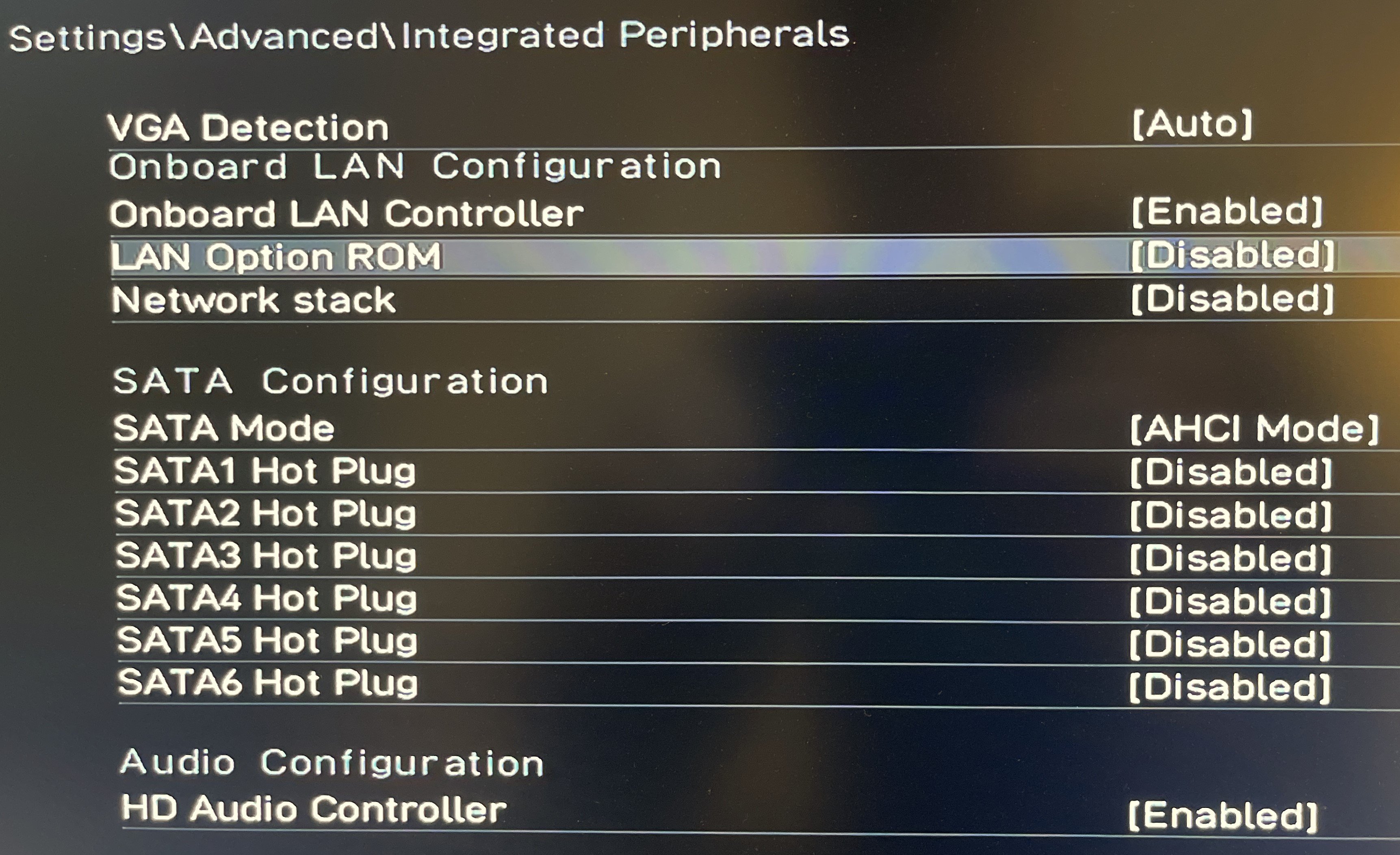

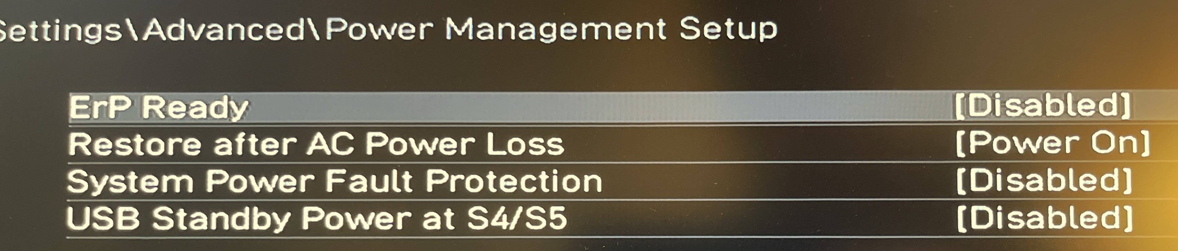

You enabled RTC in the BIOS. But did you disable ErP/EuP? Is the ethernet port active if the server is shutdown?
Yes, it was by default
I am not sure. Onboard LAN Controller is enabled.
LAN Option ROM and Network stack are disabled. Should I enable one of them or both?
4 hours ago, 4n0nyM said:
I am not sure
Check the LEDs ;)
9 hours ago, mgutt said:
Check the LEDs ;)
Sometimes it can be that simple.
There is no LED on, so it seems that the ethernet port is off after shutdown. I can't find any other lit LED either.
Other settings like on the pictures above I can't find regarding the LAN.

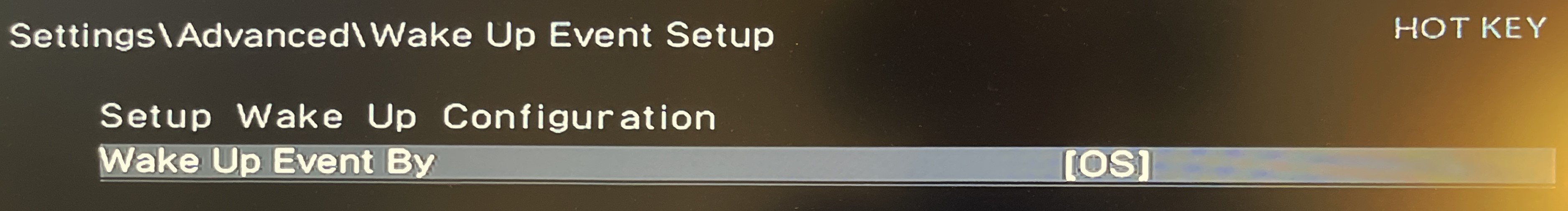

In any case, after the shutdown overnight, the time has not shifted. Before I started Unraid, I first went into the BIOS and there the time is still shifted back by exactly two hours.
I have now selected "Wake Up Event By BIOS" in the BIOS and set an alarm there. Then started Unraid and shut down via the surface. I have adapted the alarm to the shifted BIOS time and set it to 5 minutes.
The PC then booted after 5 minutes.
The problem is only that I have so twice a year in the BIOS to adjust the RTC alarm to the time change. But the NAS should actually be right next to the router. But there I have no monitor, etc.
Do you have any idea why "Wake Up Event By BIOS" works and "by OS" does not?
