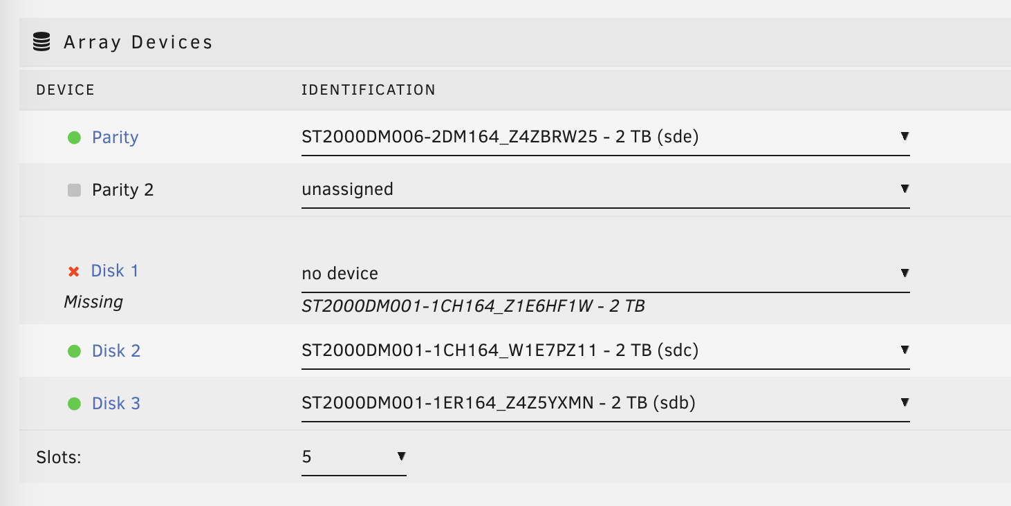

Parity check is completed. So now I would take one disk out, as in, set the disk to "no device", and run diagnostics again? Results: Added diagnostics as well (for the record, it says "supermicro" that's my NAS name as my previous machine was a Supermicro) supermicro-diagnostics-20231123-2038.zip

Wouldn't I want to get parity working first? When I do this I get this message: > Start will disable the missing disk and then bring the array on-line. Install a replacement disk as soon as possible. > [ ] Yes, I want to do this This sounds to me like it'll try to rebuild from 2 disks + parity, does that make sense?
[SOLVED] Moving drives from non-HBA RAID card to HBA
What does this mean. Where do I need to do what? Sorry for my ignorance. My question is still, how do I do this? This is my current situation: Step-by-step (is this correct?): stop array set parity 1 to disk `(sde)` set disk 1 to disk `(sdd)` set disk 2 to disk `no device` set disk 3 to disk `no device` start array do parity check set disk 1 to disk `no device` set disk 2 to disk `(sdc)` start array do parity check set disk 2 to disk `no device` set disk 3 to disk `(sbd)` start array do parity check set disks 1,2,3 to resp sdd, sdc, sdb start array everything works? Does this change when I would like to move from the 2TB disk to the 4TB disk (as I'm planning to replace all disks with 5 4TB disks)
