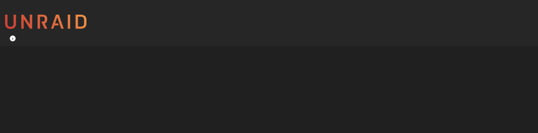

When I go to the plugins tab, I only get the loading thingy (vertical bars) and then nothing happens. Console shows
WebSocket connection to 'wss://<my-server>:4433/sub/var' failed:
 from
dynamix.js?v=1596576684:34
How to fix this? I'm unable to upgrade my plugins at this moment.

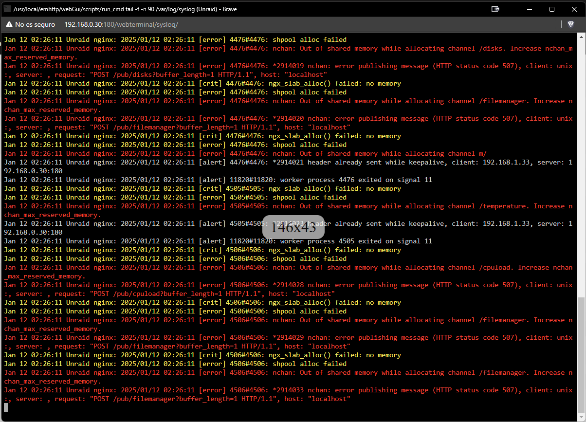

I wonder why developers never addressed this issue, it's not like it's a rare issue, everyone is encountering this sooner or later. Why? Why not fix it? Or at least say "hey, we know about it and we are taking a look at the issue but it's been hard". All we ever got about this issue is a "post diagnostics" and "refresh browser" 2 years ago.
Kinda frustrating ngl.
Anyway, does this has anything to do with it?
Edited by Nirvash
