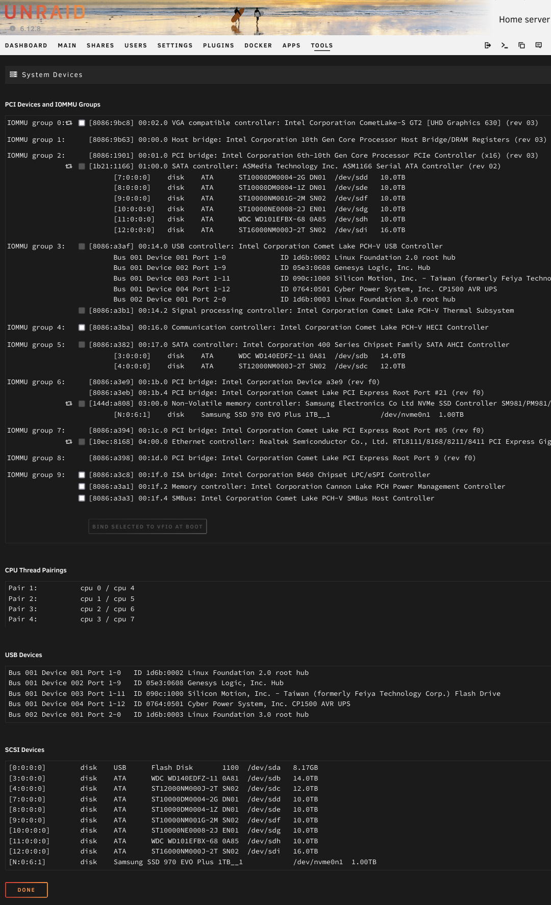

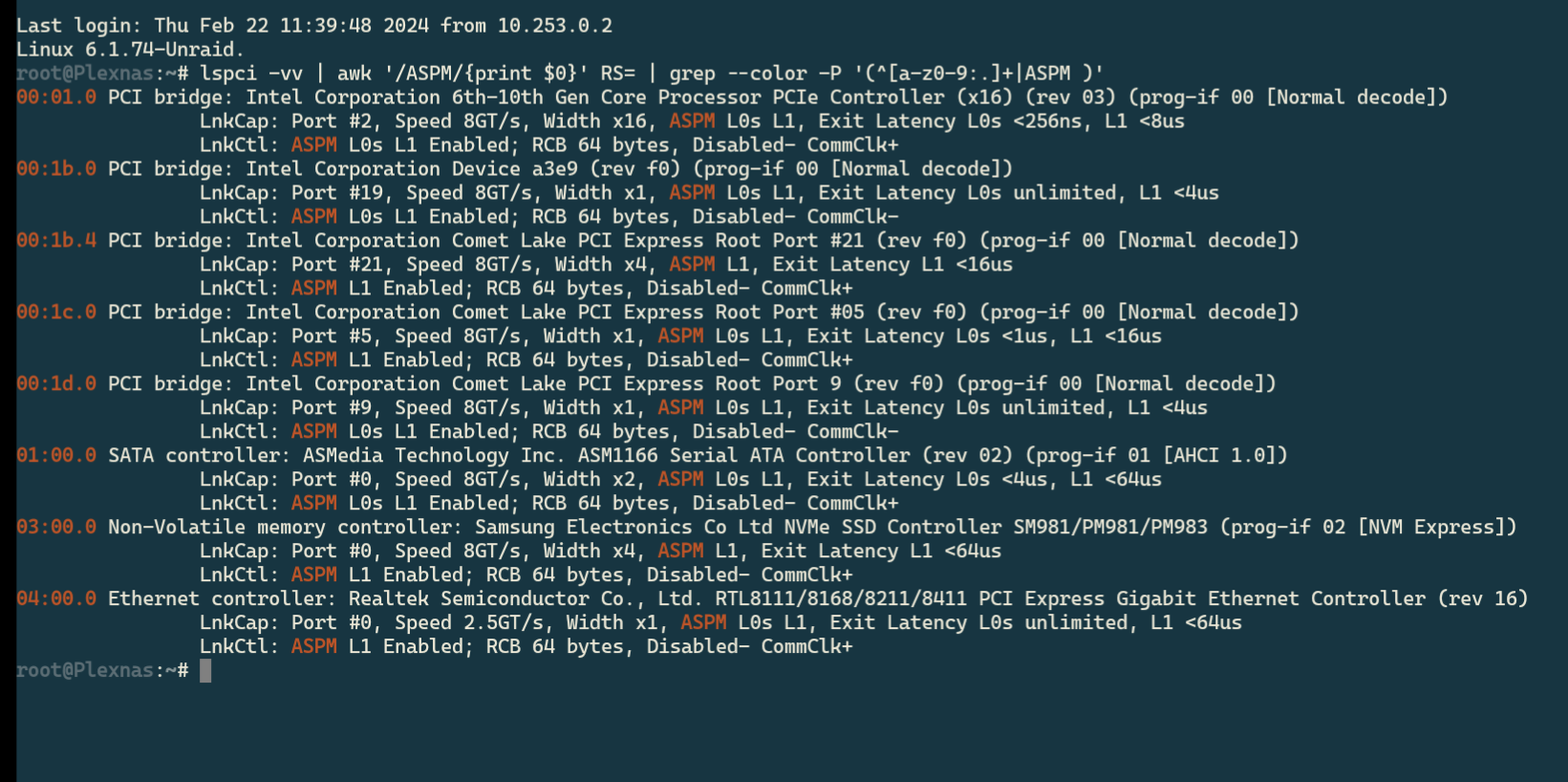

  7. @OrdinaryButt Motherboard is Gigabyte B460 with i3 10th gen. I have gone through the bios settings multiple times with all the suggested settings done. But I will re-check again. What is Speed state and stepping? Any relative setting on Gigabyte Bios I want to look for?
  8. Thank you for your response. Screenshot's attached.

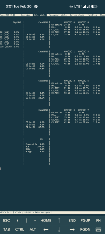

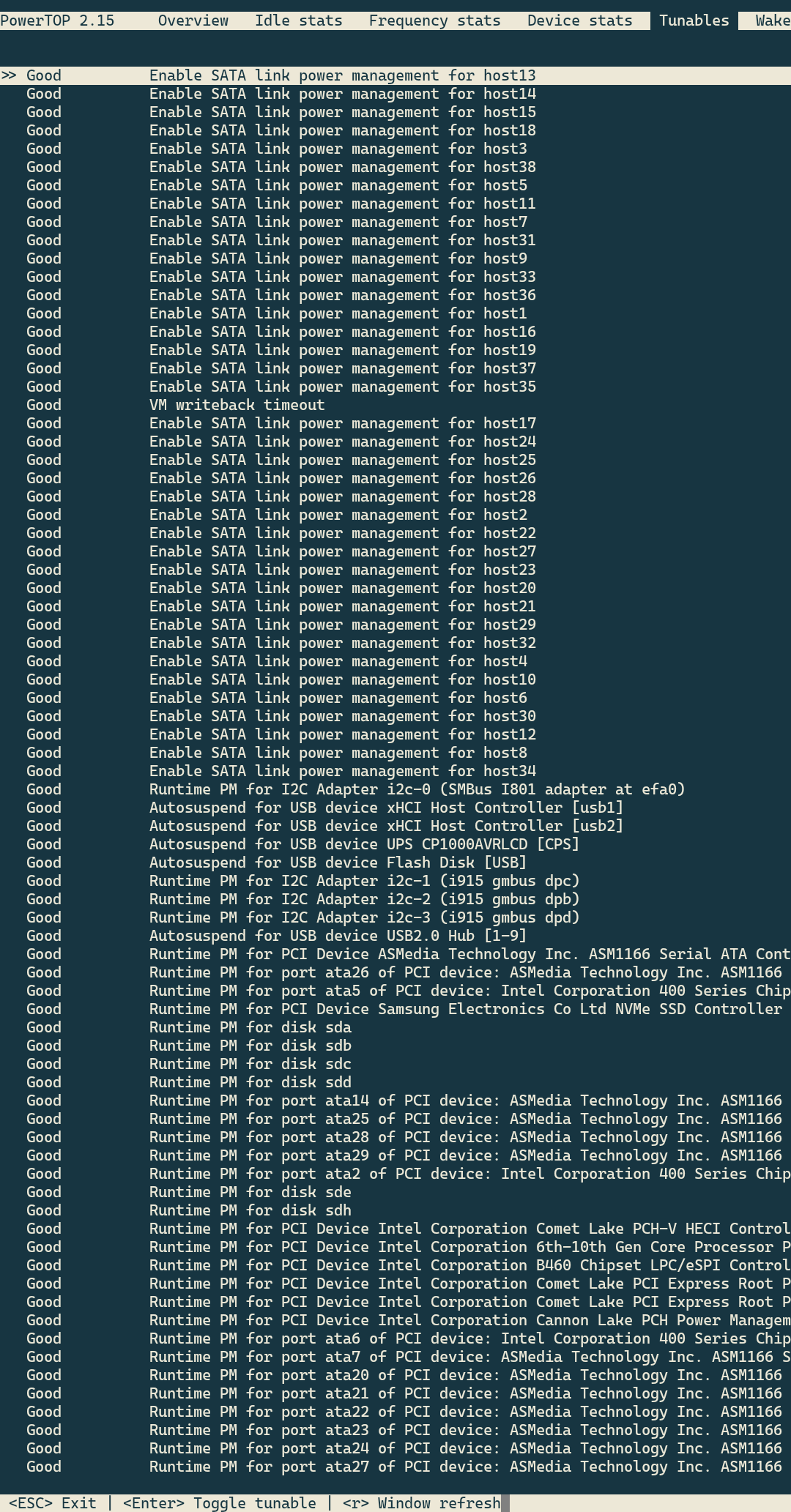

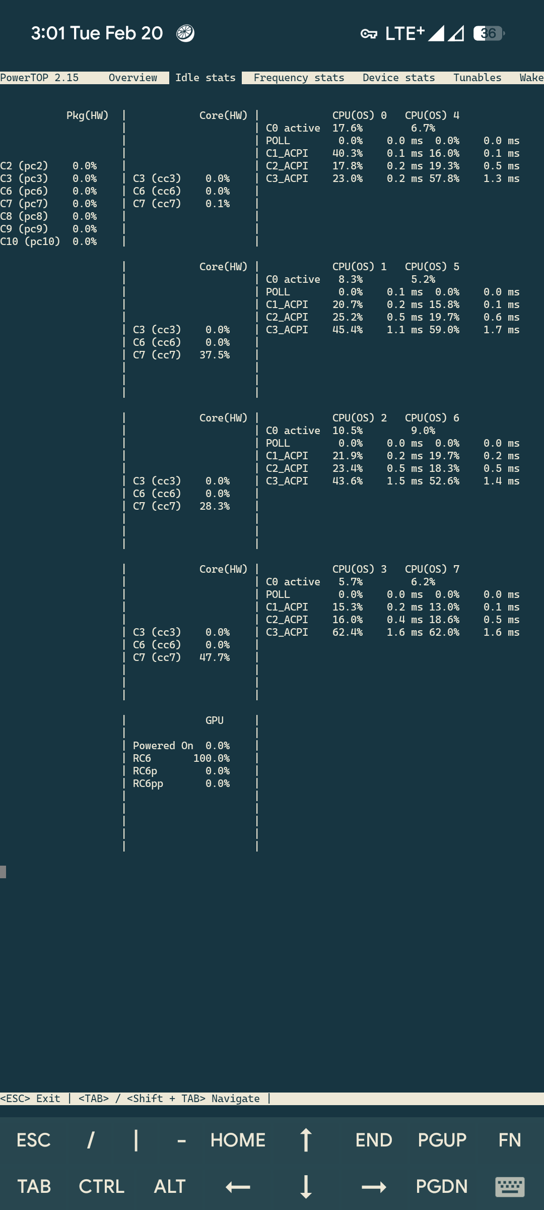

  9. This is something that everyone has asked here.. but for anything if anybody can find a fault in my system please suggest. I am not able to hit anything past C3. I have gone through this forum multiple times and have done most of the part suggested here. My idle power is 54-60 watts with array shut down. Please find the screenshots of my system attached. Thanks in advance.

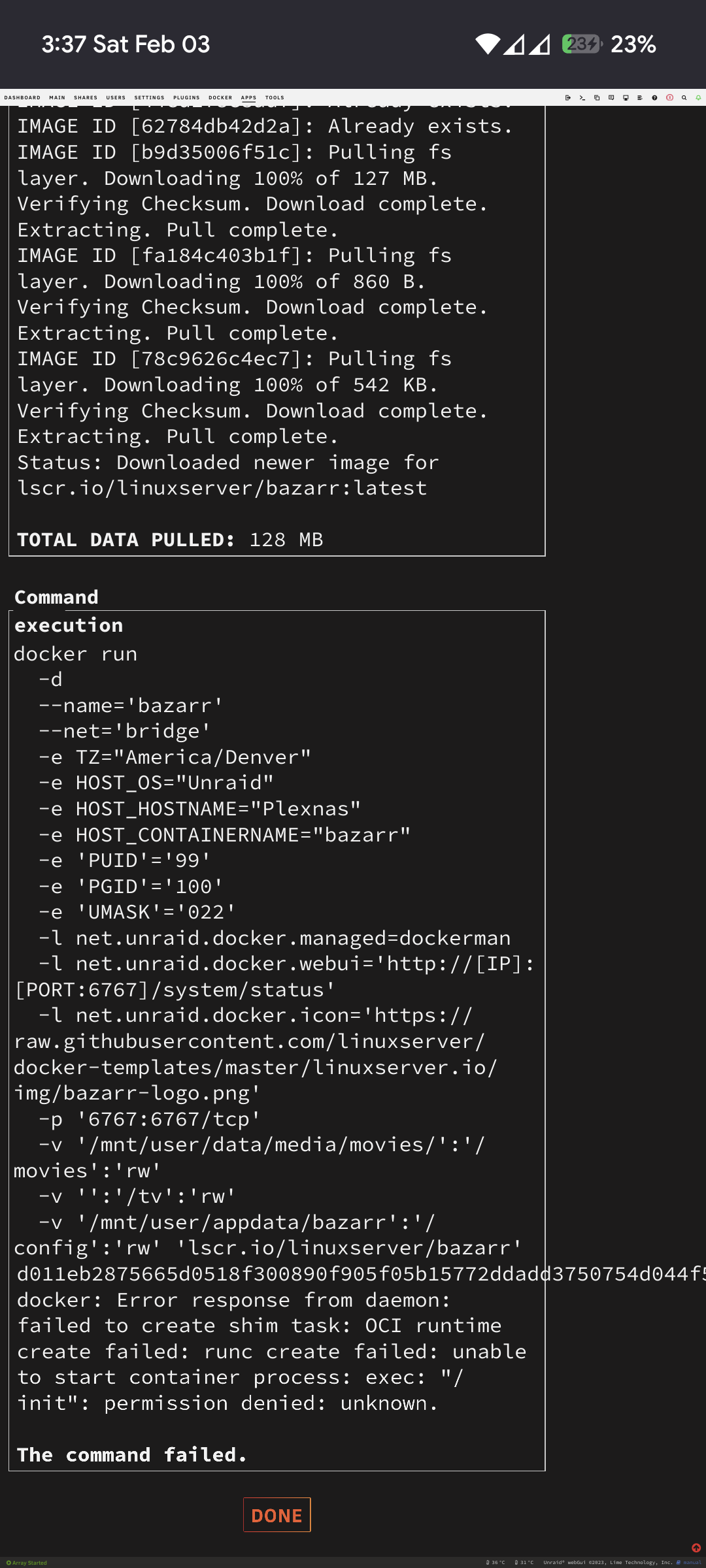

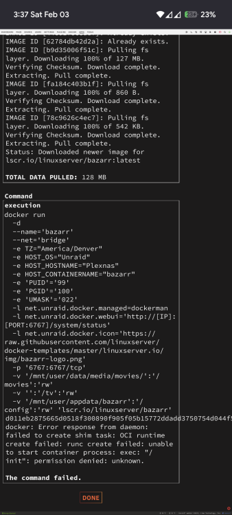

  14. Just tried changing image for Bazarr. Command Failed. Permission denied.
  15. I am unable to get any of the docker started. There's exec error for each and every docker containers. There's also syntax error on mover when I check sys log. What I did earlier was applied 'new config' plugin by selecting All disks which I think has messed up dockers and system. Anyone please guide me on proper direction. I have been trying to find solution myself for last 3 days. With my little knowledge I am giving up. Also find the diagnostic attached.plexnas-diagnostics-20240202-2118.zipplexnas-diagnostics-20240202-2118.zip
