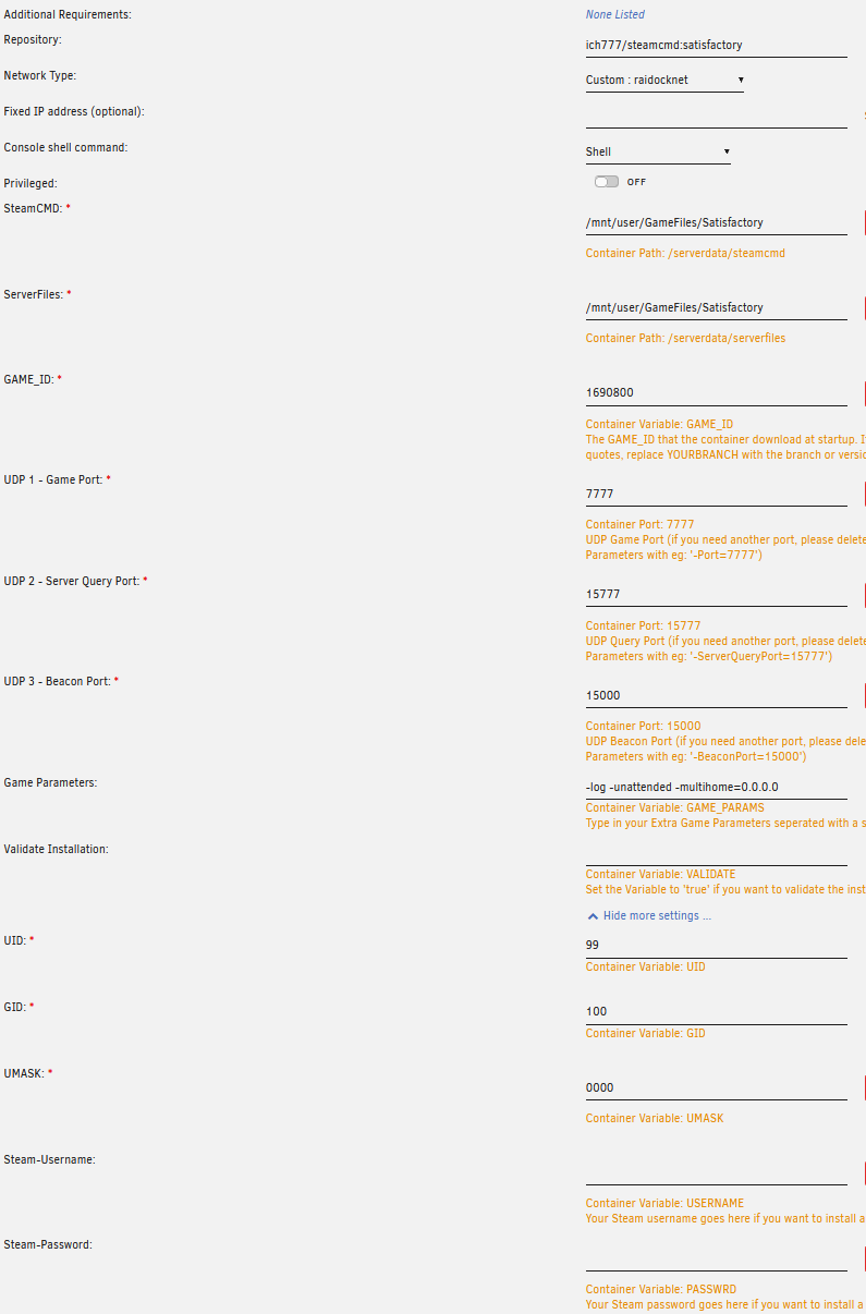

Makes sense that somethings break with weird settings, sadly there is never a "cookie cutter" perfect solution lol. I can confirm that reinstalling the game, with both those directories then re-uploading my save file; everything updated and is back up and running! I am sorry to bug you with such an easy fix, just a simple oversight on my part during the install that cause way more a headache than needed. Thank you so much for your patience and assistance. It is greatly appreciated. ❤️
I thought it was interesting too, took forever to grab that line lol! I had SteamCMD in a different directory than the server files, but I must have screwed up on using it in a separate directory when I re-installed the server (whoops). I have read up on the FUSE bypass and have directly linked SteamCMD and the Satisfactory Server to the following directories: /mnt/disk1/GameData/SteamCMD /mnt/disk1/GameData/Satisfactory I don't think it will make *that* much of a difference in performance however as I am running this on dual xeon 24 core/58 thread CPUs and 1.6TB of ram, with all SSD storage for my disks but I will trust in the wisdom of folks who know a lot more about Unraid than I do lmao I am attempting a reinstall + copying my save files back over and will let you know how it goes!
1. No sir, not on experimental, just the latest steam update (not opted into experimental) 2. Not running anything crazy custom for DNS, just Google and Cloudflare with no Adblocking functionality 3. Screenshots attached plus code block from top of the log. (Not sure how to export the entire start up log in Unraid?). The start does this then instantly spams the 10000 line start up process. usermod: no changes ---Ensuring GID: 100 matches user--- usermod: no changes ---Setting umask to 0000--- ---Checking for optional scripts--- ---No optional script found, continuing--- ---Taking ownership of data...--- ---Starting...--- ---Update SteamCMD--- /serverdata/steamcmd/steamcmd.sh: line 39: 21 Segmentation fault $DEBUGGER "$STEAMEXE" "$@" ---Update Server--- /serverdata/steamcmd/steamcmd.sh: line 39: 39 Segmentation fault $DEBUGGER "$STEAMEXE" "$@" ---Prepare Server---

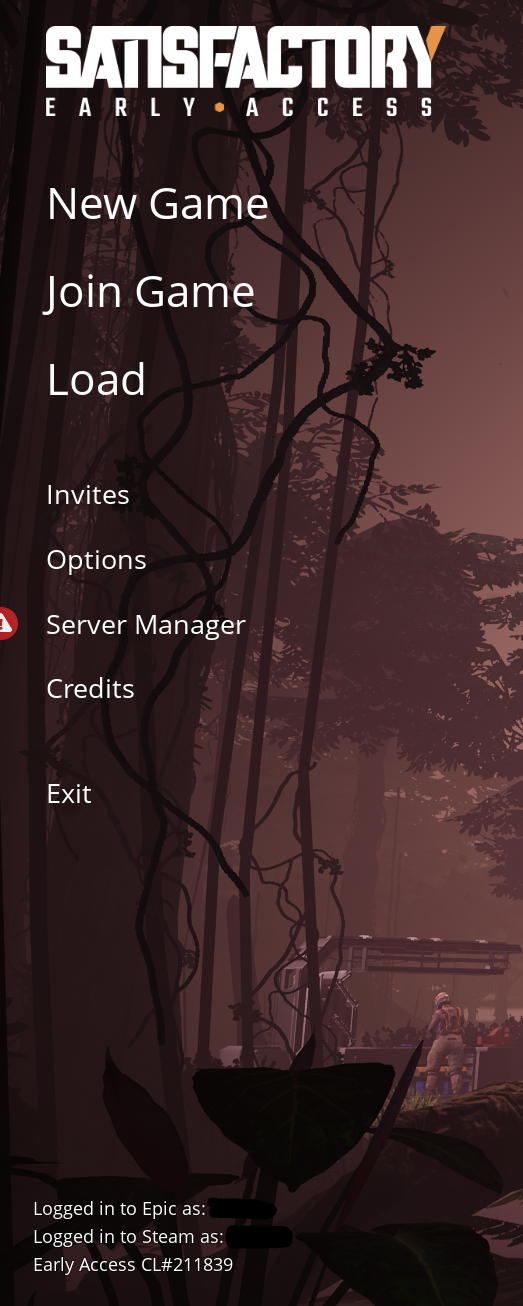

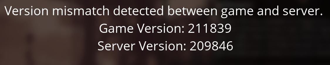

Yes sir! Twice as a matter of fact. Looks like everything is good to go; but even after restarting + reinstalling the server version is mismatched with game version. Server version needs to be bumped to 21116 but I am unsure as to how lol

Hey @ich777 I am having some issues with updating the Satisfactory container. The latest game update is v21116 and the server is v209846. I have attempted to reboot the container a few times and haven't had any luck with updating the files. I did attempt adding my Steam account as well but there is no update at the moment. Any way to check the container to see if there is any conflict with Steam appID, etc. and updating? Thank you in advance!
