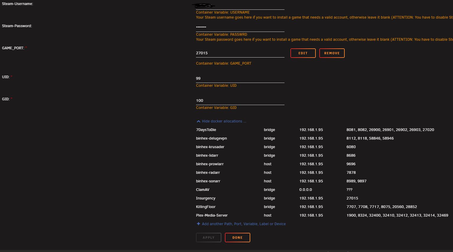

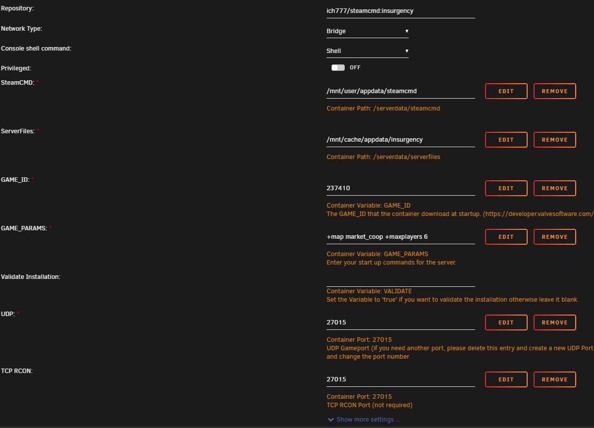

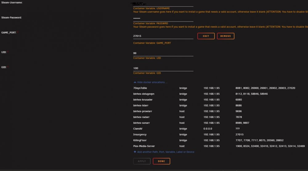

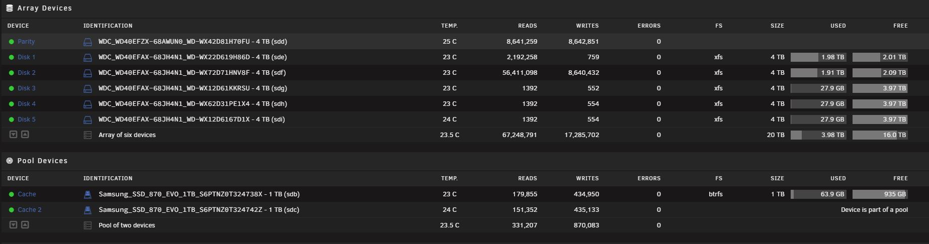

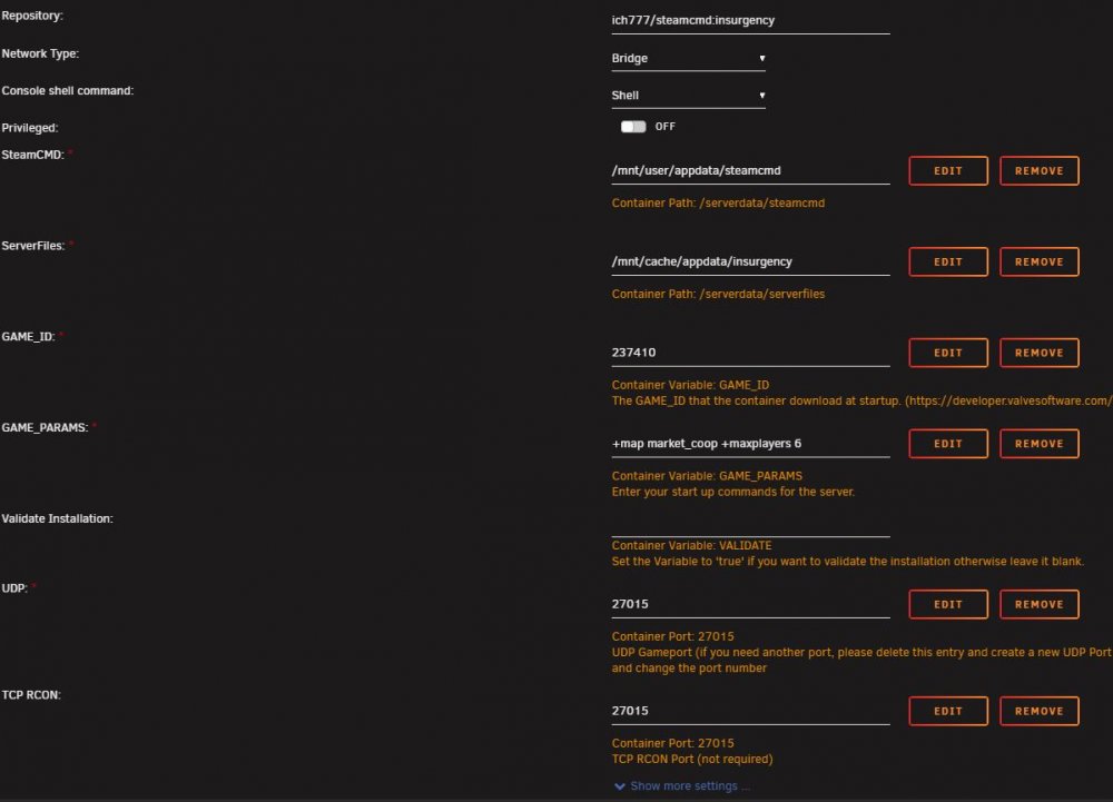

Doesn't loop. Smooth start and stop for that matter. I've included two screen captures of the Docker template (top portion & bottom portion) to make it easier to read. (note, I blacked-out the Steam Username). The appdata folder is set to "Prefer:Cache" I'm also including a screen capture of my Array devices and Pool (cache) devises if that can be of assistance. I've also included my server.cfg file. I really appreciate the time and effort you've put into my problem. Thanks again. server.cfg

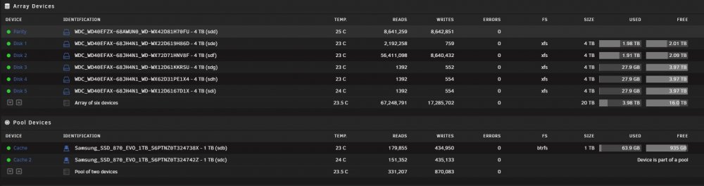

I recently upgraded my cache pool from two 256GB SSD's to two 1TB SSD's (Followed SpaceInvaders video tutorial to do so.) Everything seems to have worked just fine, however, upon rebooting the server today, the Dashboard tab is saying the cache array is stopped . On the Main tab under the "Device" column, the Caches have a red "x" next to them and the word "Wrong". In the "Array Operation" the array is indicated as "Stopped. Configuation valid". On both the Dashboard and Main tab, at the very bottom, it is marked "Array Stopped Autostart disabled (device configuration change). Nothing really changes once I start the array, both the Main and Dashboard tabs have the same error messages, although the array seems to be working fine. To tell you the truth, I'm not sure where to look to troubleshoot this issue. I suspect it's perhaps just a setting that has to be changed somewhere. Any assistance would be greatly appreciated.
