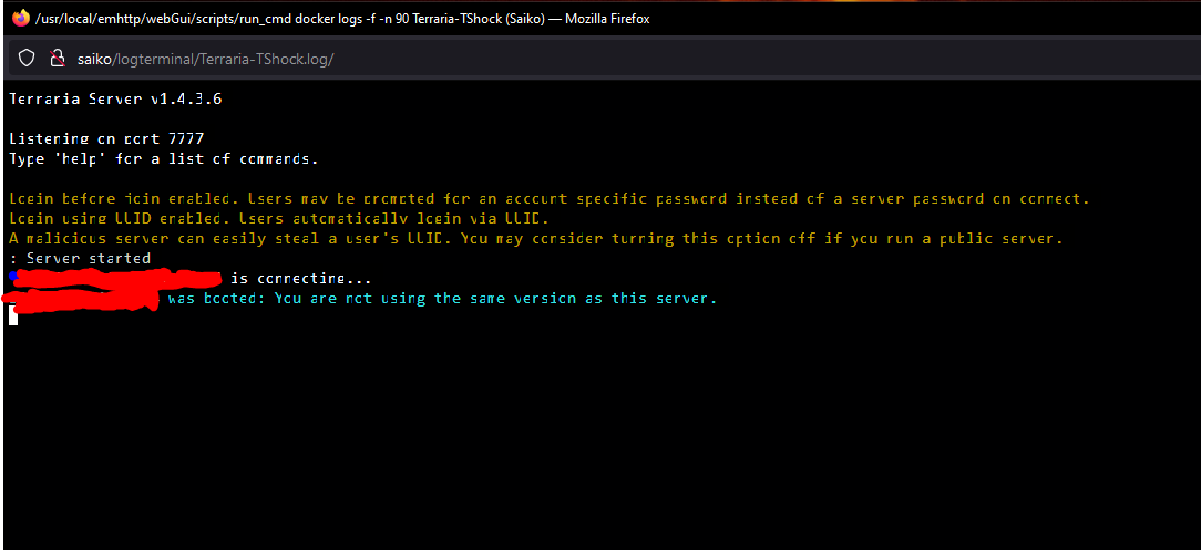

  1. Has this been further delved into? I looked at my \appdata\terraria-tshock folder and can see a file there called 'tshock_4.5.18' which does look like the latest release of tshock; but the log from starting up the container says the game version is running v1.4.3.6. Opening the game states it is on 1.4.4.7 now Thanks for looking into it~
