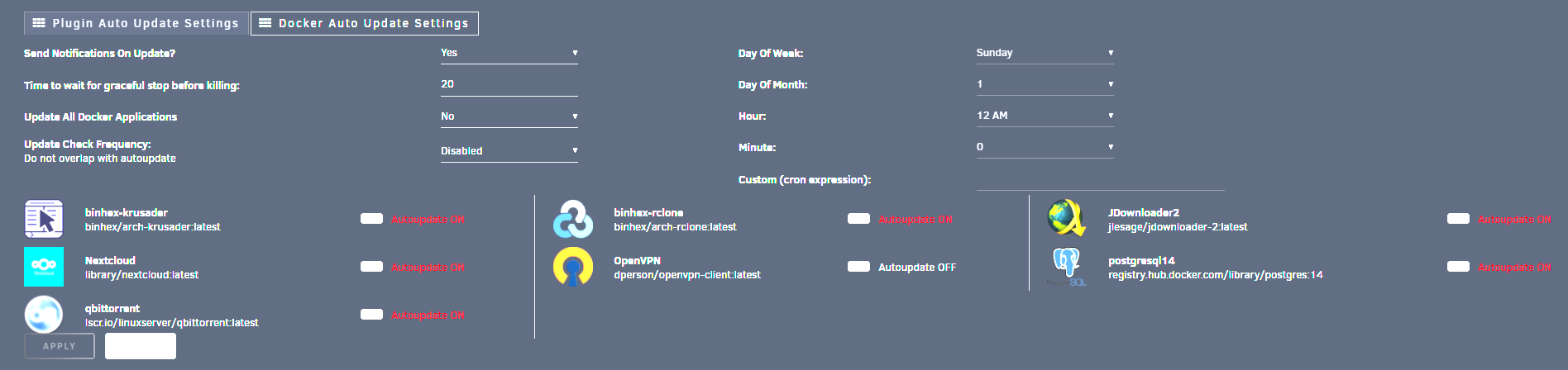

  15. OK that makes more sense, I'll enable that option and wait. Thanks for the help. [EDIT]: Yep it worked, thanks again.
  16. But it says "do not overlap with autoupdate" underneath that. I thought perhaps it meant "do not enable this option if any container has been set to autoupdate below", as if the two options somehow would conflict.
  17. For some reason my Docker containers aren't updating automatically with this plugin. I get the notifications to say whenever a container has an update available but it doesn't update itself. Not sure if I've configured something wrong here... Currently it's the qbittorrent and postgresql containers that have an update on my server.
