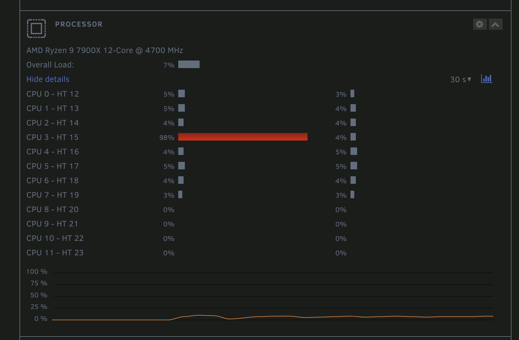

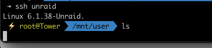

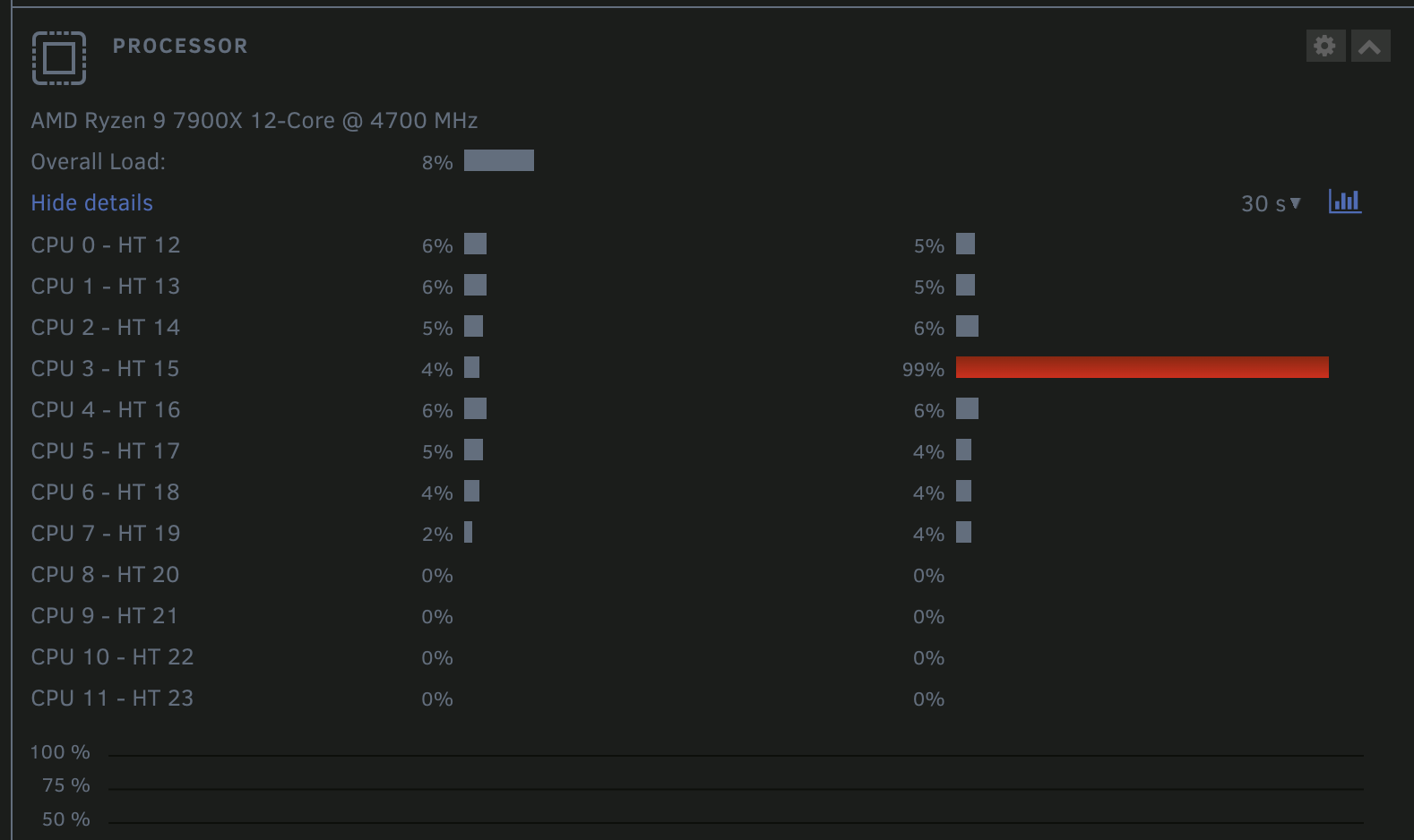

  10. So the crash just happened again. One thing I noticed is when the server starts up and I start the array it takes forever for the first SSH to load my profile. Also same thing happens when I run a basic "ls". The single core is pegged for almost a full minute (see screenshots). After that it operates smoothly. I attached syslog as well as diagnostics. Thanks, Faroh syslog-10.0.1.10.log tower-diagnostics-20230817-1353.zip
