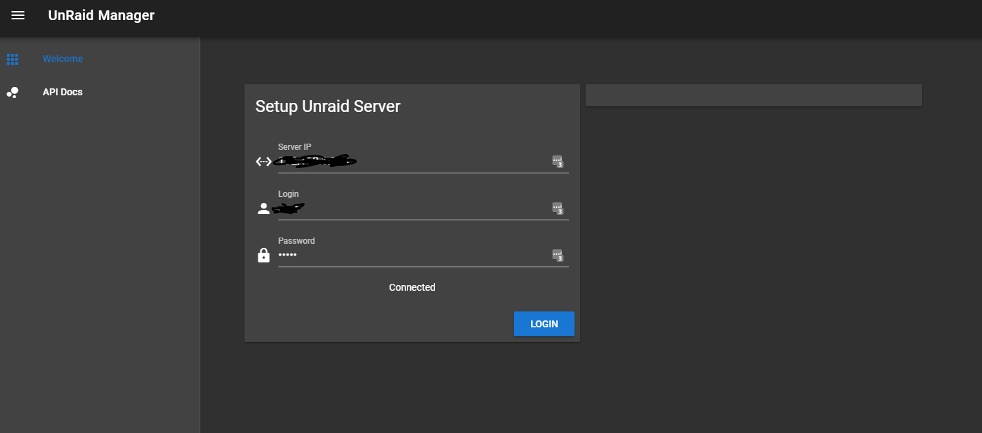

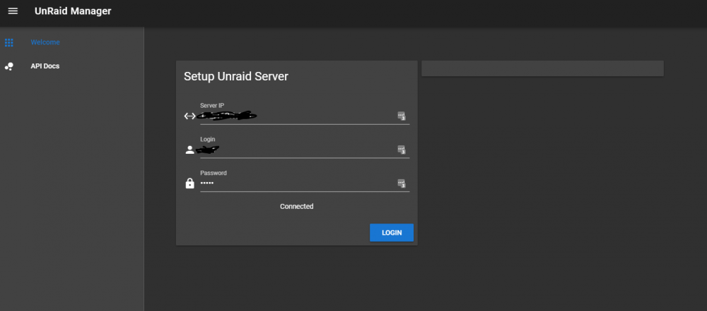

Further, It's unclear what I'm supposed to see when I access the docker UI. Here's what I have;
To get here, I had to enter my unraid username & password twice, first in the above box, then again in a pop up a few seconds later. The only affect seems to be the appearance of the shallow  grey box on the right. What should i expect to see here?
if I click on 'API Docs' and then back to welcome, I seem to be logged out (not connected) and must log in again.

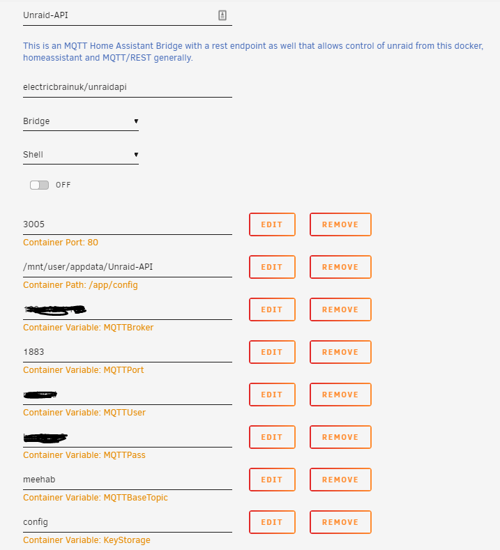

Here's my docker config;
Hi, that all seems correct to me. I will get rid of the second log in at a later date as it's not necessary.
Are you using https for your unraid instance? If so you need to add the https:// part in the IP section. Will make this more clear in the docs.
Otherwise what information is in the logs?

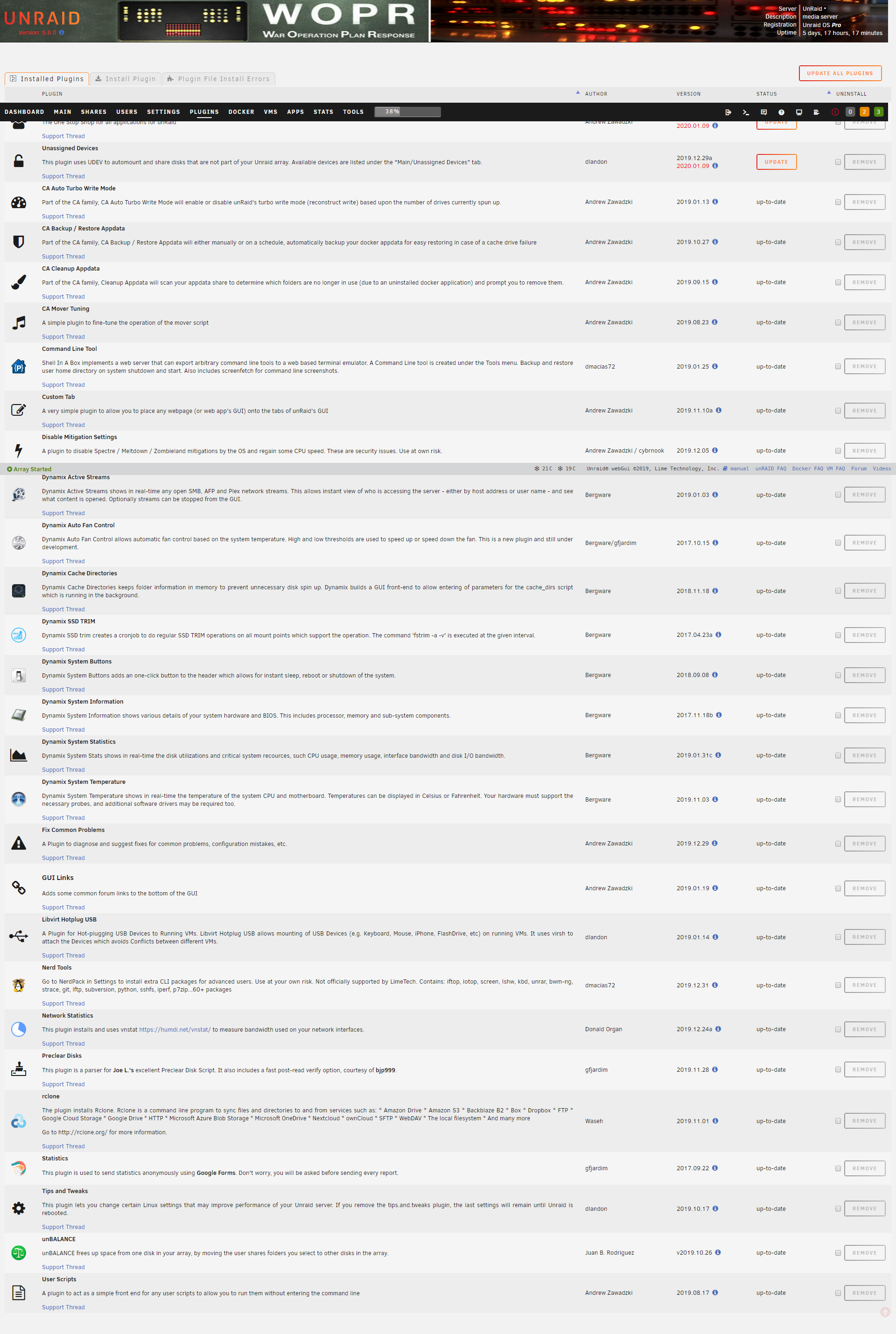

  • PlugIn list attached, nothing too unusual, I believe.
  • My unraidAPi network is configured as per screenshot in original post: Bridget, privileges off.

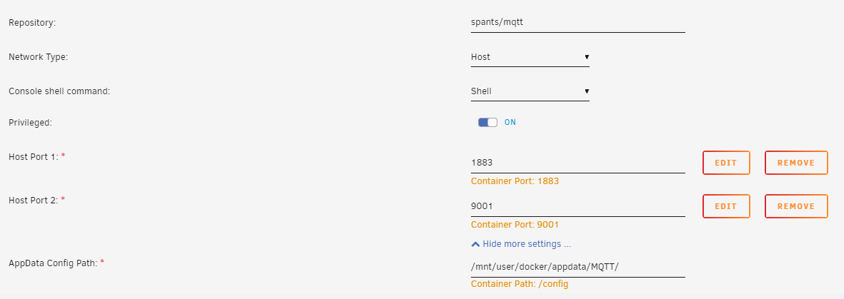

Maybe the following would have an impact?
1. My MQTT docker is configured as host;
(I'm not sure why it's set like this, I think it's the only way I could Node-Red to talk to it because....
2. My unRaid UI is running on a non-standard port (I needed to map port 80 directly to port 80 in a NodeRed docker as my Alexa LAN discovery node insists it is configurerd so)
Ahh it is probably the non standard port, if you delete your servers.json file and restart the api, then set the server up as ip:port it should work
Actually, thinking about it, the non-standard port is likely the issue? If your docker is attempting to make calls to port 80, it won't work for me.
As indicated, sometimes it's necessary to run UnRaid on an alternative port. Would you need to expose a variable for unRaid UI host port in the docker config?
OK, have it working. Many thanks!
One thing I missed after updating the server details was that I needed to login via the docker UI. I'd stopped and started unraid-API a few times as I wasn't getting the response to the MQTT request. Once I logged in, I was golden.
