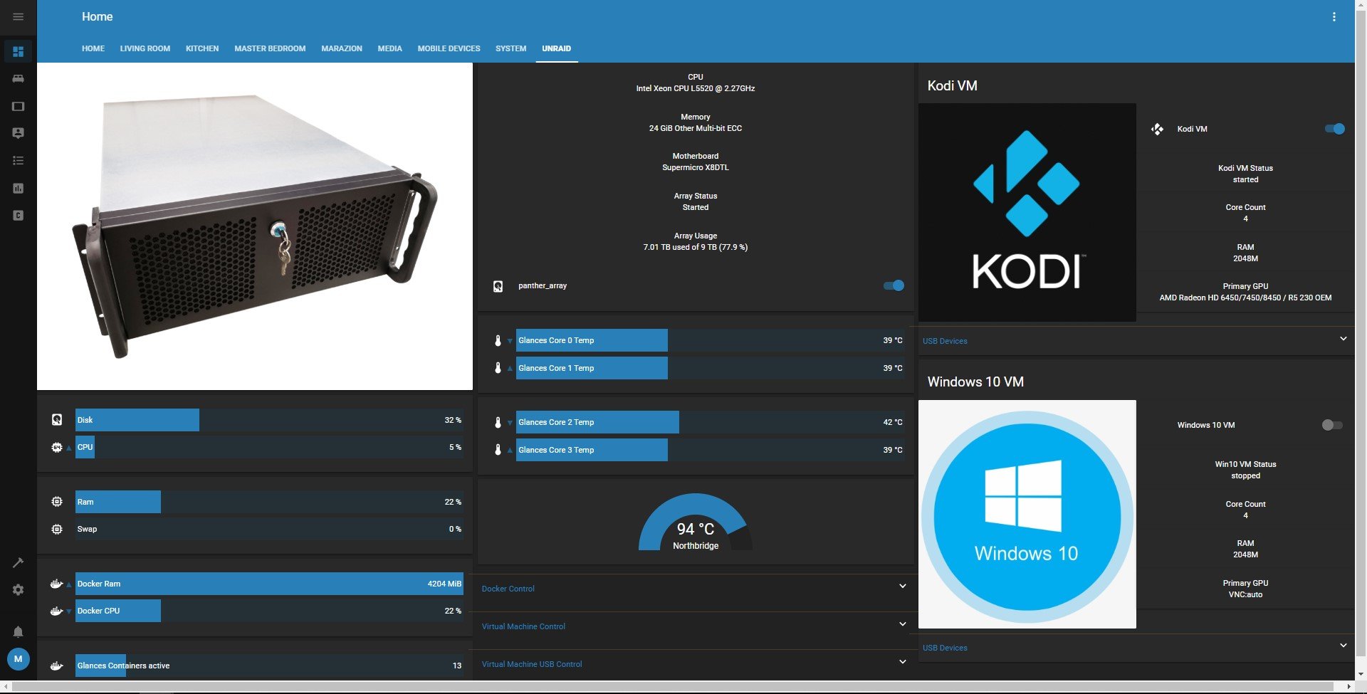

This is a great container, I got it up and running in 5 minutes and spent the next 3 days using your code to create my own version.
Some of the cards are not working with the current version of Home Assistant. But with a bit of tweaking and cheating I got the set up below.
I use this on its own tab in Panel mode.
If anyone is interested I can post the code to Github.
1 hour ago, Beaker69 said:
@ElectricBrainUK
Thanks a lot! Looks great!

On 4/6/2020 at 11:51 PM, Beaker69 said:
@ElectricBrainUK
Yes please, can i have your code... Also can i have your server image pls? I have the same and would like to use if, if i may?
I've seen this also, and would merge the 2
@skank
The image is just a stock image I pulled from a google search.
As for the code it is below and I will post it on Github within the next few hours.
Hope you enjoy it.
Any problems let me know.
cards:
  - cards:
      - hold_action:
          action: none
        image: /local/server.jpg
        tap_action:
          action: none
        type: picture
      - align: split
        card_style:
          border-radius: 5px
        columns: 2
        entities:
          - entity: sensor.glances_used_percent
            max: 100
            title: Disk
          - entity: sensor.glances_cpu_used
            max: 100
            title: CPU
        padding: 2px
        severity:
          - color: '#3bb3ee'
            value: 50
          - color: '#e7a24a'
            value: 80
          - color: '#ff0000'
            value: 100
        show_icon: true
        type: 'custom:bar-card'
      - align: split
        card_style:
          border-radius: 5px
        columns: 2
        entities:
          - entity: sensor.glances_ram_used_percent
            max: 100
            title: RAM
          - entity: sensor.glances_swap_used_percent
            max: 100
            title: SWAP
        padding: 2px
        severity:
          - color: '#3bb3ee'
            value: 50
          - color: '#e7a24a'
            value: 80
          - color: '#ff0000'
            value: 100
        show_icon: true
      - align: split
        card_style:
          border-radius: 5px
        columns: 2
        entities:
          - entity: sensor.glances_containers_ram_used
            title: Docker RAM
          - entity: sensor.glances_containers_cpu_used
            max: 100
            title: Docker CPU
        padding: 2px
        severity:
          - color: '#3bb3ee'
            value: 50
          - color: '#e7a24a'
            value: 80
          - color: '#ff0000'
            value: 100
        show_icon: true
      - align: split
        card_style:
          border-radius: 5px
        columns: 1
        entities:
          - entity: sensor.glances_containers_active
            max: 100
            title: Dockers Active
        padding: 4px
        severity:
          - color: '#3bb3ee'
            value: 50
          - color: '#e7a24a'
            value: 80
          - color: '#ff0000'
            value: 100
        show_icon: true
    type: vertical-stack
  - cards:
      - cards:
          - entities:
              - entity: sensor.panther_cpu
            show_icon: false
            type: glance
          - entities:
              - entity: sensor.panther_memory
            show_icon: false
            type: glance
          - entities:
              - entity: sensor.panther_motherboard
            show_icon: false
            type: glance
          - entities:
              - entity: sensor.panther_arraystatus
            show_icon: false
            type: glance
          - entities:
              - entity: sensor.panther_diskspace
            show_icon: false
            type: glance
          - entities:
              - entity: switch.panther_array
            show_header_toggle: false
            type: entities
        type: 'custom:vertical-stack-in-card'
      - cards:
          - align: split
            card_style:
              border-radius: 5px
            columns: 2
            entities:
              - entity: sensor.glances_core_0_temp
                max: 100
                title: CPU
              - entity: sensor.glances_core_1_temp
                max: 100
                title: CPU
            padding: 2px
            severity:
              - color: '#3bb3ee'
                value: 50
              - color: '#e7a24a'
                value: 80
              - color: '#ff0000'
                value: 100
            show_icon: true
      - cards:
          - align: split
            card_style:
              border-radius: 5px
            columns: 2
            entities:
              - entity: sensor.glances_core_2_temp
                max: 100
                title: CPU
              - entity: sensor.glances_core_3_temp
                max: 100
                title: CPU
            padding: 2px
            severity:
              - color: '#3bb3ee'
                value: 50
              - color: '#e7a24a'
                value: 80
              - color: '#ff0000'
                value: 100
            show_icon: true
      - entity: sensor.glances_intel5500_1_temp
        max: 110
        min: 0
        severity:
          green: 50
          red: 90
          yellow: 75
        theme: default
        type: gauge
      - cards:
          - card:
              head:
                label: Docker Control
                type: section
              type: 'custom:fold-entity-row'
            filter:
              exclude:
                - entity_id: panther_docker_*_usb*
              include:
                - entity_id: switch.panther_docker_*
            type: 'custom:auto-entities'
          - card:
              head:
                label: Virtual Machine Control
                type: section
            filter:
              exclude:
                - entity_id: panther_vm_*_usb*
              include:
                - entity_id: switch.panther_vm_*
          - card:
              head:
                label: Virtual Machine USB Control
                type: section
            filter:
              include:
                - entity_id: switch.panther_vm_*_usb*
  - cards:
      - cards:
          - cards:
              - image: /local/Kodidark.png
                type: picture
              - cards:
                  - entities:
                      - switch.panther_vm_kodi
                    type: entities
                  - entities:
                      - entity: sensor.panther_vm_kodi_status
                    show_icon: false
                    type: glance
                  - entities:
                      - entity: sensor.vm_kodi_core
                    show_icon: false
                    type: glance
                  - entities:
                      - entity: sensor.vm_kodi_ram
                    show_icon: false
                    type: glance
                  - entities:
                      - entity: sensor.vm_kodi_primarygpu
                    show_icon: false
                    type: glance
            type: horizontal-stack
          - card:
              head:
                label: USB Devices
                type: section
            filter:
              include:
                - entity_id: switch.panther_vm_kodi_usb_*
        title: Kodi VM
      - cards:
          - cards:
              - image: /local/windows10.png
                type: picture
              - cards:
                  - entities:
                      - switch.panther_vm_windows_10
                    type: entities
                  - entities:
                      - entity: sensor.panther_vm_windows_10_status
                    show_icon: false
                    type: glance
                  - entities:
                      - entity: sensor.vm_win10_core
                    show_icon: false
                    type: glance
                  - entities:
                      - entity: sensor.vm_win10_ram
                    show_icon: false
                    type: glance
                  - entities:
                      - entity: sensor.vm_win10_primarygpu
                    show_icon: false
                    type: glance
          - card:
              head:
                label: USB Devices
                type: section
            filter:
              include:
        title: Windows 10 VM

What I did was create a test view in Home Asssitant, from there I just tried a picture entity card to make sure it works.
Make sure you it is /local/(picturename).(extension) and that the picture is in your WWW folder.
i did a test view also, with picture entity
cards:
- type: picture-glance
  entities:
    - sensor.unraid_server
  image: /local/Unraid.jpeg

Trying to fix the custom attributes card.
I think nothing is wrong with the api or the broker part.
I think its HA
i saw the attributes card was still js instead of module
i changed to module but i still get error:
create-element-base.ts:64 entity-attributes-card TypeError: Cannot add property heading_name, object is not extensible
    at HTMLElement.setConfig (entity-attributes-card.js:50)
    at s (create-element-base.ts:61)
    at c (create-element-base.ts:81)
    at u (create-element-base.ts:132)
    at Rt (create-card-element.ts:55)
    at HTMLElement.value (hui-view.ts:62)
    at hui-view.ts:295
    at Array.forEach (<anonymous>)
    at HTMLElement.value (hui-view.ts:294)
    at HTMLElement.value (hui-view.ts:222)
One question about glances...
I dont get correct glance for disk use percent
in the past, there was a disk_used_percent, but i cant see that anymore
Ok attributes card is fixed :p
I added heading_name and now its loading
