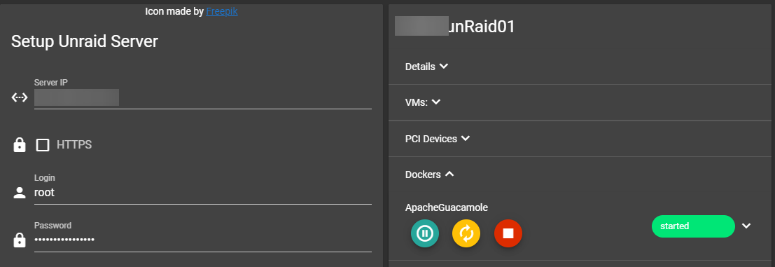

I have the exact same problem as NeepNinja (a few posts up from this one).  MQTT Mosquitto Broker is set up and working in HA with multiple Tasmota devices.  I installed the UnRaid-API making sure to fill in my HA MQTT Mosquitto IP, user and password in the Docker Template.  I also added the MQTTRefreshRate and MQTTCacheTime variables to the UnRaid API Docker Template.
Upon first start, I launched the WebUI of UnRaid API and configured my server.  After doing so, I got on new device added to my HQ MQTT for my UnRaid Server, but none of the entities are working.
In the UnRaid API WebUI my UnRaid shows up, but "On" is false and none of the VM, Dockers or Utils populate.  In the UnRaid API Log I'm getting "Request failed with status code 503".
Can anybody help me figure out what I'm missing?  Does MQTT have to be installed on both the UnRaid as a Docker and in HA?

Hey, seems I missed a few posts on this thread - sorry about that - I will answer them here:
@Keith Ellis yes you can pause the dockers /basetopic/servername/dockername/paused should do the trick
@paulmorabi I am working on a fix for the latest RC of unraid
@dbs179 & @neepninja if you are getting 503 errors in the logs the problem is between the unraid API and the unraid server. Your mqtt setup within ha seems fine. The problem could be many things, if you're using the latest RC that could cause issues which I'm working on, or if the server uses https and the API hasn't been configured to connect over https, or if your UI uses non standard ports you need to list those in the URL field, could be a simple user/password mismatch as well. Finally if you're MQTTCacheTime or MQTTRefreshTime is too fast unraid can block the API for spamming it with requests.
i hope this helps - let me know if there are further questions
Edited by ElectricBrainUK
@ElectricBrainUK Thank you.  My issue was a silly mistake, I had put the wrong password in the UnRaid API WebUI.  To be safe, I stopped the Docker, deleted the servers.json file, restarted the Docker and put in the correct credentials.  Once I did that everything came right up!
Thanks again, I appreciate it!

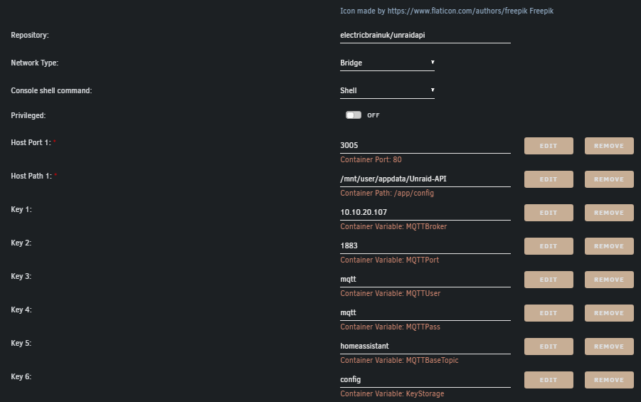

Today I have installed the unraid-api as an Home Assistant Addon. I have configured the Addon as follows:
MQTTBroker: <HA IP>
MQTTPort: 1883
MQTTUser: mqtt
MQTTPass: <password>
MQTTBaseTopic: unraid
MQTTSecure: false
MQTTSelfSigned: false
MQTTRefreshRate: 20
MQTTCacheTime: 60
KeyStorage: config
After I start the Addon i get the following error and I have no idea how i can do the first api call manually to generate the keys.
Error: ENOENT: no such file or directory, open 'config/mqttKeys'

The secure keys for mqtt may have not been generated, you need to make 1 authenticated request via the API first for this to work
Any hints or tipps?

Hey,
You do that via the web interface, open the UI and configure your unraid server. However the Home Assistant add-on is still in alpha and has some problems. The docker for unraid is more reliable if you face issues.
Ok could establish an connection via the webui. But i will get still this error:

Hello. I have the following problem. I install the Unraid-API docker on UnRaid server and everything seems to work. Home Assistant receives data from the server.
As soon as I reboot the server, the Unraid-API docker does not start and even if I start it manually it stops by itself. What could be the problem? This is the log:
