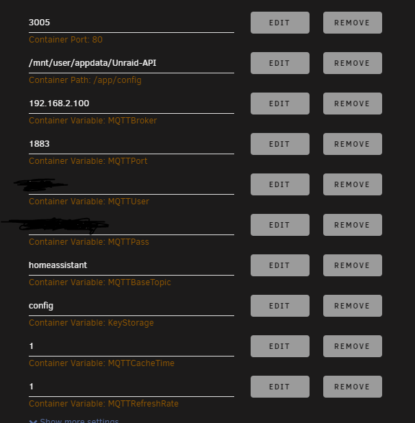

Hi all,
I use this docker container from a while now and I noticed a issue that maybe it's not related to the container because it seems no other has is.
This are my settings:

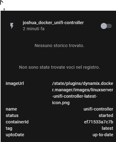

What I noticed is that it tooks more time than declared : HA tooks some time to see the status of the containers, vm etc.
Look at this picture:
status is "started" but the switch created by HA is in "off" status.
Any hint?

Hey, that is unusual, I'll take a look tomorrow as well. However I don't recommend having a mqtt cache time and refresh rate of one, you could end up spamming your home assistant and slowing it down or even crashing it depending on the spec of your home assistant box/VM
Hi both, sorry for the delay.
@Jokerigno Ive looked and I cant see why you would be experiencing this issue, the only thing I can think of is your home assistant appears to be in a language other than English, do you think it could be because my unraid api isnt playing nicely with that? Seems unlikely but it is the only thing I can think of.

Yes my system is in italian (ui) but status are always in english (on - off, true - false) and are visibile in the other language only in the frontend. I don't think it is related. Moreover I want you to notice that it's just a delay. After some time the status is updated.
Ah okay sure, just a thought. If it is just a delay then I would say it was probably because your MQTTRefreshRate variable is too fast, MQTTCacheTime is also a little fast but that shouldnt matter as much. Try setting them to at least 5.

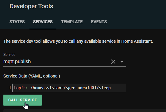

Hi  @ElectricBrainUK,
thank you for your update. I already installed the version from your beta repository. But I am not 100% sure how to use is with MQTT or the REST API. I tried it via developer tools in home assistant with the following code:
but this command did not bring the server into standby mode.
And for the REST API Call i did not know where I have to put the provided code example. Could you please provide some more in depth details? Sorry I am a total newbie in this subject.

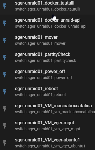

Reboot, Restart and so on has switches in home assistant:

Hey, sorry for the delay - you don’t need to worry about the REST one using home assistant. Could you try updating again and trying again with the mqtt command now? Could you also let me know if there is anything unusual in the logs after you run the command?

Thank you for your reply, i assume, there must be any error on my site firing the mqtt command. Because there is nothing in the logs after i have issued the command. But when I trigger one of the docker switches it will work perfectly fine:
> [email protected] start
> cross-env NUXT_HOST=0.0.0.0 NODE_ENV=production node server/index.js
WARN mode option is deprecated. You can safely remove it from nuxt.config
READY Server listening on http://0.0.0.0:80
Connected to mqtt broker
Received MQTT Topic: homeassistant/sger-unraid01/binhex-lidarr/dockerState and Message: started assigning ID: MQTT-R-kkx2p44f
MQTT-R-kkx2p44f succeeded
Received MQTT Topic: homeassistant/sger-unraid01/binhex-lidarr/dockerState and Message: stopped assigning ID: MQTT-R-kkx2qvab
MQTT-R-kkx2qvab succeeded
So maybe I have to alter the command? On the mqtt manual from homeassistant there is mentioned that the payload is nessecary?
https://www.home-assistant.io/docs/mqtt/service/
Sorry that I am not a big help so far 😞

Ah you’re right, the command I gave you is wrong, there should be no / before homeassitant. Thank you for your help, I appreciate it, there is no need to apologise these things often take time to work out the teething issues and by helping me test you are being very helpful.

Hm it still seems that no command will reach the unraid server.
Ah yeah there was a bug, I’ve pushed a fix if you could try again that would be great
