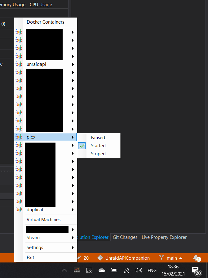

@ElectricBrainUK Hey mate, thanks for your work on this.
I'm writing a small Windows system tray companion app for quick stop/starting/pausing of containers and VMs using your API but I would like to request a possible change if you're open to it?
The problem I have is the icons for Containers and VMs on the Unraid server aren't accessible by the Windows user running the application, what would solve it is if we were able to store the icons inside your API and make them accessible through it, something along the lines of download them when the getServers method is called and store them in the same folder structure inside the UnraidAPI Container and then provide this URL in the json.
I've added a screenshot to give you and idea of what I'm talking about where I'm using a dummy icon where the actual icon would be.
I've also just noticed I have a typo in stopped haha.
Edited by Trozmagon

Hey,
Thanks and also great idea, looks good! I love to see others doing work with the API and this looks like it'll be very useful
I'm happy to help with the images, but instead of downloading them I could just proxy the unraid versions right? Unless you think that'll cause an issue?
Good spot on the typo, I'll have a look at fixing it but I don't want to break anyone's automations that are already based on the typo, whoops :P

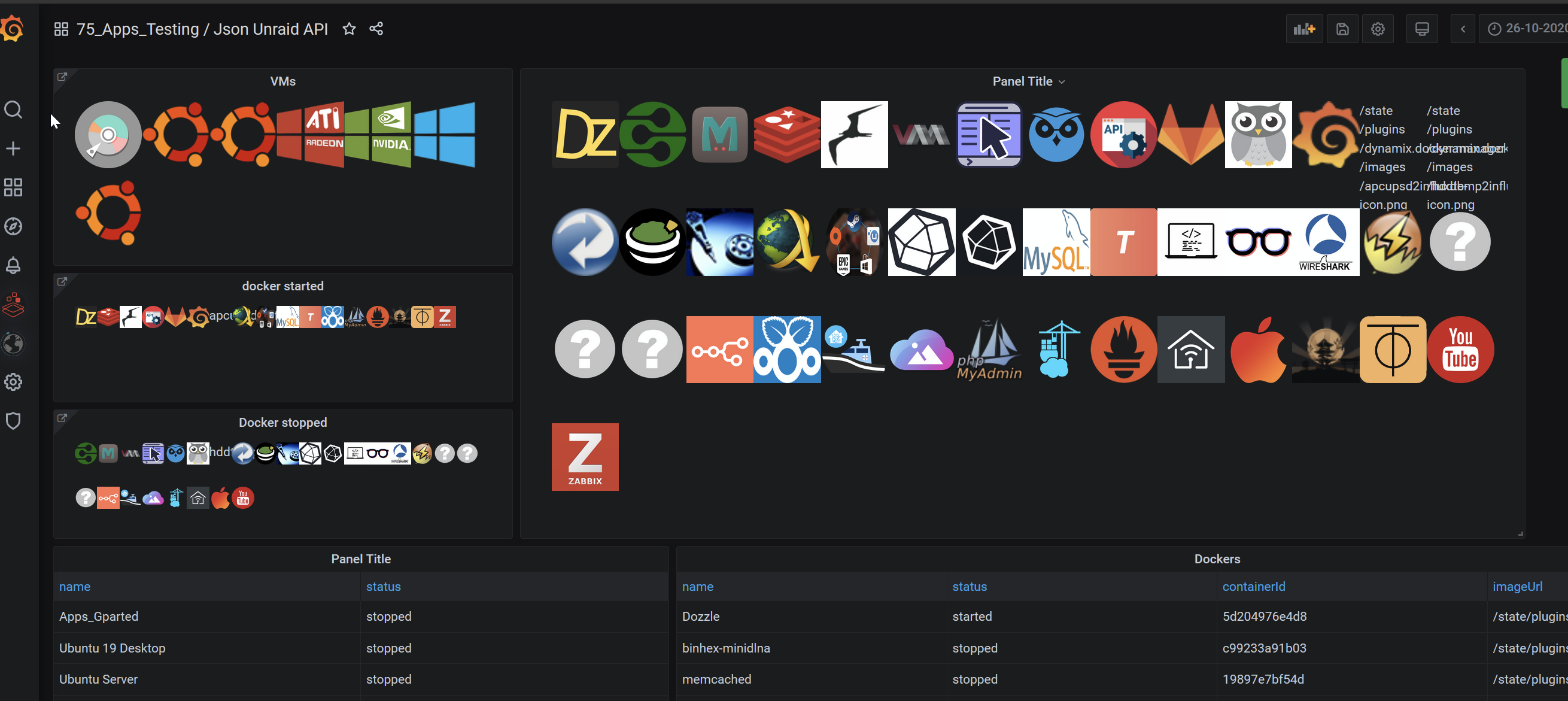

I'm using your API to display and control VMs/Docker from inside of Grafana (with json api datasource and dynamic image plugin). This change helped a lot.
There is one small problem, if vms/docker has no icons. (as you can see in the screenshot)
May it be possible to get a default icon, if there is no icon given? The image plugin I'm using in grafana cant do this.
The bigger Problem is, if grafana runs via a https url, it can't show the icons because of security Mixed content. The API Data gets fetched without problems in the background. It's only the frontend. This could be solved by an proxy. Or do you have plans to provide your api via https?
And a second kind of feature request unrelated to the above. Could you report the progress of the parity check and mover? This would be very helpful.

Hey,
As for default image I don't see why not, I'll look into it.
I currently have no plans to provide a https end point so I would recommend using a proxy for now.
I will also look at adding progress for the parity check and mover, shouldn't be a massive change.
Let me know if there is anything else

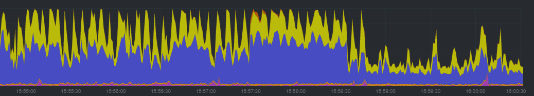

I updated to 6.9.1 and noticed that when container is on I have a more intense CPU use.
Look below
At left when container is on. On the right when it is switched off.
I'm the only one who noticed it?

That is quite intense, what is your Cache and Refresh rate at the moment? Ill look into it but in the meantime slowing those down should calm it down.
Also cheers for the heads up on the HA thing

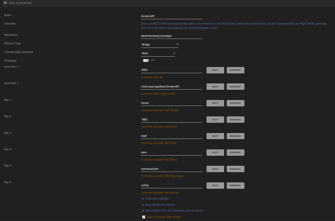

I rebuild the container and found a new template. In this one there are not variable as reflesh and cache.
Look:

I would say a 40-50%. I noticed that the MQTT settings for user and pass are uncorrect it is not present (even if my overall cpu is more intense with this new release. I'm thinking to dowgrade.
Okay sure thanks

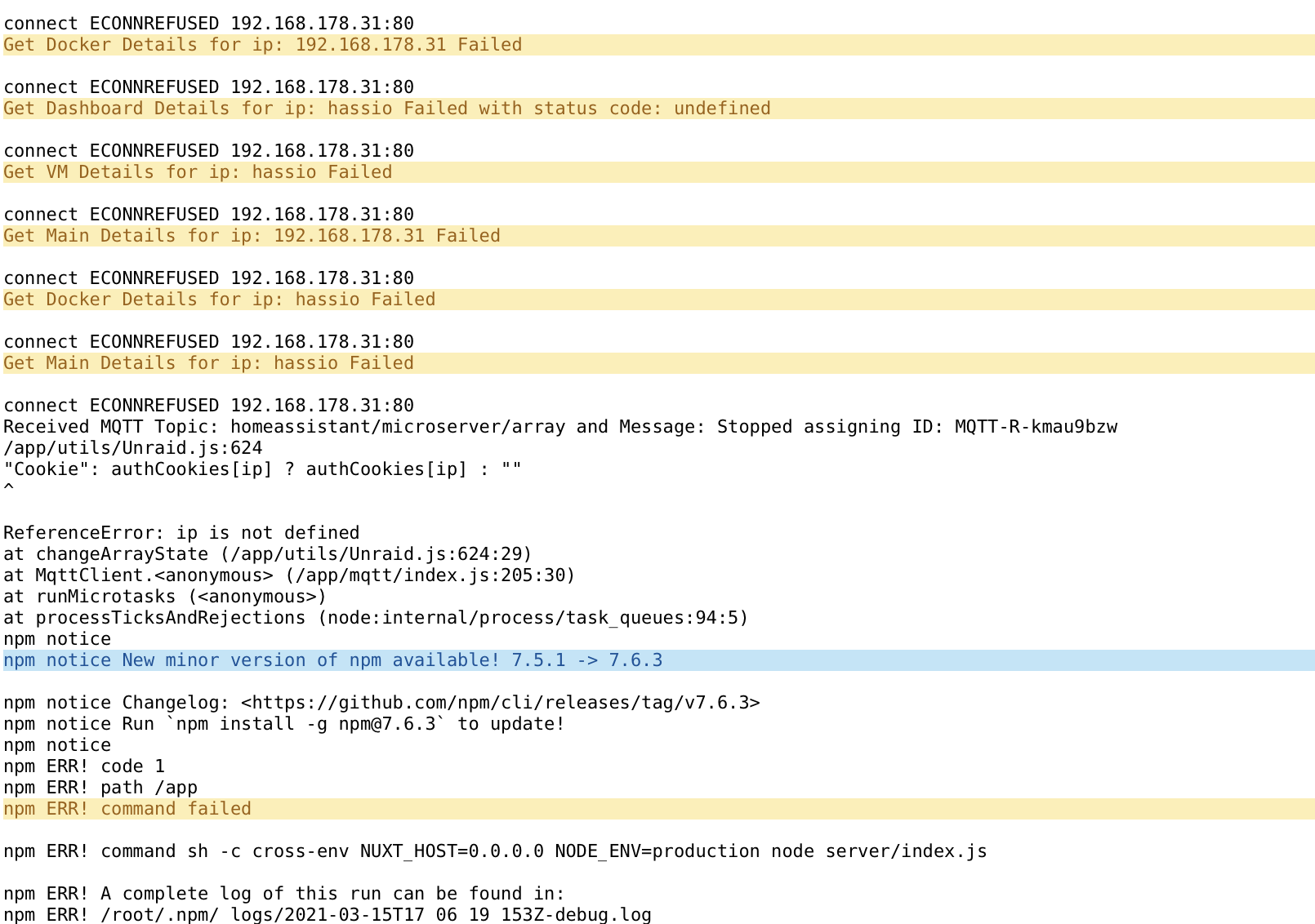

1057456982_Screenshot2021-03-15at18_28_36.thumb.png.edd8c835392247acd42b1068fdf2a07d.png
I'm far from an expert user (both Unraid and HA), but would be great if I could get this up and running. I think I'm close and not willing to give up yet.
HA (including working MQTT broker) is running on a different device. The MQTT broker discovers the Unraid entities. When I try to stop the Unraid array from HA, the docker crashes and this is the docker log (after crash).
I am very grateful for your thoughts on the point(s) I'm missing here.
Thanks a lot for the great work on this docker!
Hey, sure that is odd I've not seen that before. Can you control the server via the unraid apis ui?
