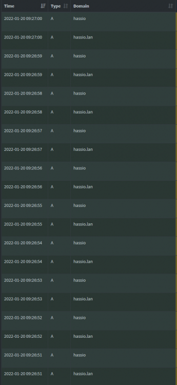

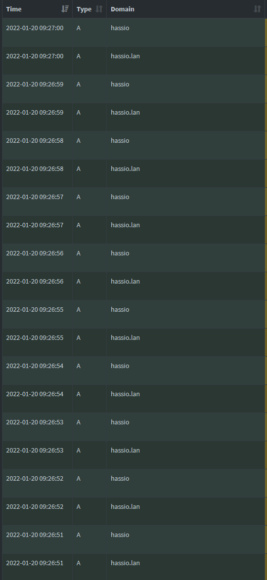

Hello and thank you for this project, it's very handy !
I have a HUGE amount of DNS query done by the docker to hassio and  hassio.lan.
around two per second :
however I am not using the project for HA, I only use it using telegraf to log the data.
How do i remove this query ?
Thanks

@LaVerte Have you got the hassio in the mqttBrokerField? If you have anything in any MQTT Environment variable field and you arent using MQTT Id delete them
