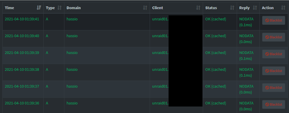

Hello,
First of all, thanks for a great plugin that opens many doors.
One question, I can see in the pihole logs that as soon as I start the container it starts querying hassio every second.
Why is that?
9 hours ago, makkish said:
Hello,
Why is that?
Hey, thanks for letting me know
It's strange, it could be a couple of things, do you have the mqtt broker configured? The default broker is hassio
Otherwise if you have entered hassio as an ip in the ui it might do that
The third option is it's a bug but I think I would've noticed myself as I also use pihole, let me double check that though!
Well, now I feel a bit stupid. Of course I had it in the configuration, I did not think of what it meant when I installed it the first time.
I removed everything with MQTT/HomeAssistant and the queries stopped.
Thank you!
