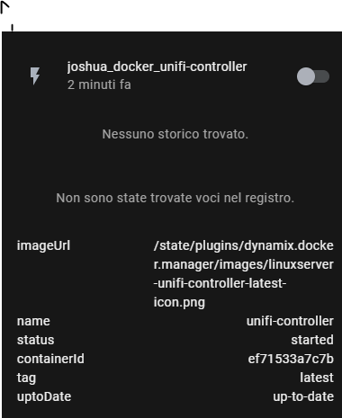

Hi @Damix21can you please share your working settings? I have the same issue!
Moreover I noticed that switch status and sensor status are different
It is a bug @ElectricBrainUK ?
Edited by Jokerigno
Hey, that is unusual - was this configured automatically or manually?
I just added the docker in my unraid and connected it to my mqtt broker...
