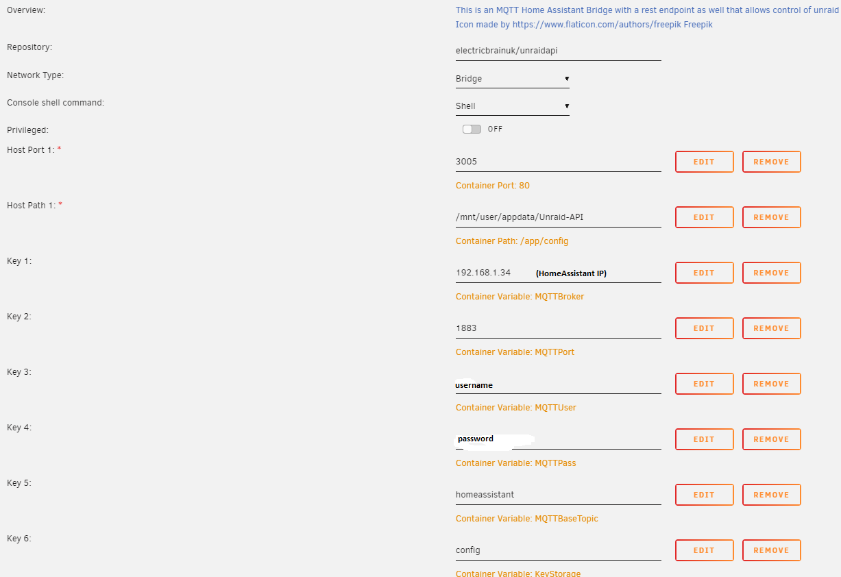

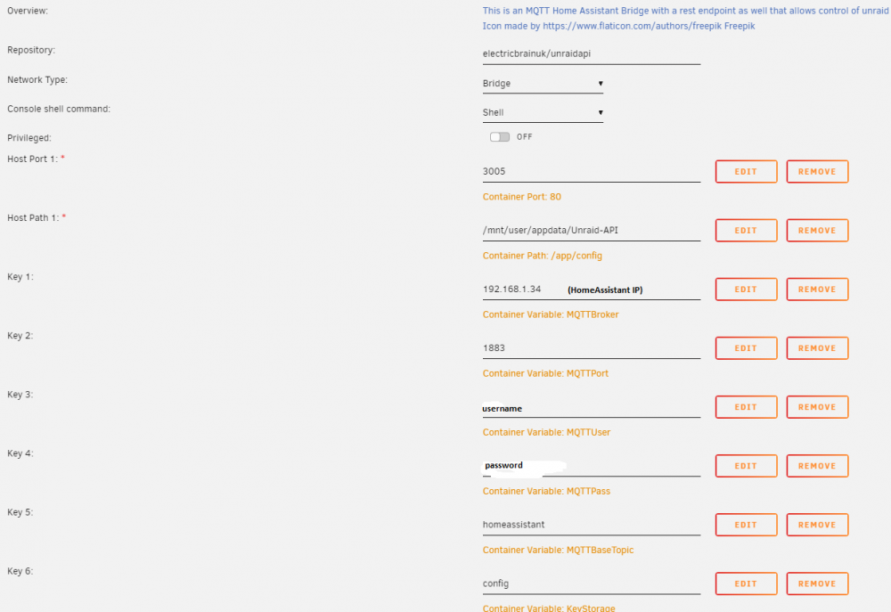

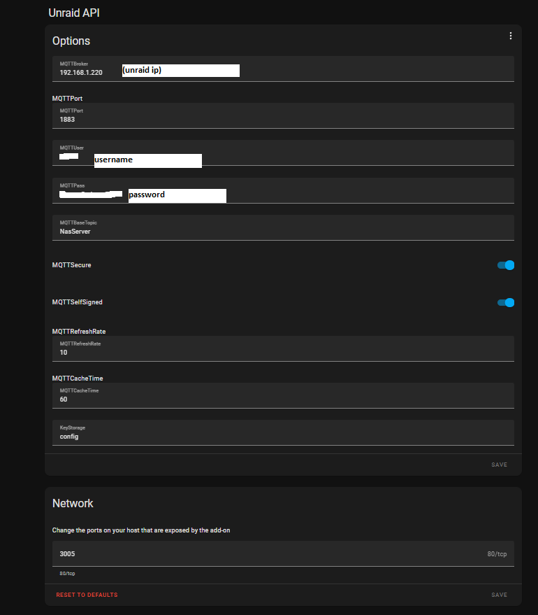

Hi everyone.
I'm trying to setup everything iot be able to monitor my unraid server on my homeassistant.
Home Assistant runs as a vm on unraid.
I hame made all the configs but I'm getting some errors.
I am attaching some pictures of my settings and the error.
Please advice
Regards Nick

On 5/2/2022 at 6:42 PM, MrLinford said:
@ElectricBrainUK Any idea what could make the above happen?
As you mentioned you should be using the hashed url not the ip - the host unreachable error suggests to me that you have the unraid api on a custom bridge on the same machine as the unraid box itself? Unraid does not allow custom bridged dockers to reach the host.
On 5/9/2022 at 12:07 PM, nt7561 said:
Hi everyone.
Please advice
Regards Nick
It looks like you have this set up in both home assistant and unraid? You only need the api in one or the other - I would recommend using the unraid one as the home assistant one is unreliable and outdated. It also looks like youre hosting the mqtt broker on home assistant - assuming that is all set up correctly with auto discovery and the unraid api is configured to read in from the unraid server you should be good to go
Hi ElectricBrainUK.
It worked. Did exactly what you said and now works fine.
Many thanks my friend
Cheers

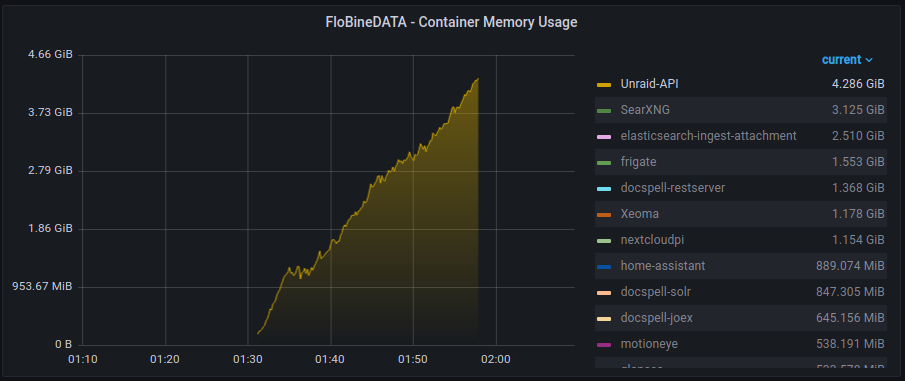

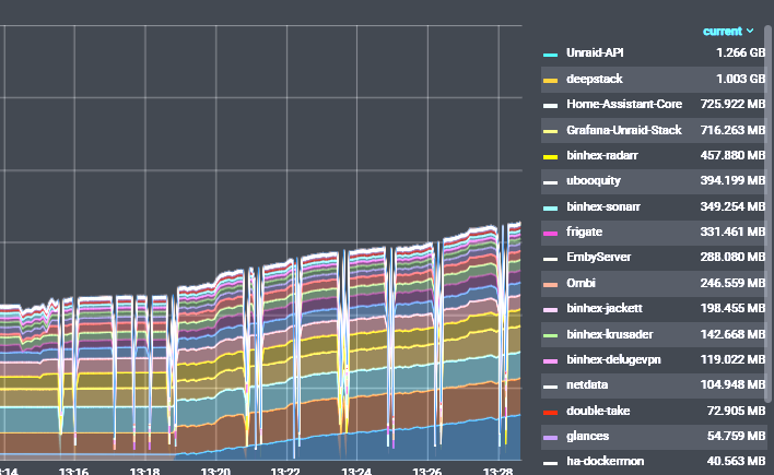

On 2/19/2022 at 9:34 PM, TRusselo said:
so why is this docker using over a gigabyte of memory?
its using more than anyother thing on my server....
same problem here....
I removed all files in appdata and reconfigured the Unraid-API adding this to the extra parameters because it slowed down my unraid server and the unraid-api container always crashed:
-e JAVA_OPTS="-Xmx2500m"
I also used the hashed url in the Unraid-API configuration and everything seemed to work as I saw my dockers, my vms and the unraid details like array, USBs.
But it still uses more than anyother thing on my server and finally crashes as before I had the "JAVA_OPTS" in the extra parameters (this picture was made before setting the java options!).

today at 11:31:55
today at 11:31:58Connected to mqtt broker
today at 11:31:59Connected to mqtt broker
today at 11:32:02Connected to mqtt broker
today at 11:32:03Connected to mqtt broker
today at 11:32:05Connected to mqtt broker
today at 11:32:06Connected to mqtt broker
today at 11:35:20Connected to mqtt broker
today at 11:35:21Connected to mqtt broker
today at 11:35:24Connected to mqtt broker
today at 11:35:25Connected to mqtt broker
today at 11:38:39Connected to mqtt broker
today at 11:38:40Connected to mqtt broker
today at 11:38:42Connected to mqtt broker
today at 11:38:43Connected to mqtt broker
today at 11:38:45Connected to mqtt broker
today at 11:41:59Connected to mqtt broker
today at 11:42:01Connected to mqtt broker
today at 11:42:02Connected to mqtt broker
today at 11:45:16Connected to mqtt broker
today at 11:45:17Connected to mqtt broker
today at 11:45:19Connected to mqtt broker
today at 11:45:20Connected to mqtt broker
today at 11:48:35Connected to mqtt broker
today at 11:48:36Connected to mqtt broker
today at 11:48:38Connected to mqtt broker
today at 11:48:39Connected to mqtt broker
today at 11:48:41Connected to mqtt broker
today at 11:48:42Connected to mqtt broker
today at 11:50:42
today at 11:50:42<--- Last few GCs --->
today at 11:50:42
today at 11:50:42[26:0x4aaa470]  1130031 ms: Mark-sweep 3995.4 (4140.7) -> 3992.9 (4138.4) MB, 86.6 / 0.1 ms  (average mu = 0.111, current mu = 0.032) allocation failure scavenge might not succeed
today at 11:50:42[26:0x4aaa470]  1130120 ms: Mark-sweep 3996.0 (4141.3) -> 3993.7 (4139.2) MB, 86.3 / 0.0 ms  (average mu = 0.074, current mu = 0.034) allocation failure scavenge might not succeed
today at 11:50:42
today at 11:50:42
today at 11:50:42<--- JS stacktrace --->
today at 11:50:42
today at 11:50:42FATAL ERROR: Ineffective mark-compacts near heap limit Allocation failed - JavaScript heap out of memory
today at 11:50:42 1: 0xb09c10 node::Abort() [node]
today at 11:50:42 2: 0xa1c193 node::FatalError(char const*, char const*) [node]
today at 11:50:42 3: 0xcf8dbe v8::Utils::ReportOOMFailure(v8::internal::Isolate*, char const*, bool) [node]
today at 11:50:42 4: 0xcf9137 v8::internal::V8::FatalProcessOutOfMemory(v8::internal::Isolate*, char const*, bool) [node]
today at 11:50:42 5: 0xeb09d5  [node]
today at 11:50:42 6: 0xeb14b6  [node]
today at 11:50:42 7: 0xebf9de  [node]
today at 11:50:42 8: 0xec0420 v8::internal::Heap::CollectGarbage(v8::internal::AllocationSpace, v8::internal::GarbageCollectionReason, v8::GCCallbackFlags) [node]
today at 11:50:42 9: 0xec339e v8::internal::Heap::AllocateRawWithRetryOrFailSlowPath(int, v8::internal::AllocationType, v8::internal::AllocationOrigin, v8::internal::AllocationAlignment) [node]
today at 11:50:4210: 0xe848da v8::internal::Factory::NewFillerObject(int, bool, v8::internal::AllocationType, v8::internal::AllocationOrigin) [node]
today at 11:50:4211: 0x11fd626 v8::internal::Runtime_AllocateInYoungGeneration(int, unsigned long*, v8::internal::Isolate*) [node]
today at 11:50:4212: 0x15f2099  [node]
today at 11:50:42Container stopped

Yeah looks like there is a memory leak - unfortuantely I dont have the time to fix it. Happy to merge pull requests if someone else has the time to look into it.

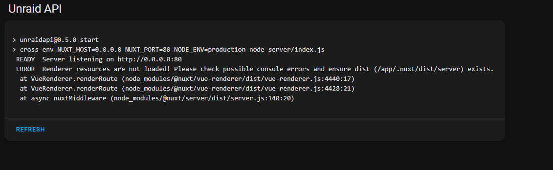

Hello, my dears,
after almost a year I thought I'd try again with the UnraidAPI. But unfortunately I still have no success.
I still get a 503 code on my one server, even though I've checked everything multiple times. Changed the root password multiple times. But nothing.
Then with my other server I don't get a code 503 but he probably can't even hear it see here
READY Server listening on http://0.0.0.0:80
Get Dashboard Details for ip: 192.168.1.59 Failed with status code: undefined
connect ECONNREFUSED 192.168.1.59:80
Get VM Details for ip: 192.168.1.59 Failed
Get Docker Details for ip: 192.168.1.59 Failed
Get Main Details for ip: 192.168.1.59 Failed
I hope you can help me there.
Regards Maggi0r
Update: I was able to fix the error with errorconnectrefused. But now I always get the ERROR CODE 503. Have already changed the root password. Or do I have to reset the password via recovery?
Greetings Maggi
Edited by Maggi0r
Update

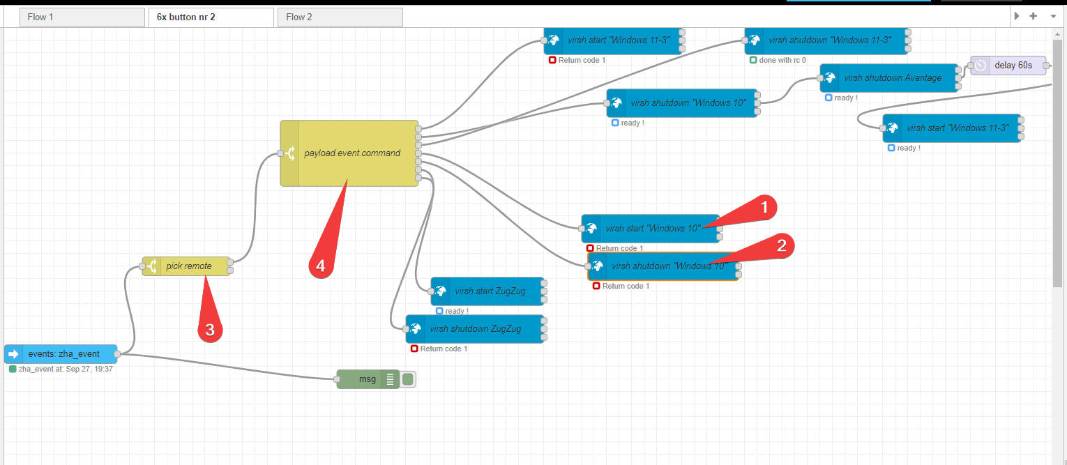

no i ditched this, and solved my problem using nodered and some zigbee buttons:
