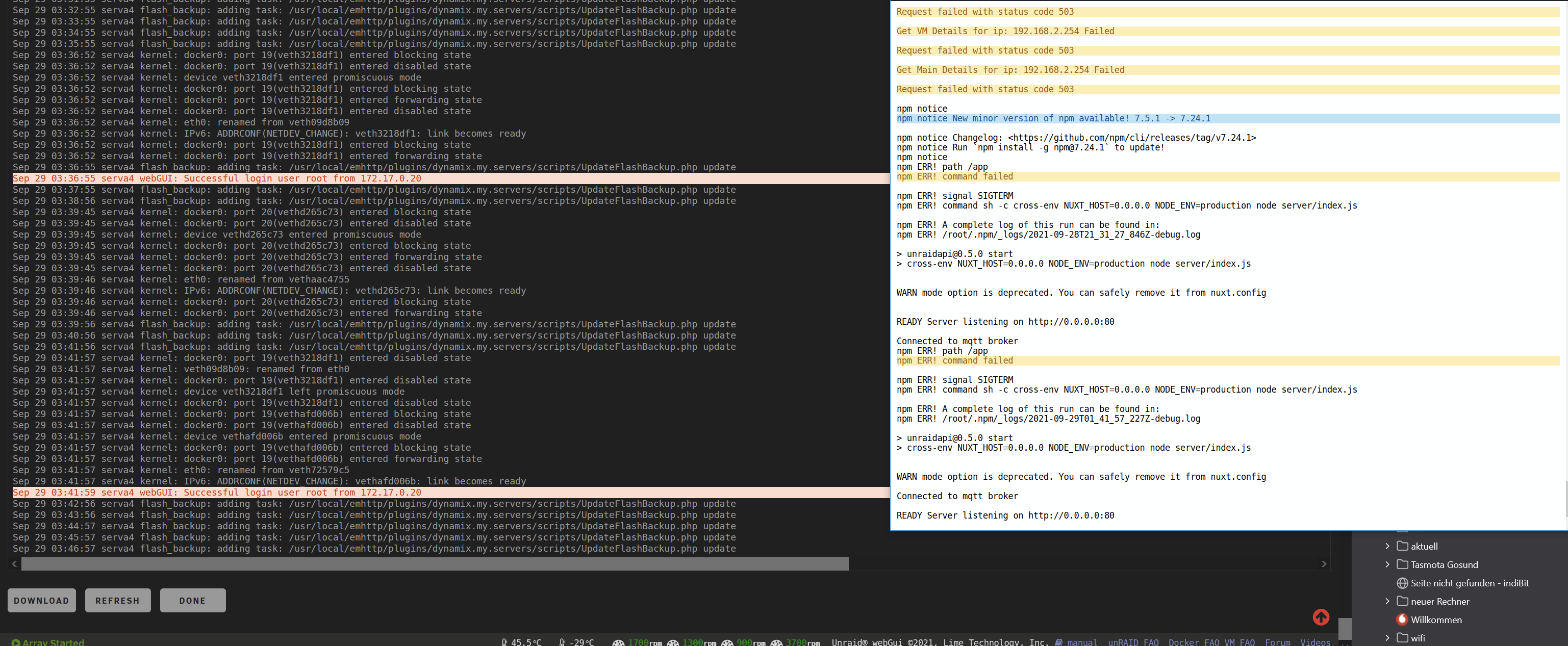

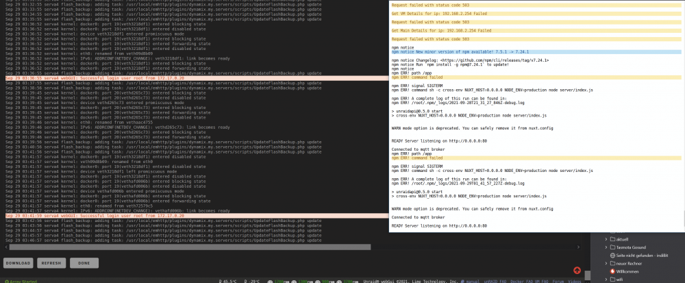

first,big thanks for this plugin, i use it with HA.
I configured everything,everything is working but i have one big problem. If i start docker container with this plugin, i get excessive writes on USB drive. I traced it and found that last updated file  is /boot/config/domains.cfg . The content of this file is not changing, with other dockers i dont have this problems. i get maybe 10000 writes/hour, this can destroy boot usb disk in short period of time. For now, i stopped it..
Anyone with the same problem? what is the cause  of this behavior? how i can stop it and use this plugin normaly?

Hi, I'm afraid I've not seen this error before and I don't know what could be causing it. Is there anything in the logs for the unraid api that is suspicious? Or the system logs when the writes are high? Otherwise there is this issue where forcing the api onto a background thread causes it to behave unusually: https://github.com/ElectricBrainUK/UnraidAPI/issues/33
Hi,  in Unraid API log is only this,i dont know if it means something but it shows when i stop this plugin, last message when is running is : Connected to mqtt broker
> [email protected] start
> cross-env NUXT_HOST=0.0.0.0 NODE_ENV=production node server/index.js
WARN mode option is deprecated. You can safely remove it from nuxt.config
READY Server listening on http://0.0.0.0:80
npm ERR! path /app
npm ERR! command failed
npm ERR! signal SIGTERM
npm ERR! command sh -c cross-env NUXT_HOST=0.0.0.0 NODE_ENV=production node server/index.js
npm ERR! A complete log of this run can be found in:
npm ERR! /root/.npm/_logs/2021-09-11T10_42_35_003Z-debug.log

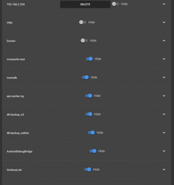

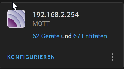

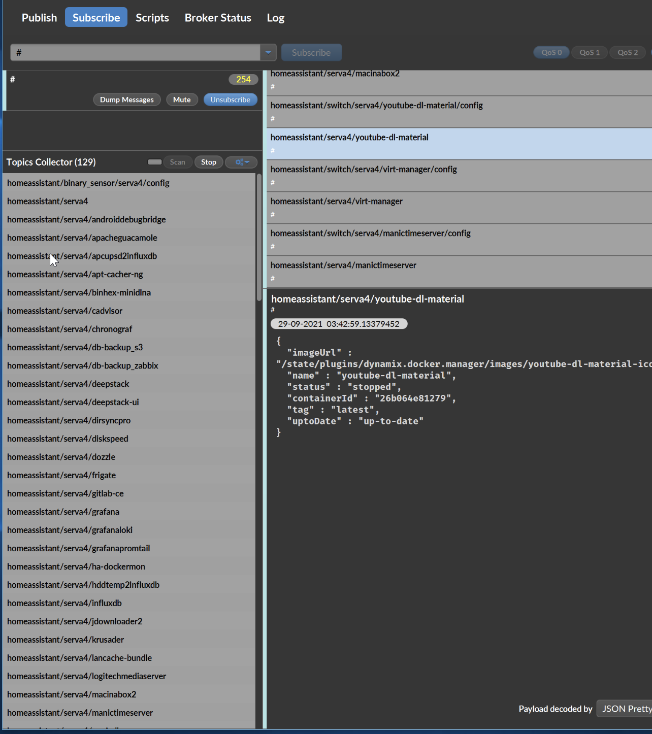

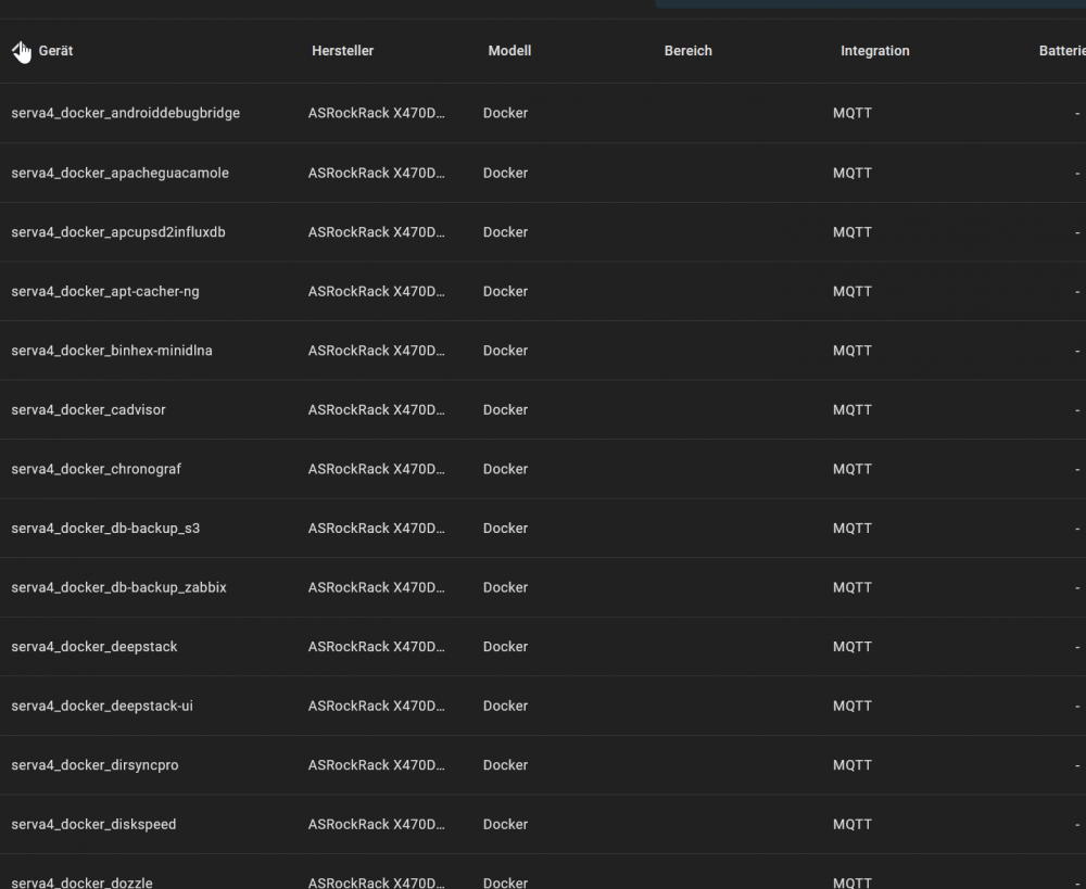

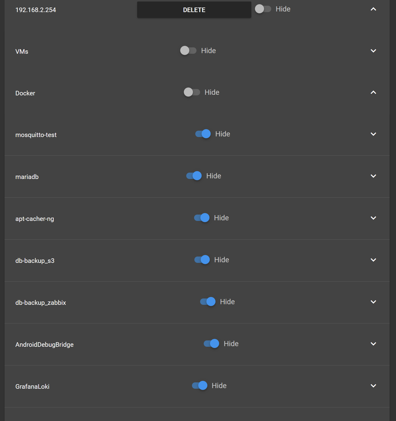

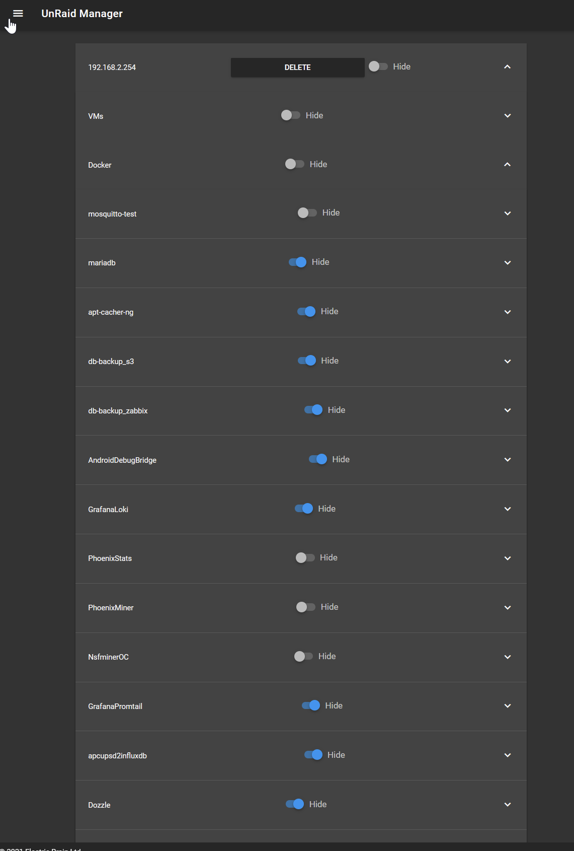

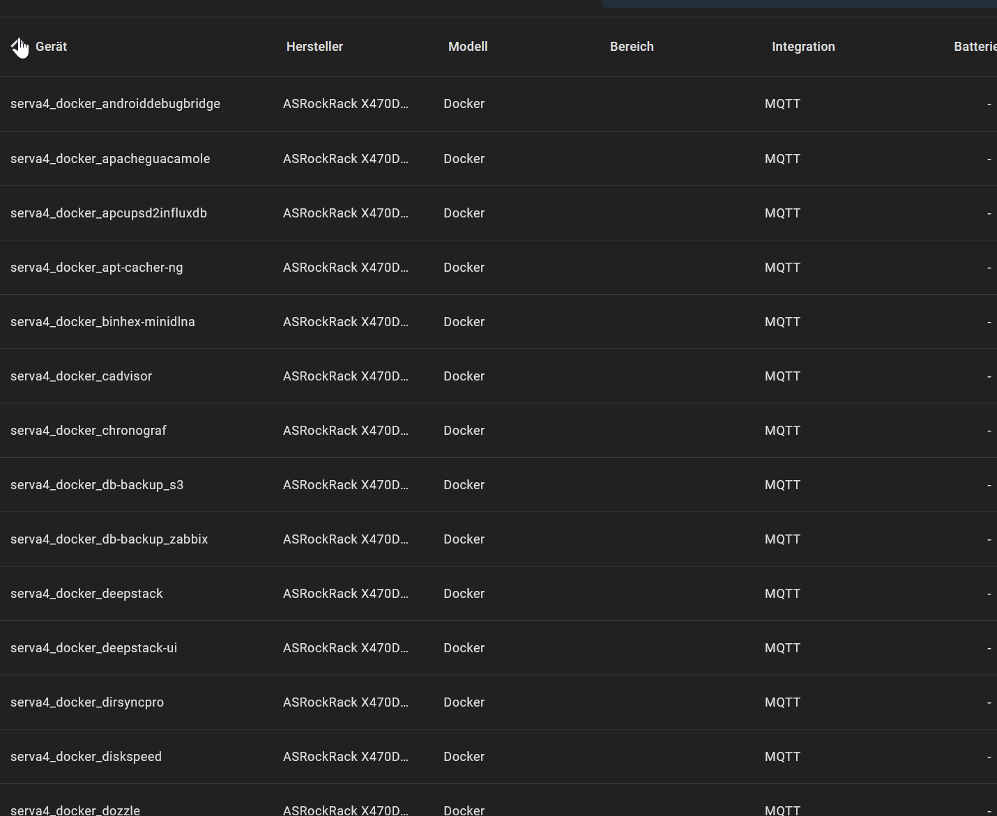

How to hide unused container from blowing up my devices list?
I have around 60 docker container, but i only need 2 of them controlled via Home-Assistant.
I disabled all containers in the manual settings
But they are shown as MQTT Devices + Entity.
So how to setup this, that i only see the both container, which are not hidden?
tnxs
tnxs
The logs from the unraid api are what I need, the error you have shared is when the request comes via mqtt however when you do it from the unraid apis ui itself the logs will not contain mqtt etc. and may give a better idea of the issue.
Once you have hidden a device from that menu you need to delete it from home assistant as it remembers old devices even once they stop sending messages
Cheers
Thanks for the quick answer..
I deleted my mqtt/ha test server, removed the unraid-api app and the appdata folder to start fresh.
But after reinstalling the app, the api cant get docker/vm data?
et Dashboard Details for ip: 192.168.2.254 Failed with status code: [object Object]
Request failed with status code 503
Get Main Details for ip: 192.168.2.254 Failed
Get VM Details for ip: 192.168.2.254 Failed
Get Dashboard Details for ip: 192.168.2.254 Failed with status code: [object Object]
I checked the login ten times, the login is 100% correct.
Are there new security restrictions in place?

The 503 error means it is failing to authenticate but there could be a lot of different reasons as to why - check your unraid server logs, it might be that because of the restarts etc the server has blocked it for too many requests, may just be worth stopping the docker over night and trying again in the morning. Otherwise there could be new security changes on the new rc but unfortunately I won't be able to check until next week as I'm going on holiday tomorrow.
One thing to check though, what is the network config for the docker itself? Is it just a port on the servers IP? Or have you bridged it its own ip? If it has its own ip it can't communicate with the host
Yeah, this must be something with the authentication.
I try again tomorrow. Thanks. :)
You was right, there was a authentication problem. Now the container can talk to unraid.
Sadly the outcomming is the same.
I have hidden nearly all docker container, but get a mqtt switch and an entity for each container.
This was a complete fresh start. Appdata and the broker db was wiped.
App and syslog are fine:
129 MQTT Topics:
API manual settings:
what do i miss here?
129 MQTT Topics:
Hmm, everything looks correct - do the mqtt topics continue to be updated? I may have to try and replicate this as the hide function has always worked in the past and I don't really know why it isn't for you sorry
