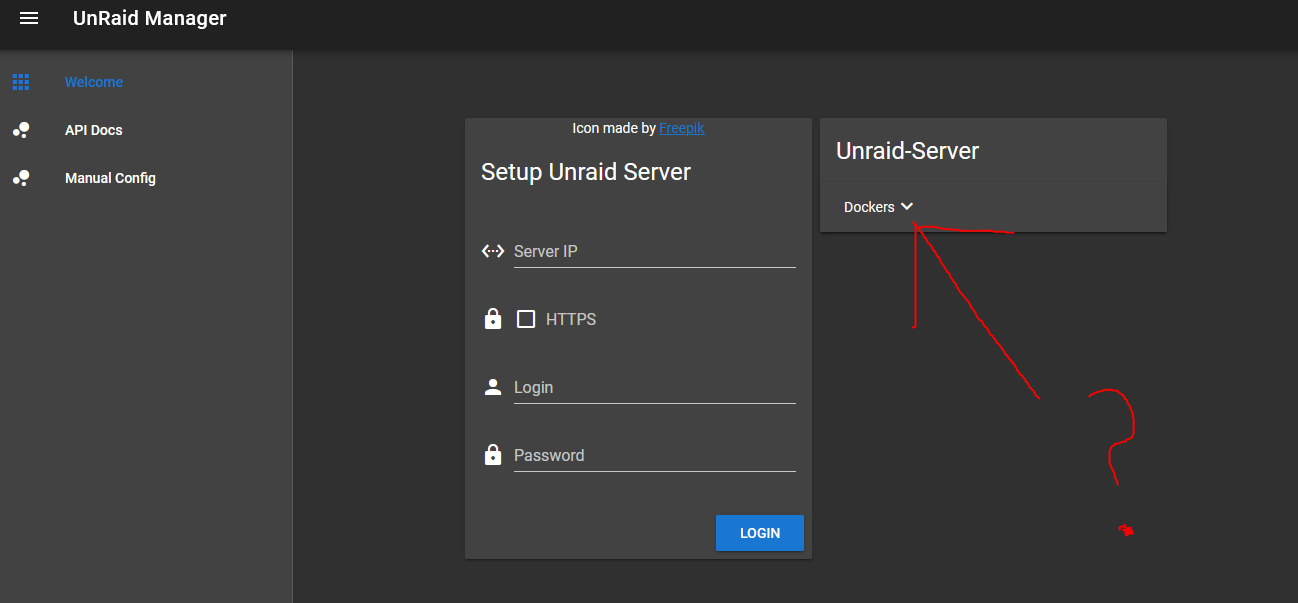

Hey everyone. I was having A LOT of the same problems with it connecting but not showing the VMs and dockers. So I uninstalled it and deleted its folder in appdata. Then reinstalled it and went to its web address. This time for the server IP address, I went to the my unraid server gui and copied that long address without the https:// and added the https port number because I have changed that long ago. So for example: server ip: "7c774ec45a66ee62fd9c99998df.unraid.net:8443". Then I selected https and continued with the root username and root password.
@atoaster Thankyou for the tip about removing https://, I didn't realize it had pre-pended that so I had a leading https://https://. Not that it is now working, I'm still getting a 503 code fail error in the log.
*edit scratch that 503 is auth and when I fixed that error, I got the children error again.
Edited by SanderScamper
Have you uninstalled the docker, removed image and delete it's folder from app data? Also, is your port still 443 or have you changed it?

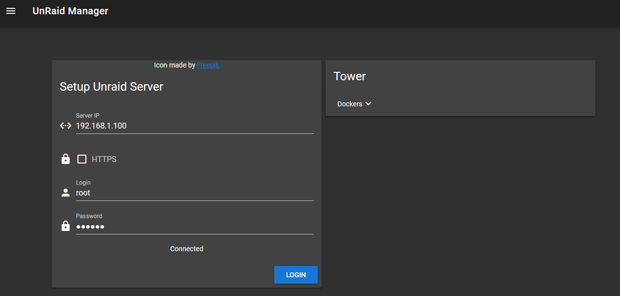

I'm having problems.
I changed my ipadress of my server running unraid api
Now i restarted the api and i want to change the ipadress and try to log in but nothing happens
i enter the ipadress , root login and pasword but i dont get anything
no error, but no progress either
any ideas?

Nevermind, fixed it by deleting app and reinstalling, couldnt reconnect with different server once connected
Fixed

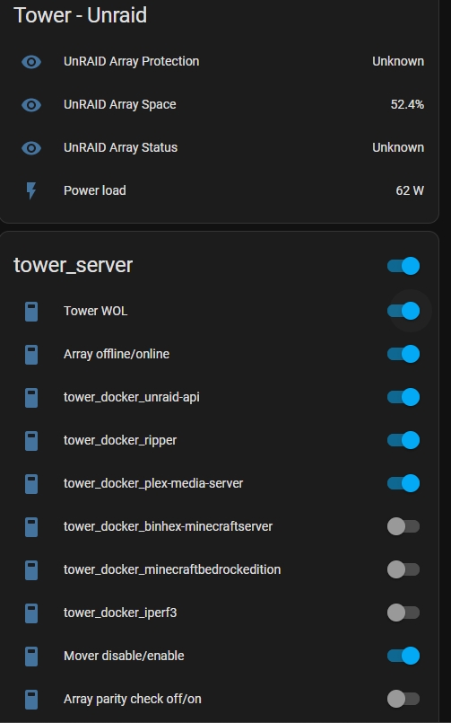

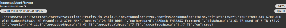

So, I have developed a problem with data gathering in Home Assistant. Bear in mind that this had been working fine, not sure if the latest HA updates or Unraid API updates broke it.
I get all of the switches for my dockers and the capacity of my array, but I have lost the data for [sensor.unraid_array_protection] and [sensor.unraid_array_status] both have become unknown in HA. Both of these sensors do populate for a split second from time to time, and then revert almost instantly to unknown in developer tools in HA. I should add that I am on 6.11.5 Unraid Plus and 2023.1.7 of HA.
The part that leads me to believe that this may be an Unraid side issues is that the API connection to my server, after login, only shows my server dockers it now does not list VMs, Utils and server status. I am still seeing the MQTT traffic from Unraid that includes the cpu type, mobo model, memory size, disk space , unraid version
It appears that from time to time the MQTT data from Uraid is correct.  And that sometimes it is truncated.

Can confirm, experiencing the same issue after connecting using the **hash.myunraid.net** and the local IP connections. All of the switches (docker, paritycheck, power_off, reboot, array) and binary_sensors.unraid_server are visible in mqtt/hass. Within the API GUI, only docker is available.
The API logs continue to repeat the same error:
Get VM Details for ip: https://192.168.1.81 Failed
Cannot read properties of undefined (reading 'children')
