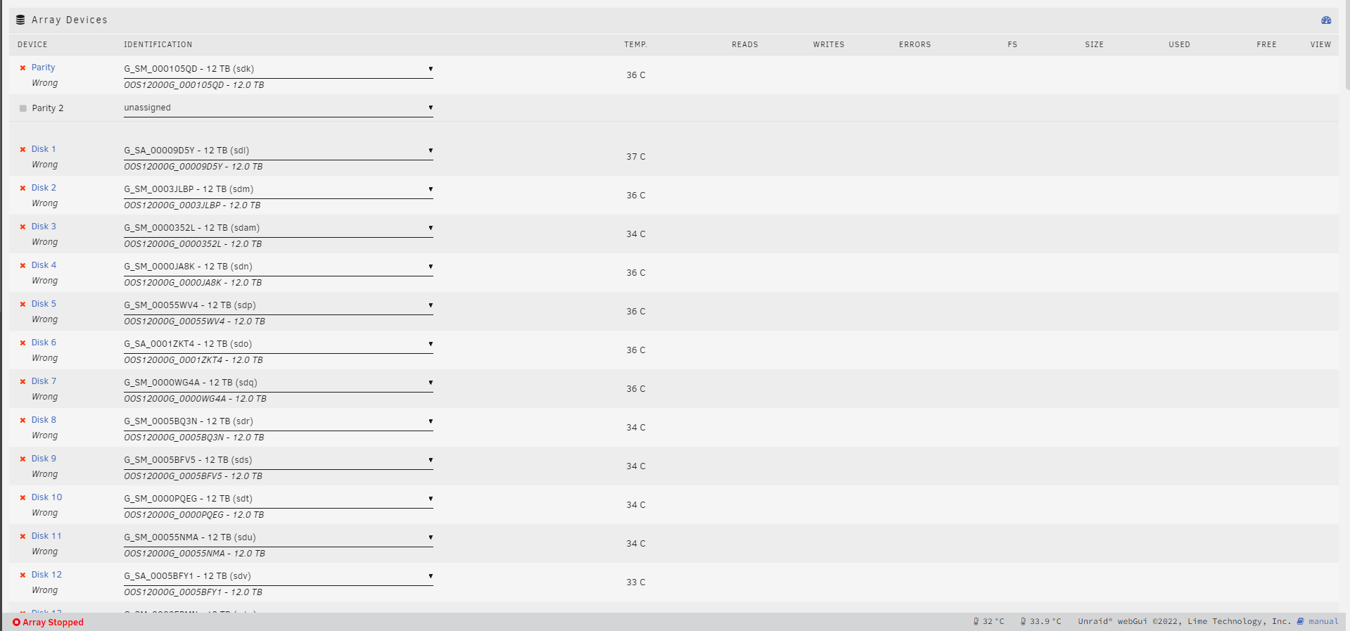

  1. Thanks I was able to fix by simply putting them back and doing a new config, I kept my cache drives but cleared everything else and then rebuilt the parity just to be safe.

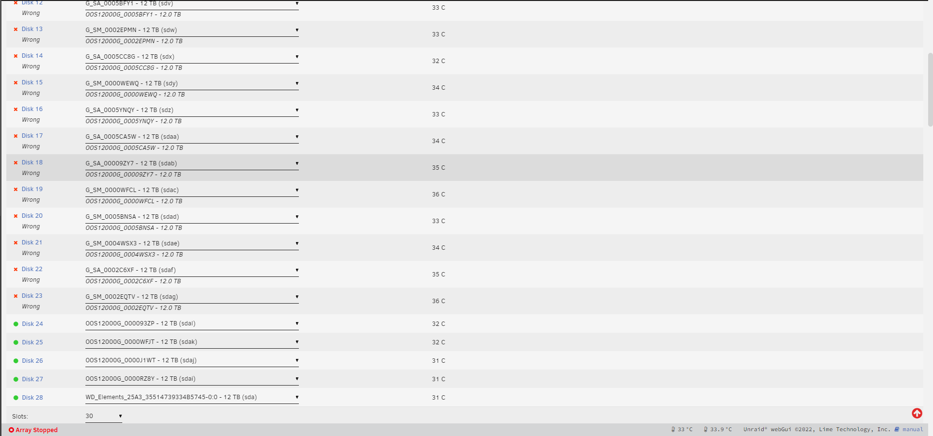

  4. As you can see in the pictures each drive ID is similar yet different than the one that's there, I really would like not to have to transfer all the data off or delete it all by accident, any help would be appreciated, the new jbod just covers the first 24 drives, so that's why the others are fine. Thanks, any help would be more than appreciated! (Also I put them on each line just to show where they should be it didn't do that by default)

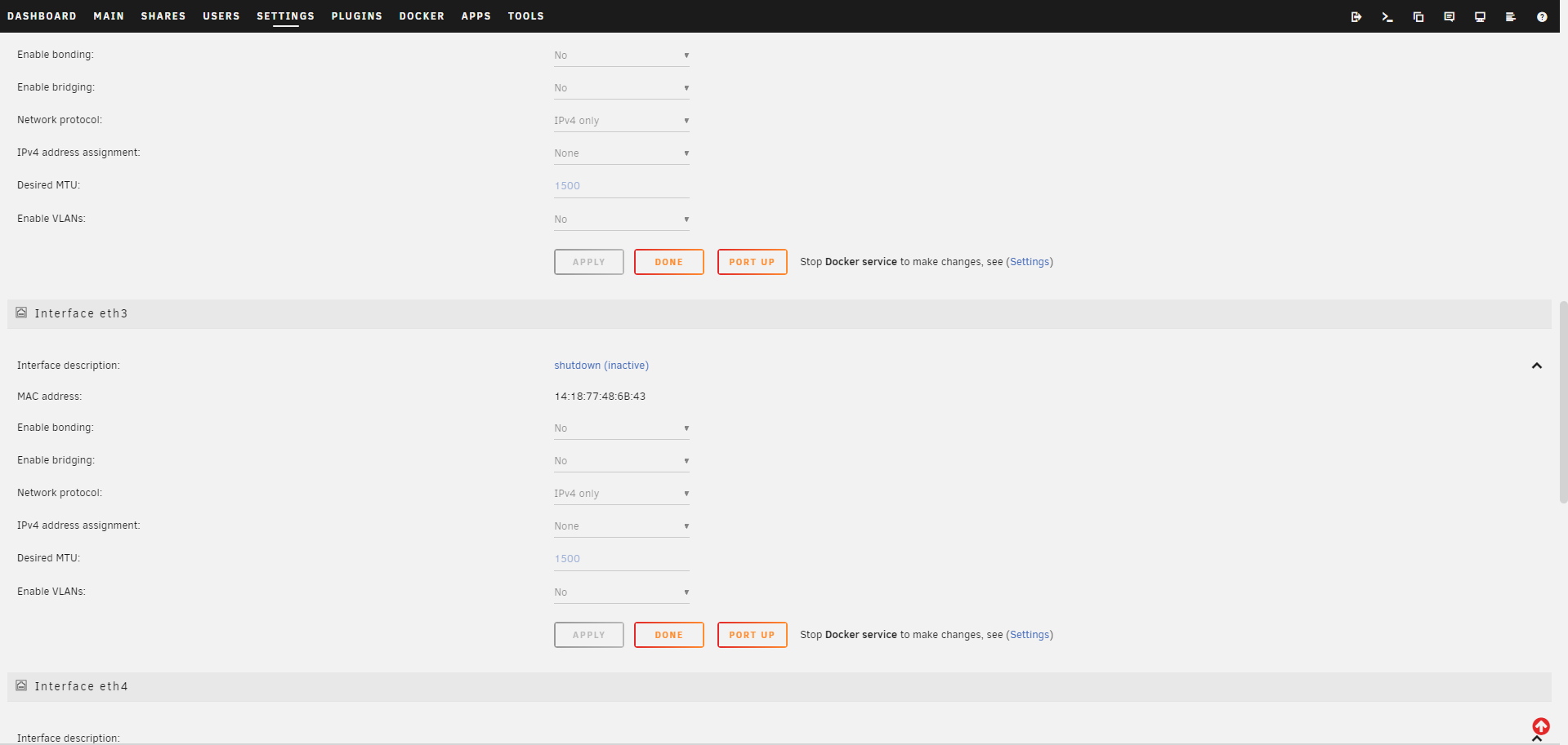

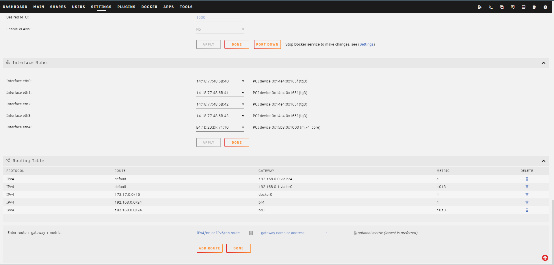

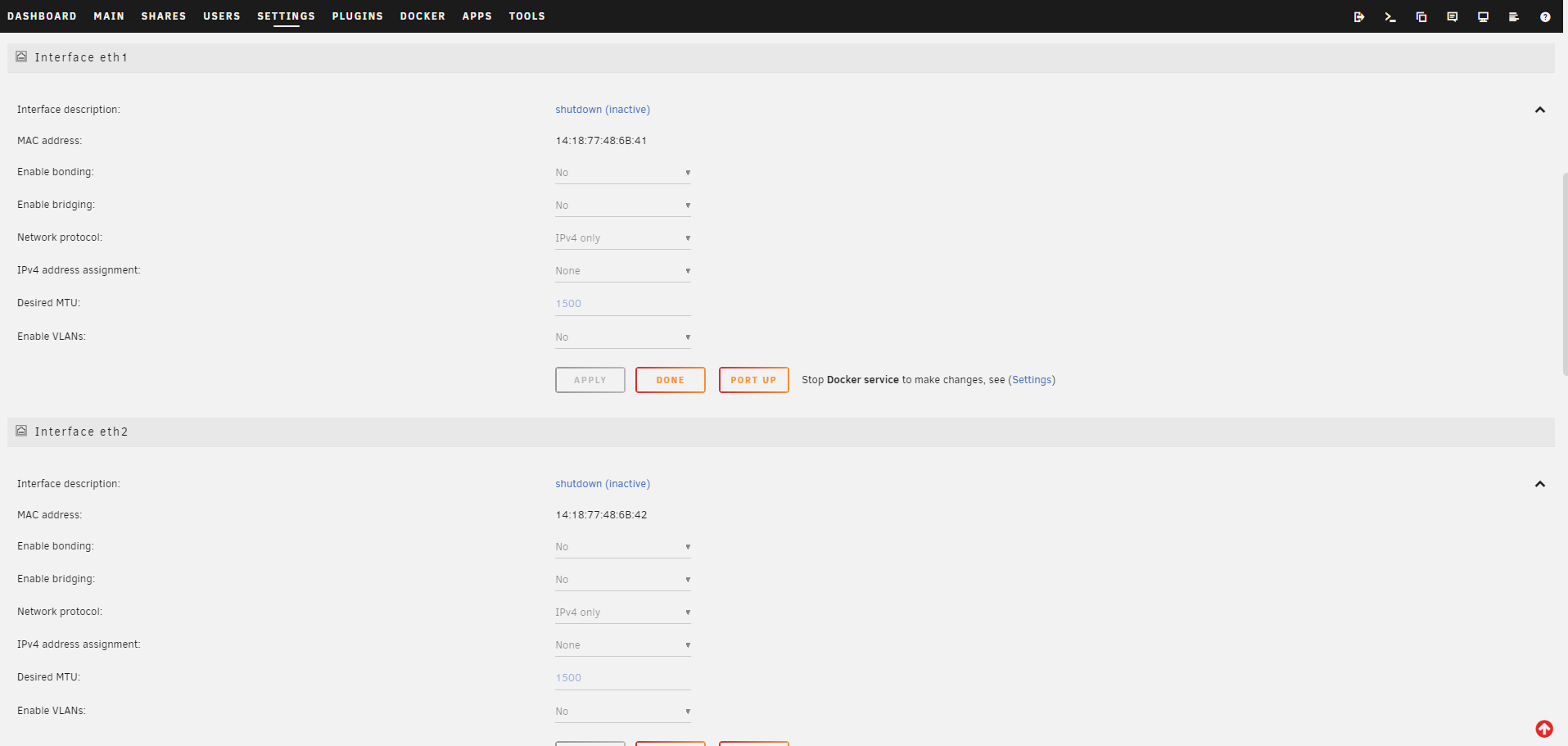

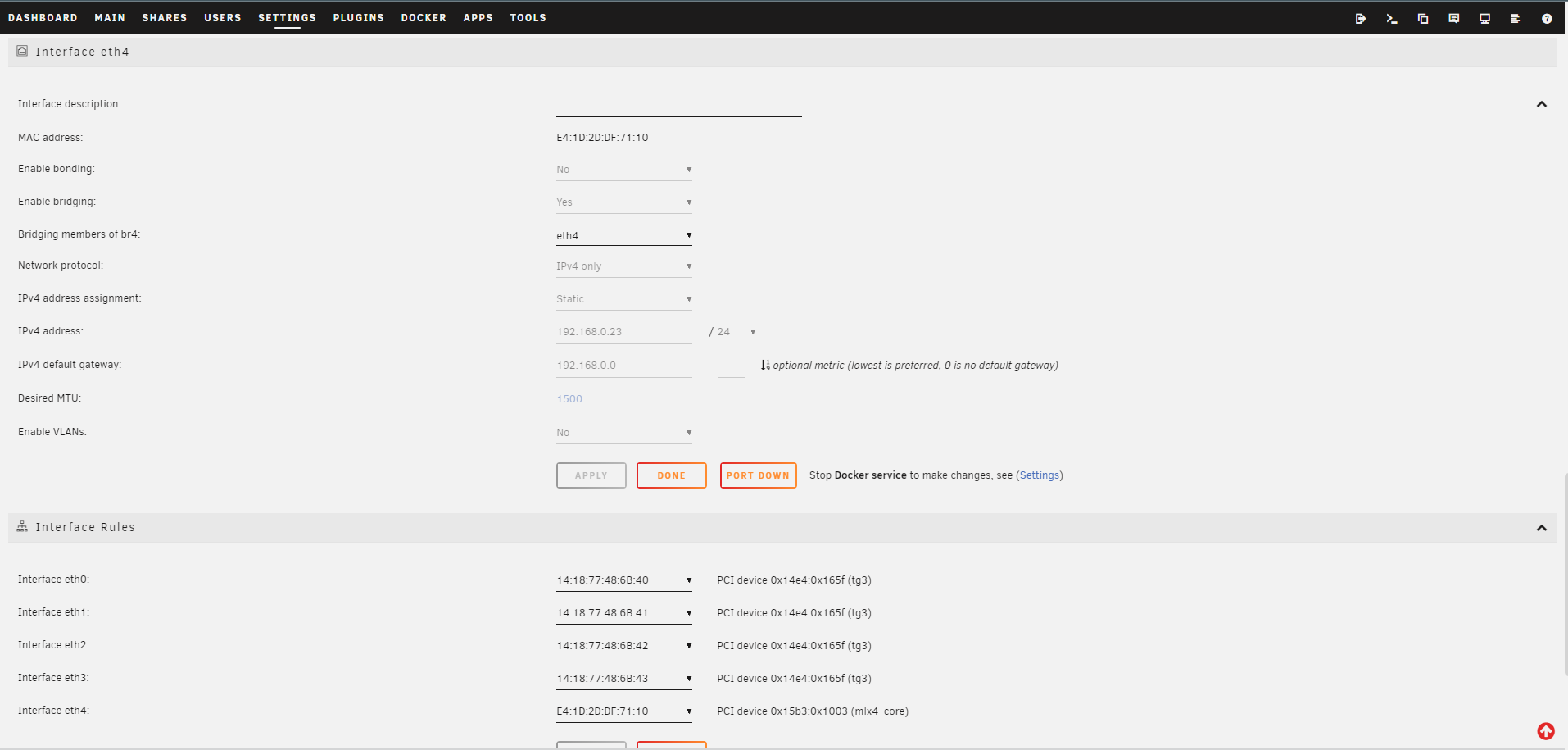

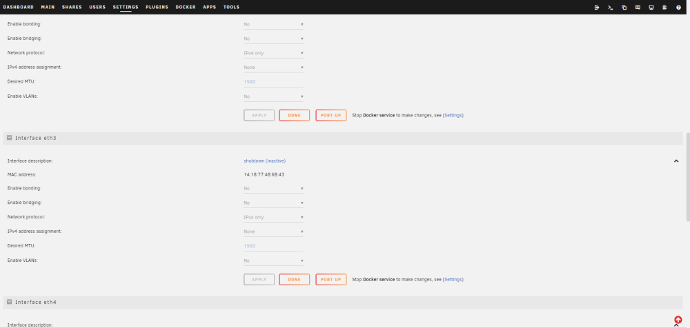

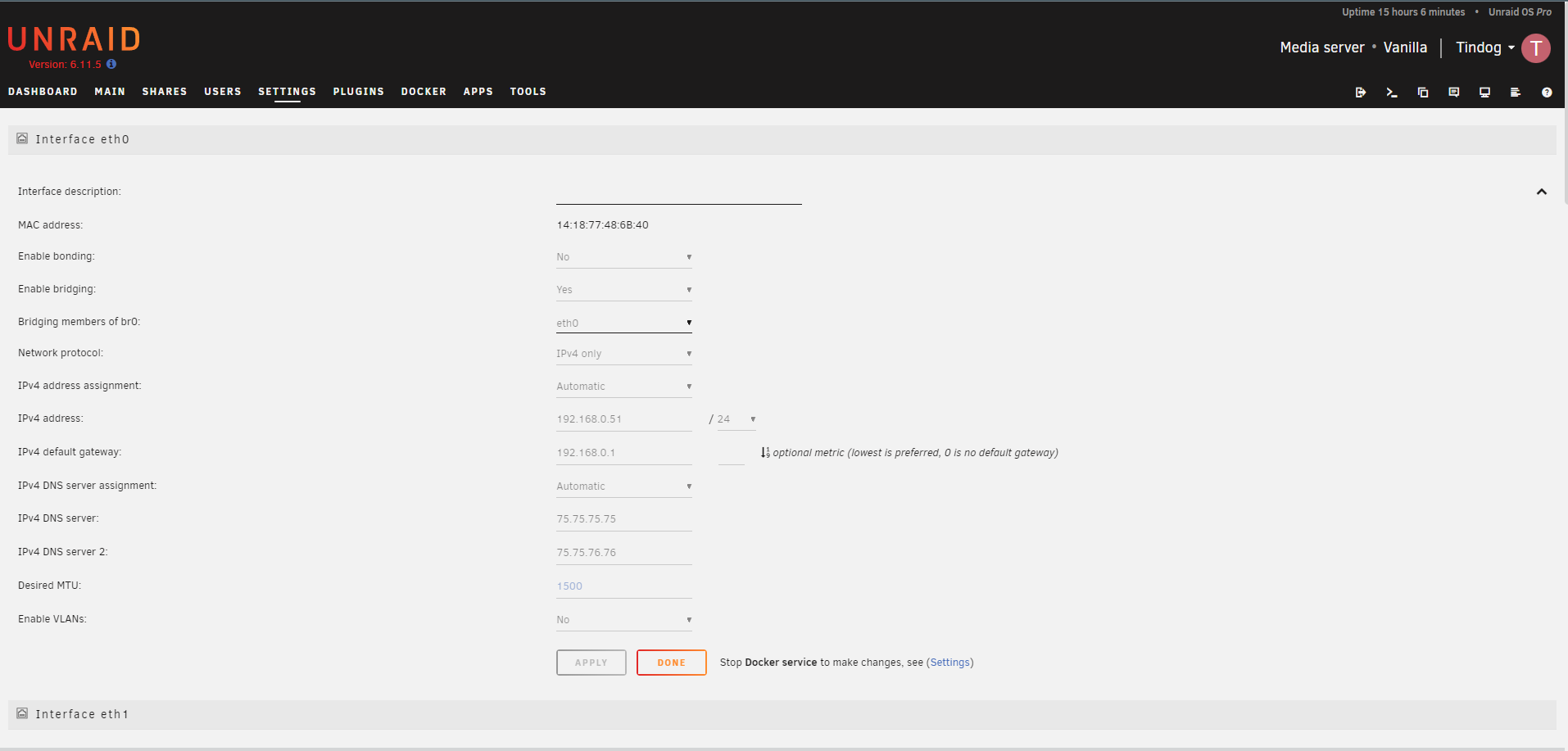

  5. Oh my gosh thank you so much, that took me WAY to long trying to figure out, but I did it, and it worked. Thank you so much! I didn't even know you could flip the eth0. That helped so much again, thank you!

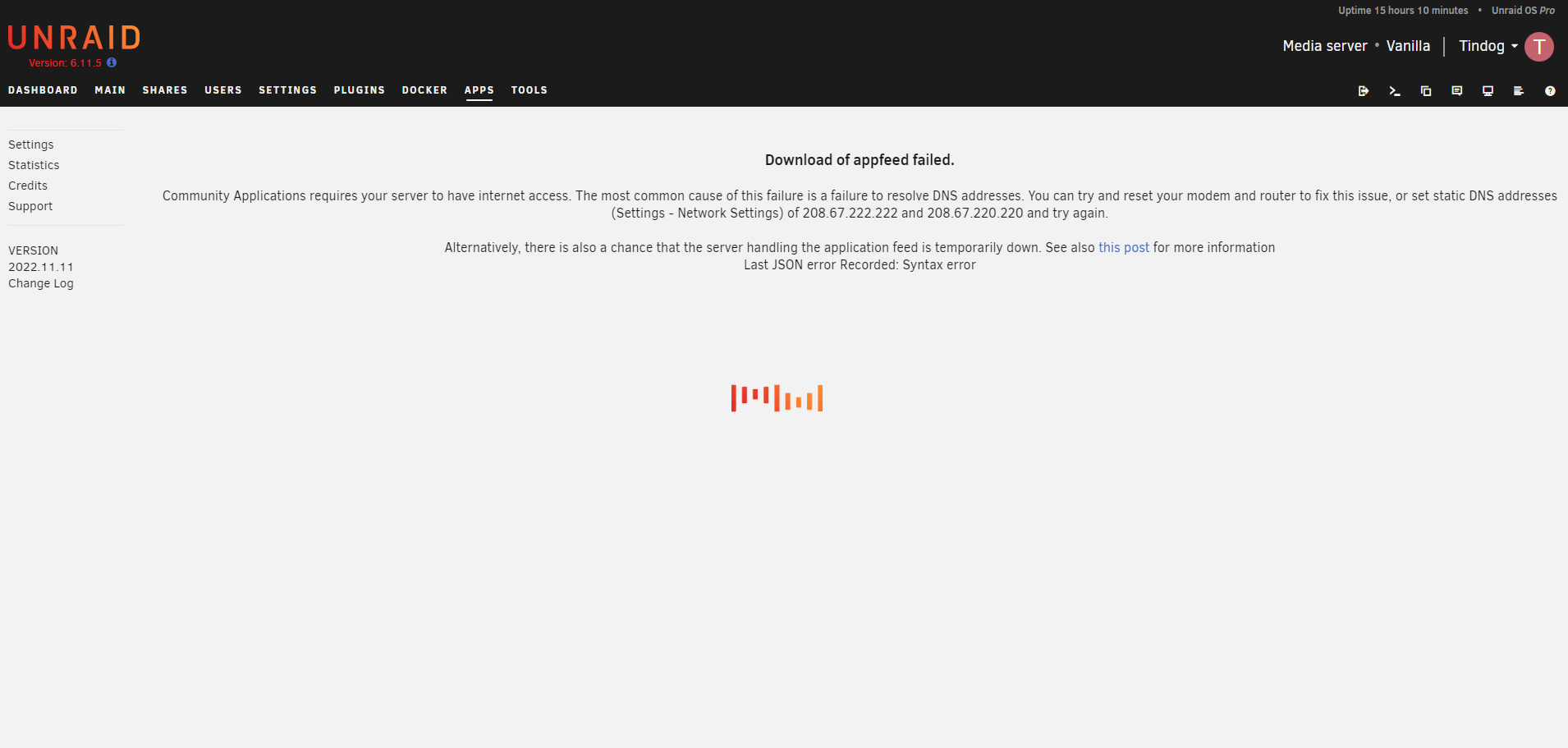

  6. I installed a 10gig card the other day but now my network is all messed up, and I can't seem to connect to update plugins or anything. I really don't know what I am doing, I only really want to use the 10gig network on 192.168.0.23 but the 1gig network card can't be removed from the system, and it doesn't look like I can disable it. Any help would be great because I can't download anything right now, but I have access to my home network on the server, just not the internet is what it is saying.
  7. After I updated to 6.11.3 everything says I have no network connectivity (even though I clearly do, as I can access it) plus I can access stuff from the internet to it, but "My servers" doesnt work, I can't update anymore it just errors out (I did backdate to 6.11.1 to see if it would fix it, but no change) I have no access to the apps store but my dockers work, but sometimes there Gui doesn't show up as an option. I have no idea what is going on. If I try to download anyting it says "Checking connectivity ... No response, aborting!" Any help would be great, if I need to reinstall the flash drive or something how do I do that, yet keep my settings, I am doing a rebuild on a disk right now, I had one fail and started one, so if you see that in diagnois that's why. However it's just a drive with data no appdata or anything on it. vanilla-diagnostics-20221122-2329.zip
