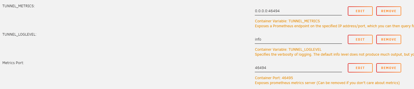

  4. Can anyone get the metrics working on a different port? I have two Cloudflare tunnels running and thus require the metrics endpoints to differ a bit. So I have 'Cloudflared-01' and 'Cloudflared-02' 01 - uses the default metrics port '46495' 02 - tried using '46494' with no luck. Nothing comes up when i call 192.168.1.100:46494/metrics but I hit the metrics endpoint just fine on 192.168.1.100:46495/metrics

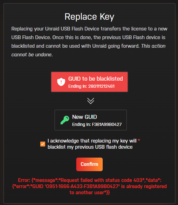

  7. Damn.... I guess this is one of them "contact support" cases... I will try with a free trial license until I can get my license transferred

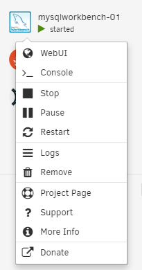

  11. I just noticed that I'm unable to edit newly created Docker containers. I have read from other posts that this is due to the XML configuration file in DockerMan not being available (\config\plugins\dockerMan\templates-user). So, I fetched a new Flash Backup from my Unraid instance and was unable to find the ...\mysqlworkbench-01.xml. I have also noticed that I'm unable to edit containers/VMs/shares, etc., like the USB has gone into a read-only mode. Because this has something to do with the USB stick, I think it's important to provide a little section about my recent changes that may have something to do with this issue: I have recently made some changes to the USB key because I had two instances with Unraid running. One with a Pro license and another with a Plus license. I now consolidated everything and decommissioned my former server running the Pro license. I now had the Pro license free and wanted to move it to the newly created consolidated instance. Due to the fact that the license key is locked to the USB, I moved everything from my Plus license USB stick running the newly consolidated instance into the former decommissioned USB stick with the Pro license available (licenses stayed in place on the USB sticks). This may be just a coincidence that I made this change yesterday and today when installing new Dockers experienced this issue.... but it's one hell of a coincidence then... So, my question is, any suggestions for a fix?

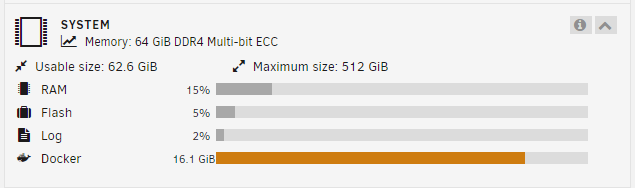

  12. What is this 'Docker' metric? Am I about to run out of something? I should have plenty ram but looks like this 'Docker' thing is not picking up on that.

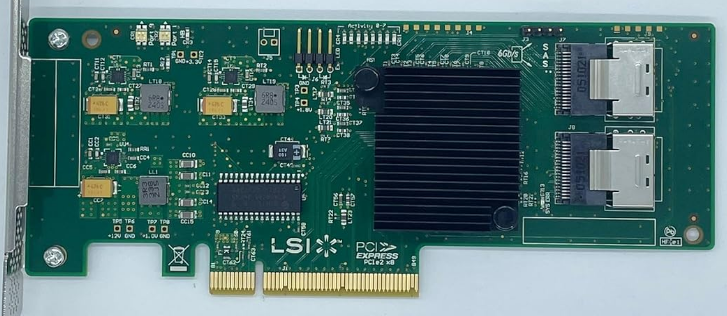

  15. That is now my conclusion as well. I have now tested with a controller I have working in my second Unraid server and that worked out just fine. Must be a compatibility issue with the 8P6G-PCIE-SATA-CARD from StarTech.com. I found an identical controller to the one I tested on Amazon that I just ordered. It was a "LSI 2008-8i" and listed on Amazon as "SXTAIGOOD LSI 9201-8i 9211-8i SAS2008 Chip 8-Port 6Gb/s PCI-e HBA SAS SATA RAID Controller Card 2*SFF-8087 SATA" I hope I may event get better speed as its an x8 instead of x4..

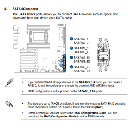

  16. Hello again Jorge It works when I plug the drives directly into SATA 6GB/s ports directly on the motherboard. Is that what you mean by onboard SATA controller? Plugged them into Ports 1,2,3 (page 1-12 in the manual - https://dlcdnets.asus.com/pub/ASUS/mb/Socket sTRX4/PRO_WS_WRX80E-SAGE_SE_WIFI_II/E21365_Pro_WS_WRX80E-SAGE_SE_WIFI_II_UM_WEB.pdf?model=Pro WS WRX80E-SAGE SE WIFI II) Its a quite bad solution for my build as the enclosure is a Fractal 7 XL with a storage configuration - its big, but not big enough for the Asus Pro WS to have any room for cables out the side without costing my HHD trays. .. well maybe I can force some cables that way, but it will be super tight. Besides, I have 9 drives more waiting to get added so I would still need to utilize the PCIe for connecting storage.
