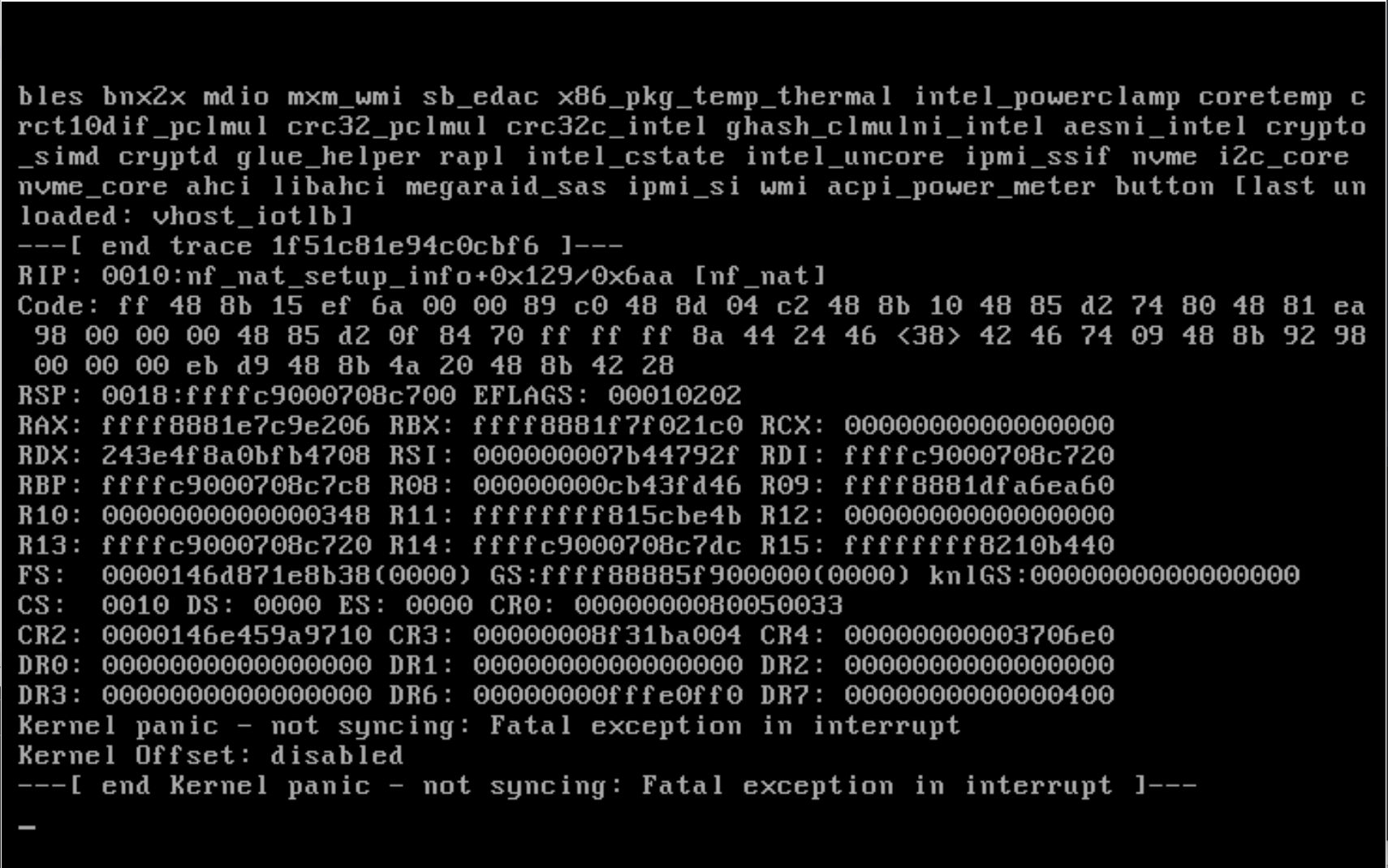

it looks like that talks about static ip. i think the only thing ive done before it started crashing related to networking was change 1 docker to host. the rest are all dhcp. but im not even sure if that was before or after the problems.but ill look into if its safe to upgrade unraid with zfs tools yet. how to i enable logs to save after reboot. loots like logs only start when it rebooted from crash so not sure if they stored anywhere else so i can see what happend.

i run zfs on unraid so wasnt sure if upgrading would affect it. but this is the 3rd crash this week like this. ill check those links out

would anyone be able to help me figure out whats going on. i thought it might be a memory problem but upgraded memory and still getting a crash. not sure where i would go to pull other logs if more info is needed.
