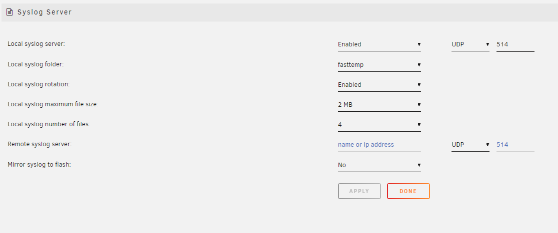

  1. I also enabled the syslog server by adding that IP which did work but I don't think that should have affected any crashes

  5. I added the mirror to flash setting as enabled, hopefully that will work out next time it crashes, should be in a couple days or so.
  6. Weird, I did previously enable syslog server but it doesn't write anything.

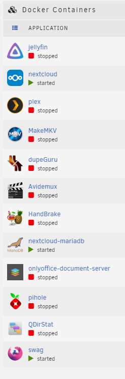

  7. Hello, hoping to get some help figuring out what is causing my system to crash repeatedly. Help is much appreciated in advance! I just ran the system in safe mode for 3 days only to find it hung in safe mode as well, I hoped it was just a plugin issue but appears not. The system seems to run great for 2-7 days, then it will completely freeze and only an unclean forced shut down will get it running again. I have my diagnostic logs attached, I read somewhere there is also a setting that needs to be enabled for deeper logging, is this correct? I hope there is enough info in these logs but I can change settings if needed. I have the system running in safe mode again with minimal docker containers running, only my critical 3 for running my nextcloud instance, that needs to have a near 100% uptime so this has been very problematic. Especially since nextcloud itself is buggy enough already. Below are the containers running at this time, this last attempt in safe mode all but Dupe and Qdir were running jpurdy647server-diagnostics-20220611-2257 (1).zip feedback_diagnostics_1654555508 (1).zip
