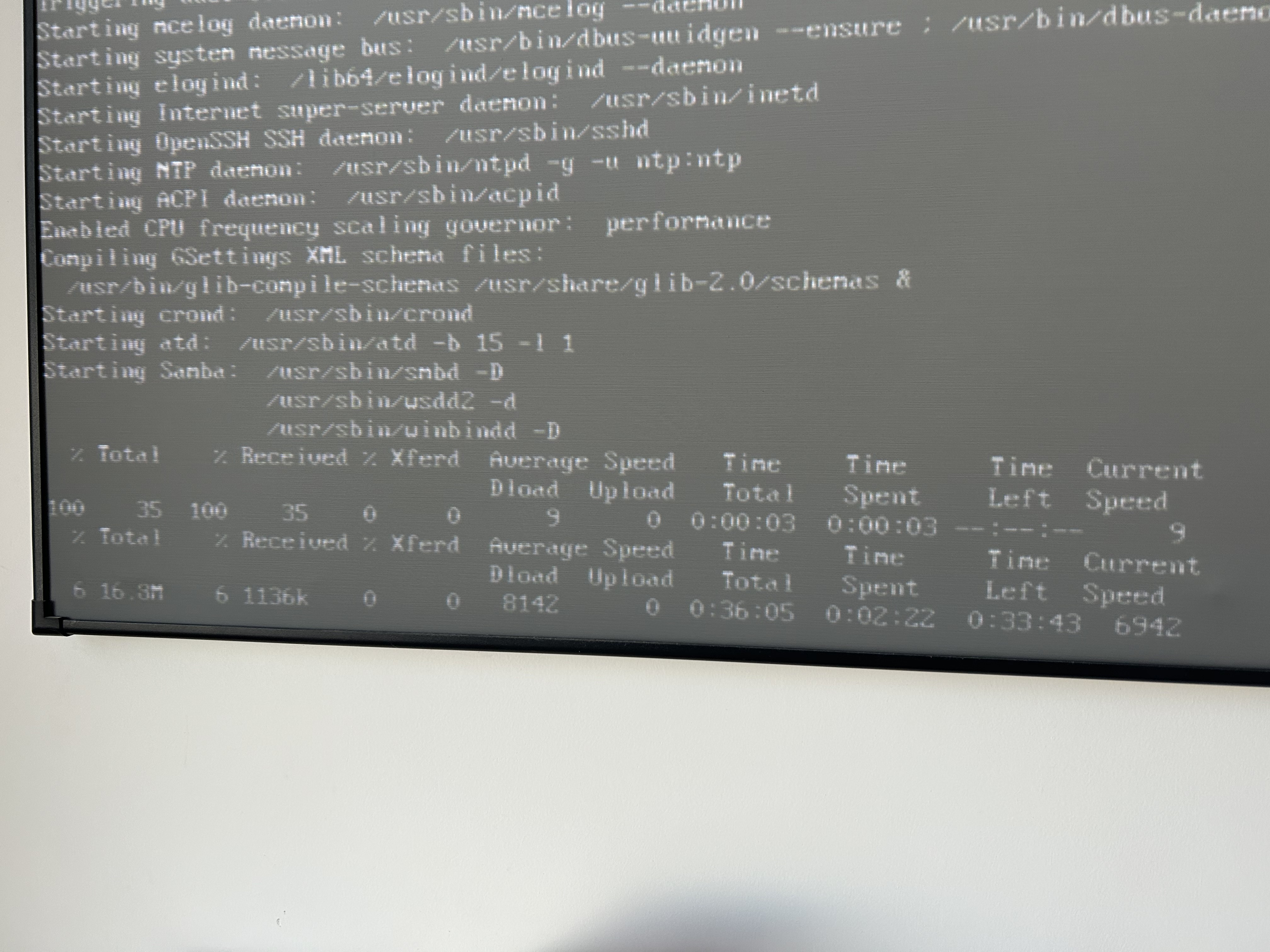

  2. 我之前遇到过这种类似的问题,好像也是卡在这个环节下载文件。后来发现是因为我安装了rclone,但是没有安装好,所以开机就下载这个插件。。。后来,重启好之后删掉插件就好了
  3. 正解,多谢,单独重装Dynamix File Manager插件不好使,然后又重装了语音就好了,大家也可试试单独重装语言是否可以

  10. The current system is 6.11.5. The system cannot be accessed after restarting, but ssh and wireguard can be used. After connecting to ssh, enter "/usr/local/sbin/emhttp&" to open the web, but it is in English. The language pack needs to be downloaded and installed again. I think it may be related to the USB flash drive, so I changed the USB flash drive, redo the system, and copy the config to cover it. The result is still the same. Connect TV and see the following figure. The system is downloading a 16.8M file. The speed is very slow, resulting in no access to the system. Who knows why?
  11. 目前系统6.11.5,重启后无法进入系统,可以ssh,连接后输入/usr/local/sbin/emhttp &就可以打开web了,但是是英文,需要重新下载语言包安装。 觉得可能与u盘有关,就换了u盘,重做系统,把config复制进去覆盖,结果问题依旧。连接投影仪看到下图,走到最后在下一个16.8M的文件,速度很慢,导致进不去系统,请问谁知道是怎么回事?
  12. 没有编辑过go文件,觉得可能u盘有损坏,之前似乎提示过一次,没注意看。今天换了个u盘,不过没试重启怎么样
  13. 今天在家里接投影仪上重启,发现了问题所在,后台一直卡在下载这个东西这里,速度太慢,不知道什么原因?
