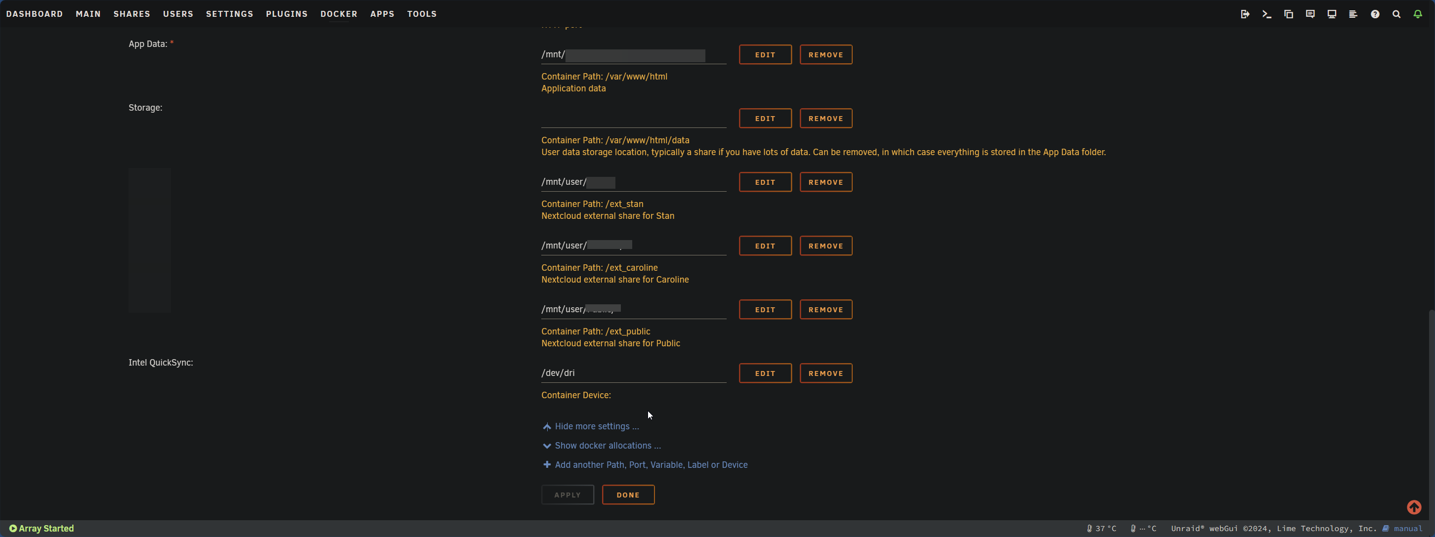

  3. No I haven't done anything other than run the command you provided earlier... When I Click show more there is nothing. The arow moves up as if to show more info but there's nothing there:

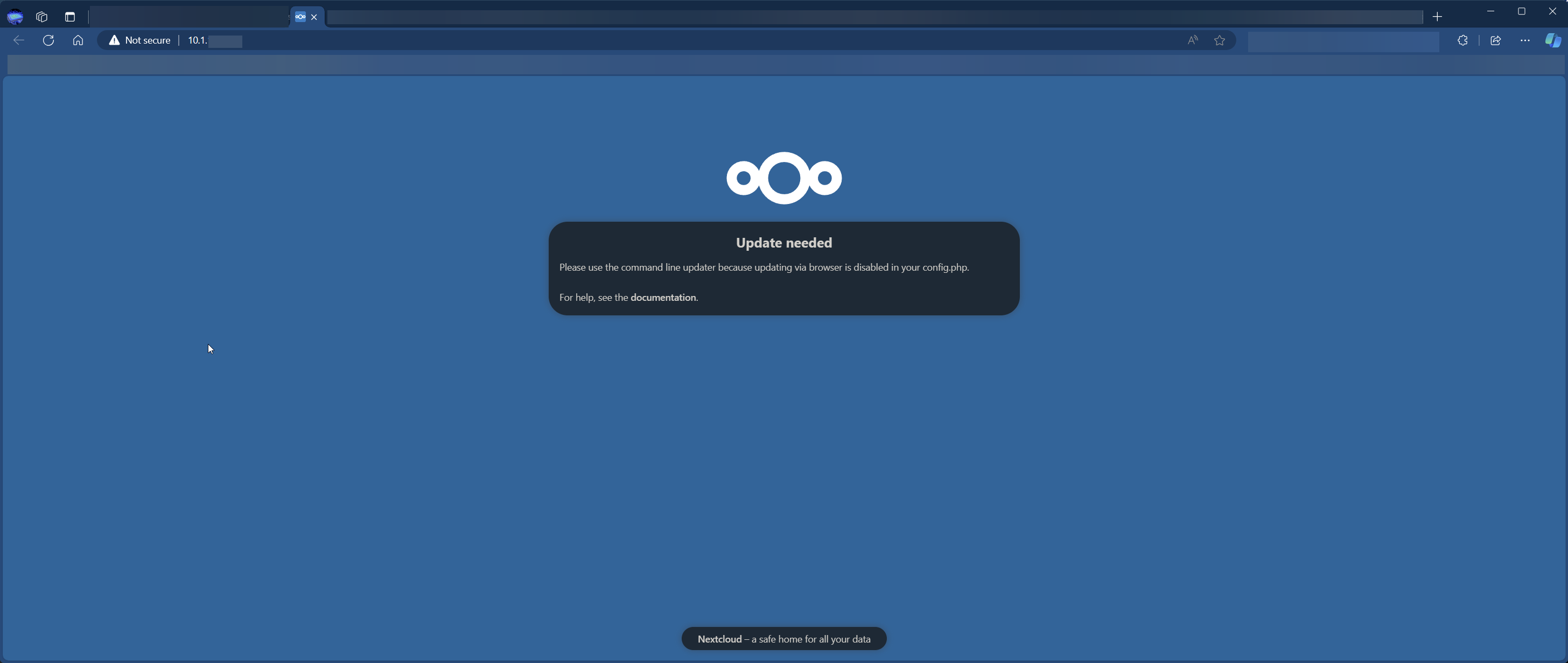

  4. Okay, I ran the command but now when I try to access I get this error: Configuration was not read or initialized correctly, not overwriting /var/www/html/config/config.php I tried changing permissions for everything in the /config folder to 777 but that does not work either. I restored a backup that was made from the CA appdata backup utility and ran the upgrade command again. After restarting the container, it appears the docker log is still complaining about user id 33. I have not done anything custom that I am aware of that would make the current user id what it is (99)? Initializing nextcloud 28.0.3.2 ... Upgrading nextcloud from 28.0.2.5 ... => Searching for scripts (*.sh) to run, located in the folder: /docker-entrypoint-hooks.d/pre-upgrade Console has to be executed with the user that owns the file config/config.php Current user id: 33 Owner id of config.php: 99 Try adding 'sudo -u #99' to the beginning of the command (without the single quotes)
  5. Should -u 33 be -u 99? When I run it, I get this: Console has to be executed with the user that owns the file config/config.php Current user id: 33 Owner id of config.php: 99
  6. So I ran into this when trying to access my instance today... and I can't make heads or tails on how to proceed. Unfortunately I'm not very good at translating stuff from other nexcloud variants (aio, etc). Trying to update via the unraid docker page shows everything is up to date.
