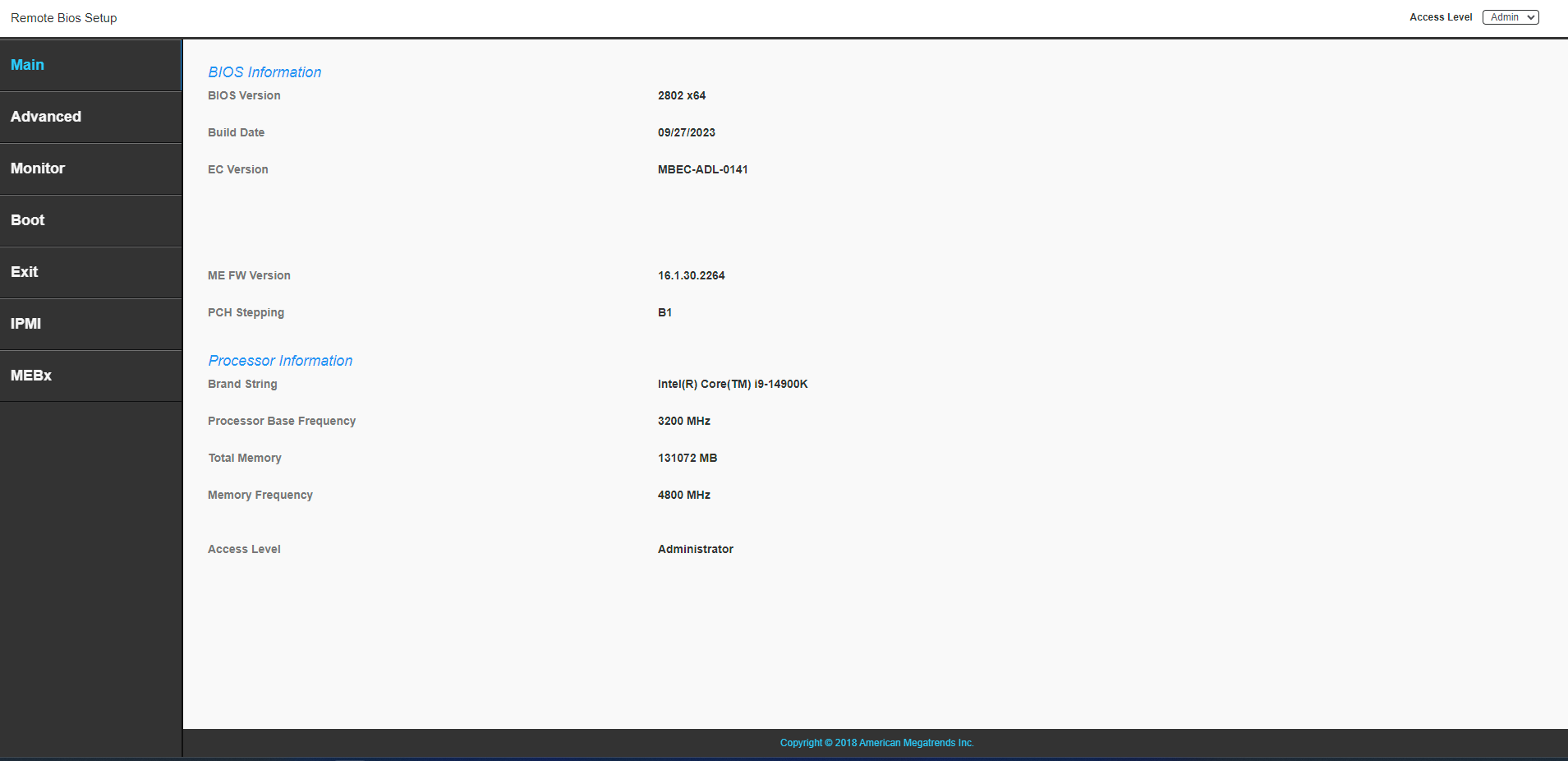

@SofcsoHow did you update the Intel ME version, last time i had to boot into bare-metal windows. Do you have another update method.
UnRAID on Asus Pro WS W680-ACE IPMI
@OmidDoes your HBA show up under the Advanced tab in the bios. Try the following (use the remote window of the IPMI software) for easy monitoring at reboot. Before "Save configuration and reboot" remove any connection to all the graphics cards, Let Unraid boot and plug in VGA to IMPI card after Unraid is started, this solved the iGPU issue for me.

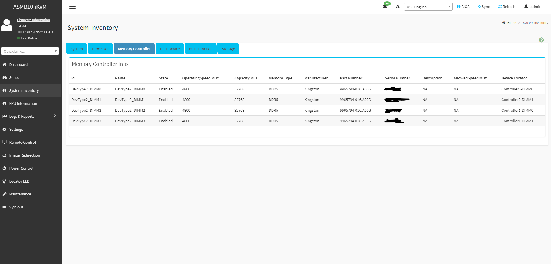

I run 4x32GB Kingston KSM48E40BD8KM-32HM on a WS W680-ACE IPMI, the board will sett the modules automatically to to 4200.
