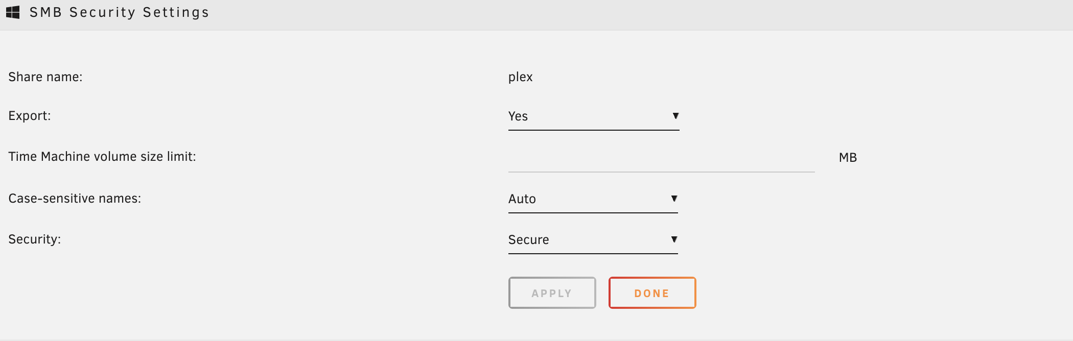

SMB Share not able to see to access from windows machine
Thank you Now I'm able to see
Hi I added a share 'plex' and tries to access from windows machine. But I don't see any directories named plex. netplex-diagnostics-20221008-1251.zip
