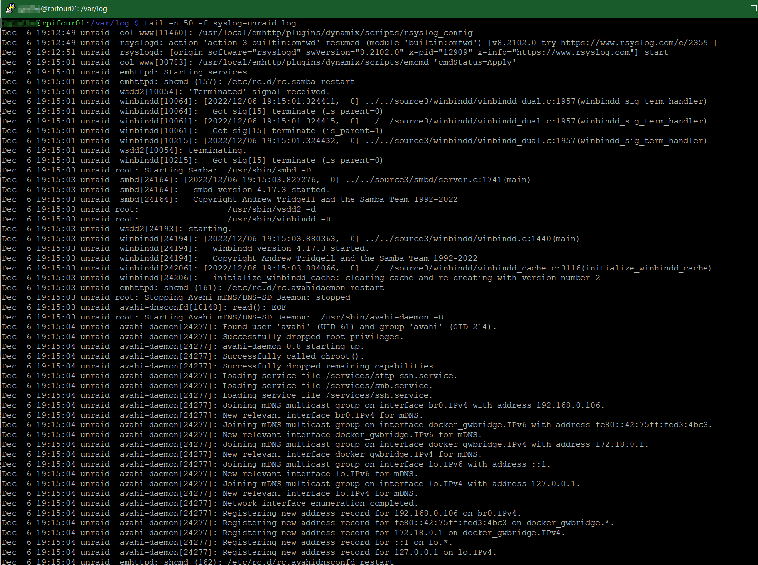

Okay, rsyslog is enabled and appears to be working. The parity rebuild also resulted in a hard crash. Now unraid is in "zombie" mode with VMs running and a stale configuration, parity check is progressing. But now we have a log 👯♀️The array shows as not started, but provides its services... anyway, lets see what the parity check will do.

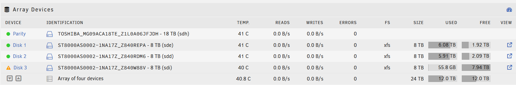

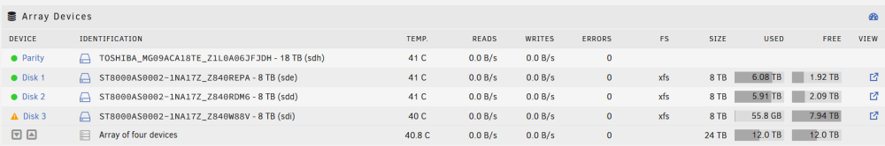

Hi there, this seems to be a GUI-related trap (bug???). I added a 4TB drive to my array, the parity disk is 18TB. It zeroed, I formatted it (with XFS) and everything was okay. No user data on it. Then I decided to up my SSD cache array (went fine) and to replace the disk with 8TB (and an additional fan for better air flow). System restarted, I replaced the disk in the array and the rebuild started. No pre-clearing, no formatting before. The information on unraid/main says 8TB free on this disk, everything fine. The process crashed reliably, twice. The whole system went unresponsive, no screen output, not reachable by network. The way out of this was to erase the disk (array not started) and start the array. Then it will be formatted, and afterwards the rebuild starts. This seems like a handling issue: Rebuild on a replaced disk with different size should only start after formatting. I'm running unraid version 6.11.3. with best regards rookie701010
