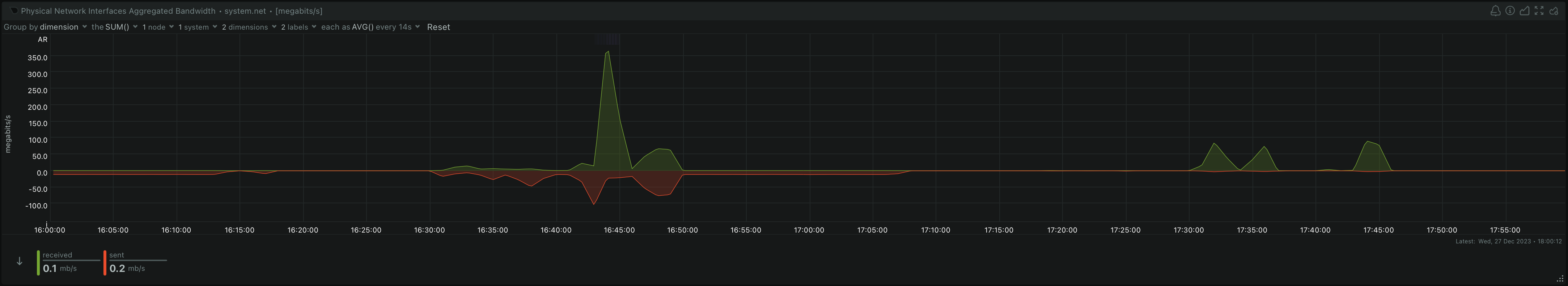

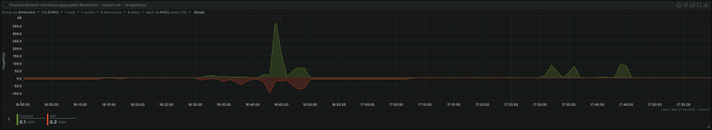

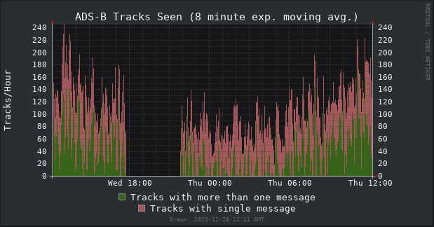

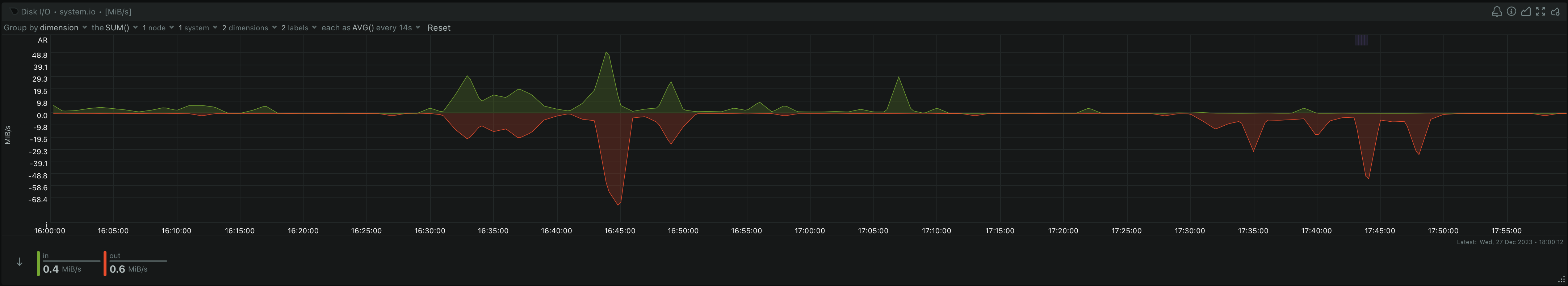

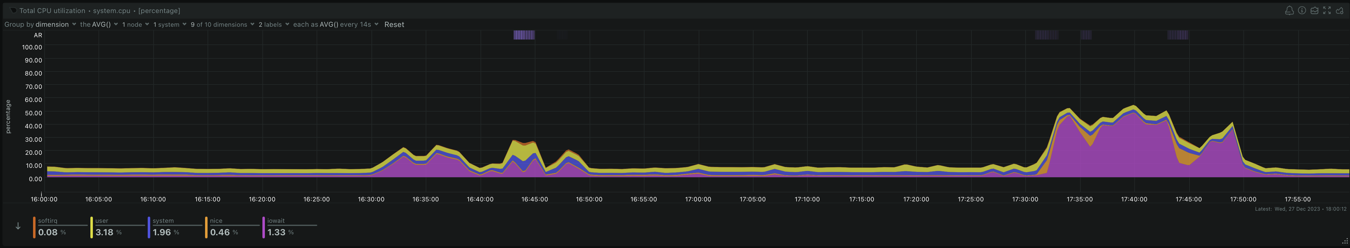

  5. Hi all, I've been facing a problem with my Unraid server for a while whereby a large file transfer to the server will somehow upset Docker and cause problems, including: The Docker portions of the webGUI become slow Attempts to stop, remove, or kill Docker containers fail with error messages along the lines of "attempted to kill container but did not receive a stop event from the container" This is regardless of whether I use the webGUI, the command line, or Compose Connections to Docker containers from elsewhere on the network fail. (particularly annoying) my ADS-B receiver Docker container stops working and needs to be manually restarted before it'll work again, even if the offending transfer has already finished. Examples of big transfers in that can cause this problem: A backup coming in to the server from offsite (through rsync directly on Unraid) Windows File History backing up to the server (through Unraid's built-in SMB server functionality) A large download through Lancache on the server (through the Lancache Docker container) You'll notice that the first two of those should have nothing to do with Docker. Frustratingly, the following do not cause the problem: A backup going offsite from the server (rsync again) Mac OS backing up through (a Time Machine Docker container) Media being served out to other devices (built-in SMB) Clearly, my server is running out of some resource that Docker needs, but I'm at a loss as to what it is. Despite the problem being associated with a lot of network traffic, I doubt it's bandwidth itself, since one of the triggers comes from offsite, and it's unlikely my 100Mb connection (less VPN overheads) is saturating the server's gigabit Ethernet. While the CPU does run up during problematic transfers, it doesn't seem to be totally overloaded, and there's bags and bags of free memory. Let's take as a specimen what happened yesterday evening and see what Netdata recorded: As you can see, the ADS-B receiver fell over sometime around 17:00. I believe this was triggered by Windows backing up to Unraid's SMB server. The CPU runs up a bit for about 20 minutes at 16:30, then a bit more an hour later, but it never goes above 60%: There's some disk IO at the same times: Nonetheless, we have all of the memory: And there's a network traffic spike, but nothing gigabit Ethernet shouldn't be able to handle: Can anyone suggest other metrics I should examine? Or is there a way to decrease the general niceness of the Docker daemon so it will just take a bigger share of what resources there are? Vital statistics: Unraid v6.12.6 Dell PowerEdge R720XD Diagnostics are attached

  8. I nearly forgot to do this: now at over two weeks with no crashes. I'm going to declare this fixed by switching to ipvlan.
  9. 10 days of uptime with ipvlan. Then again, I've been here before...
  10. *sigh* It died again overnight. Let's give the ipvlan thing a go.
  11. So I've just passed seven days with almost everything up on 6.12.4. I wonder if it was related to the macvlan changes, since I am using that for Docker with a parent interface that is a bridge. Does anyone know where I would have been expected to see the "macvlan call traces and crashes" referred to in the release notes if that was the cause of my crashes?
