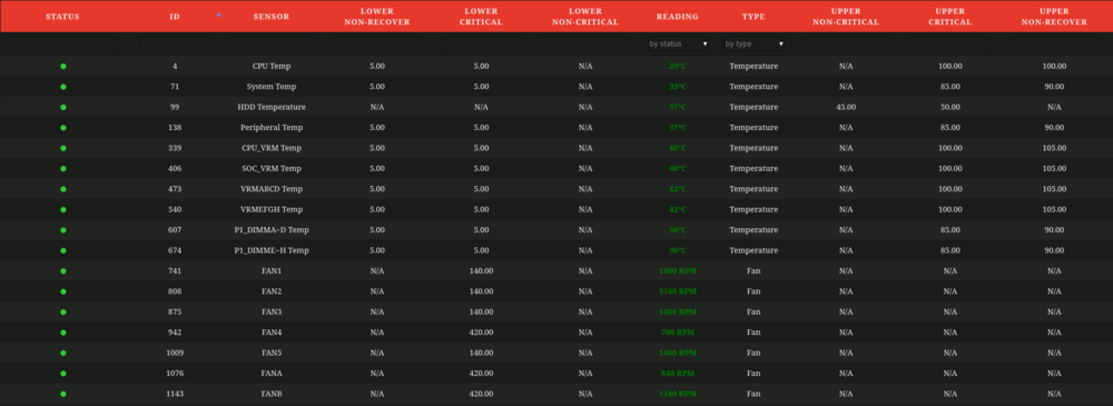

  1. Hi, first of all - I'm really sorry for not responding @DiscoverIt. I just forgot to answer your question because suddenly everything was working properly in my system. Maybe this will help you @SteelsFinest: What I did was installing the IPMI-Tools Plugin from the App-Store. After that I did a reset of the BMC and afterwards I configured the IPMI according to my preferences. E.g. the devices for polling temperatures and global sensors. Additionally I configured the "Fan Control"-Tab which is responsible for the FAN-Speeds. Somehow what I wasn't able to do manually was properly done by the IPMI-Tools plugin. After the polling time of e.g. 3 minutes, the fan speeds got adjusted and finally the speeds decreased. One important thing though: After IPMI-Tools plugin takes control of the fan speeds - do not manually override the fan speeds behavior using the BMC as this breaks the configuration of the IPMI-Tools plugin somehow. At least in my case. I hope this will help you in any way - unfortunately it was nothing more than trial and error for me - until its got working.

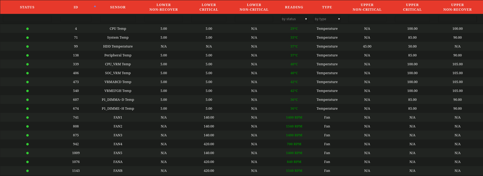

  2. Thanks for the reply! Is resetting with IPMITool the same as resetting to factory defaults via BMC/IPMI WebUI? If so, than I already did this several times, unfortunately without success. Afaik the LCT for the Noctuas are 280 RPM - this is at least the value to which the fans briefly jump by themselves. By default the LCT is set to 420 RPM with a hysteresis of 140 RPM in both directions. I don't know if there is a correlation between the LCT and hysteresis as 420 RPM - 140 RPM = 280 RPM. But this could also be just a coincidence. In the meantime I got an answer from the Supermicro Support: I don't want to disable these FANs as I want to remote-monitor them in case of failure or some other problem. What I already tried was: - Setting the LCT to 280 RPM and (just to test) to 140 RPM --> BMC still shows critical and ignores the value - Reset BMC (Reboot) - Reset BMC to factory defaults - FAN-Control using the IPMI-Plugin Another thing I noticed is that if I try to set the LCT using the ipmi-sensors-config (FreeIPMI using the IPMI plugin) it throws errors for most of the values saying the value is not allowed. But for some values it does work, e.g. 140 RPM. If I set the LCT via IPMI-Plugin Unraid WebUI using the "sensor config" I can set any value I want and its also shown in the WebUI. Therefore I tried setting the LCT values to 140 RPM (see image), and its seems to be recognized by the BMC but it just ignores it. And anayways the IPMI plugin sets the Fan Configuration to "Full Speed" which makes the LCT values irrelevant in that configuration.
  3. Thanks for your guide - appreciate it! I still have a problem with my setup, though - maybe you have an idea? I recently upgraded to a Supermicro H12SSL-I and connected various fans: - 1 x bequiet! Silent Wing 2 PWM - 2 x Noctua NF-A14 PWM - 1 x Noctua NF-F12 PWM - 1 x Noctua NF-A15 (CPU-Cooler) PWM - 3 x Fractal Design (incldued in the case, 3-PIN, so no PWM, I know I can't control them) I'm struggling with this configuration. I have the same problems you had: If I set the fan configuration to any other than "Full Speed" via BMC/IPMI Web UI, the fans decrease the speed as temperature is not high enough but the BMC increases the speeds again as the Lower Critical Threshold is set to 420 and the fans go down to 280 RPM by themselves. I installed the IPMI plugin and set the speeds and configuration accordingly. But it seems that this plugin just sets the fan configuration to "Full Speed". The fans are always on Full Speed with this plugin and it doesn't dial down the fans speeds. I did several Unit Resets via IPMI WebUI and also reset the system to factory defaults. Unfortunately no success. Also I tried to set the the LC Threshold to 280 or 140 - but the board seems to just ignore these manually set values. The new values are shown on the IPMI WebUI but the BMC still throws the "Critical" sign if the fan's speed is below 420 RPM. Do you have an idea what I could do?
