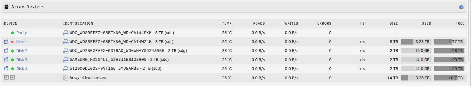

  18. @trurl Well, I just read the "Need help? Read me first!" link in your signature line. Lesson 1: Almost always, the most important thing you need to do is capture your complete syslog, BEFORE YOU REBOOT! We usually need to see what went wrong BEFORE the reboot, because once you reboot, it's lost! So, I've screwed up already....sigh.
  19. Thank you for such a prompt reply. The anonymized diagnostics are attached below. smg-nas-diagnostics-20260225-1053.zip
  20. Hello, I have an unRAID NAS that hasn't burped in 4 years...til today. I'm not super experienced at linux, and, per the unRAID documentation ("Single parity risks: If you have single parity, you're at risk of data loss if another drive fails during the upgrade. Seek advice in forums if this happens.") Now that I see the Disk 1 in the attached, I am seeking advice. The snapshot does NOT reflect that Disk 1 had 1024 read errors. I panicked when I saw the red X and powered down the NAS so I could do some reading, so the error count got zeroed. I then ran a short SMART self-test and got the following: "Completed without error" I am very willing to replace the drive that is shut down, but because of the above warning about single parity, I don't want to screw up the replacement. What should be my next step? Should I run an extended SMART self-test? Should I run a parity check? I have never had any errors in a parity check. The last one ran fine: Last check completed on Sat 31 Jan 2026 01:38 AM (twenty-five days ago) Duration: 17 hours, 29 minutes, 44 seconds. Average speed: 127.0 MB/s Finding 0 errors Thank you very much in advance from a noobie. ...Steve
